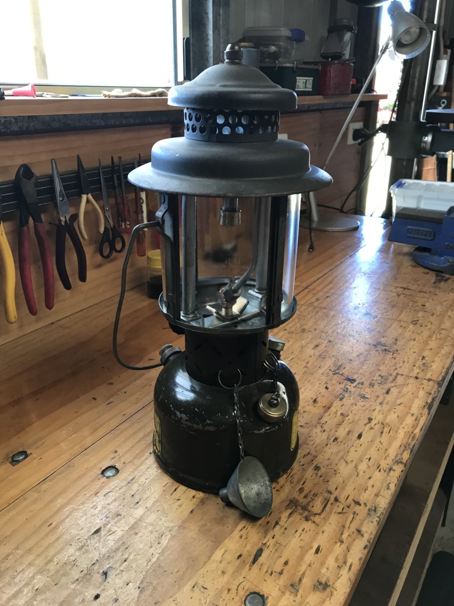

  7. AussiePete
    1,862
    @ColinG
    Just a thought .... the MilSpec lamp, and including the Colman 252A lantern version has an aluminium tube generator. Mine runs very well with no sign of any aluminium heat degradation to the aluminium generator.

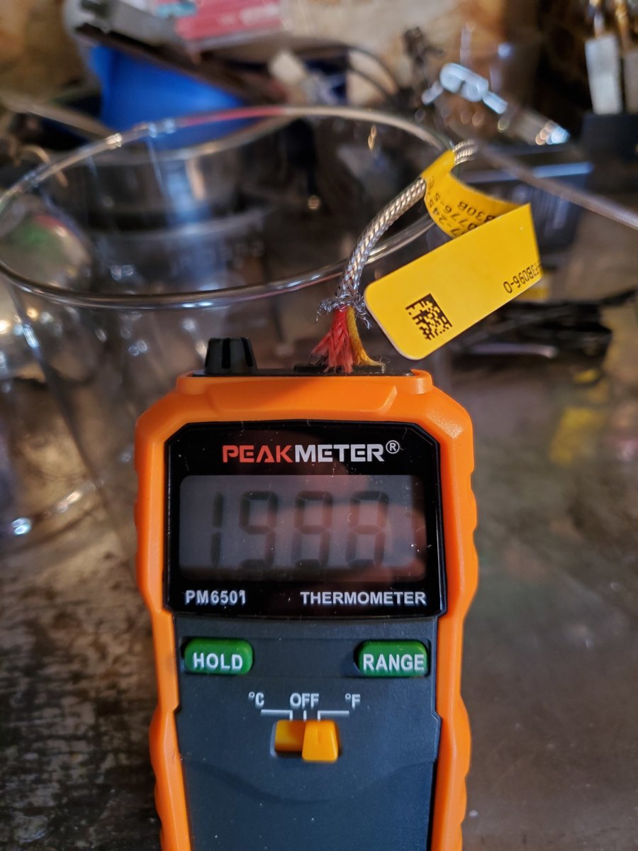

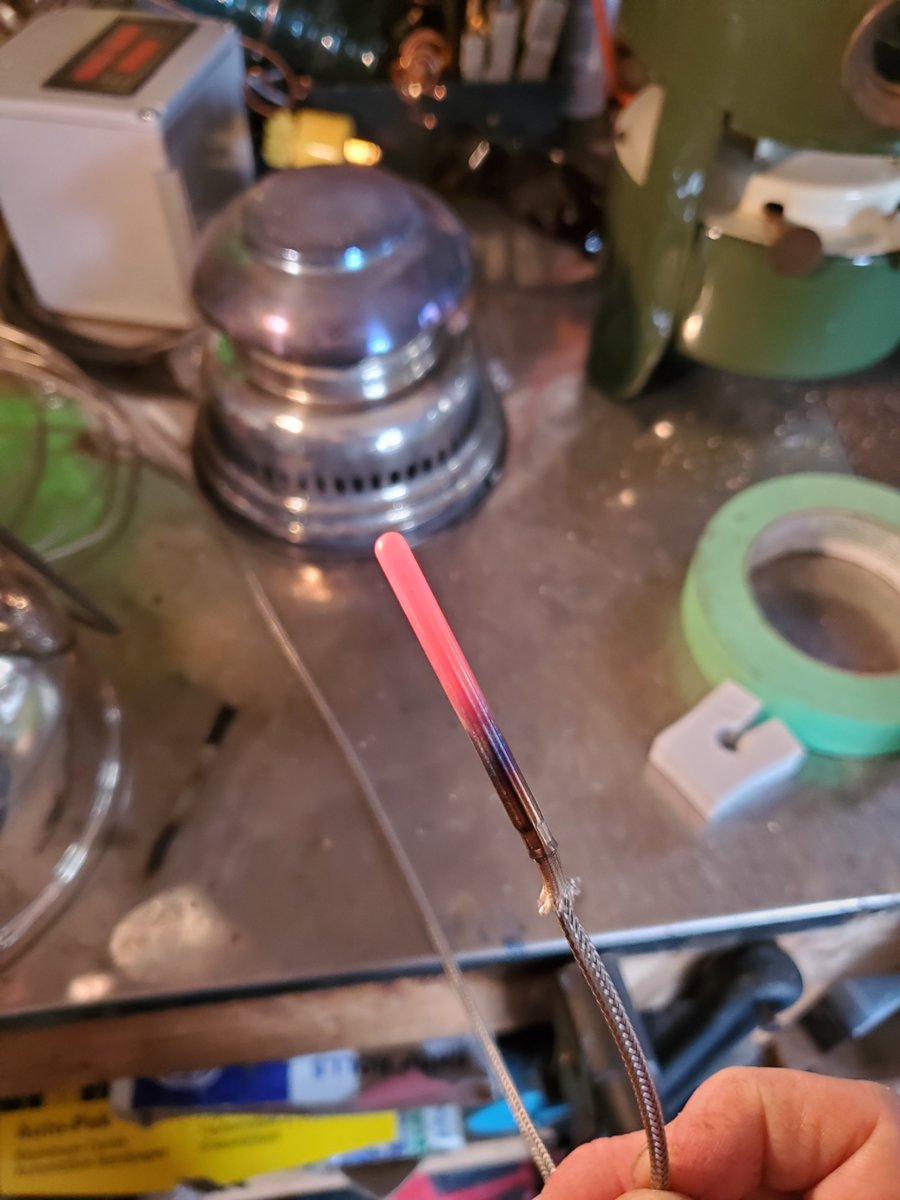

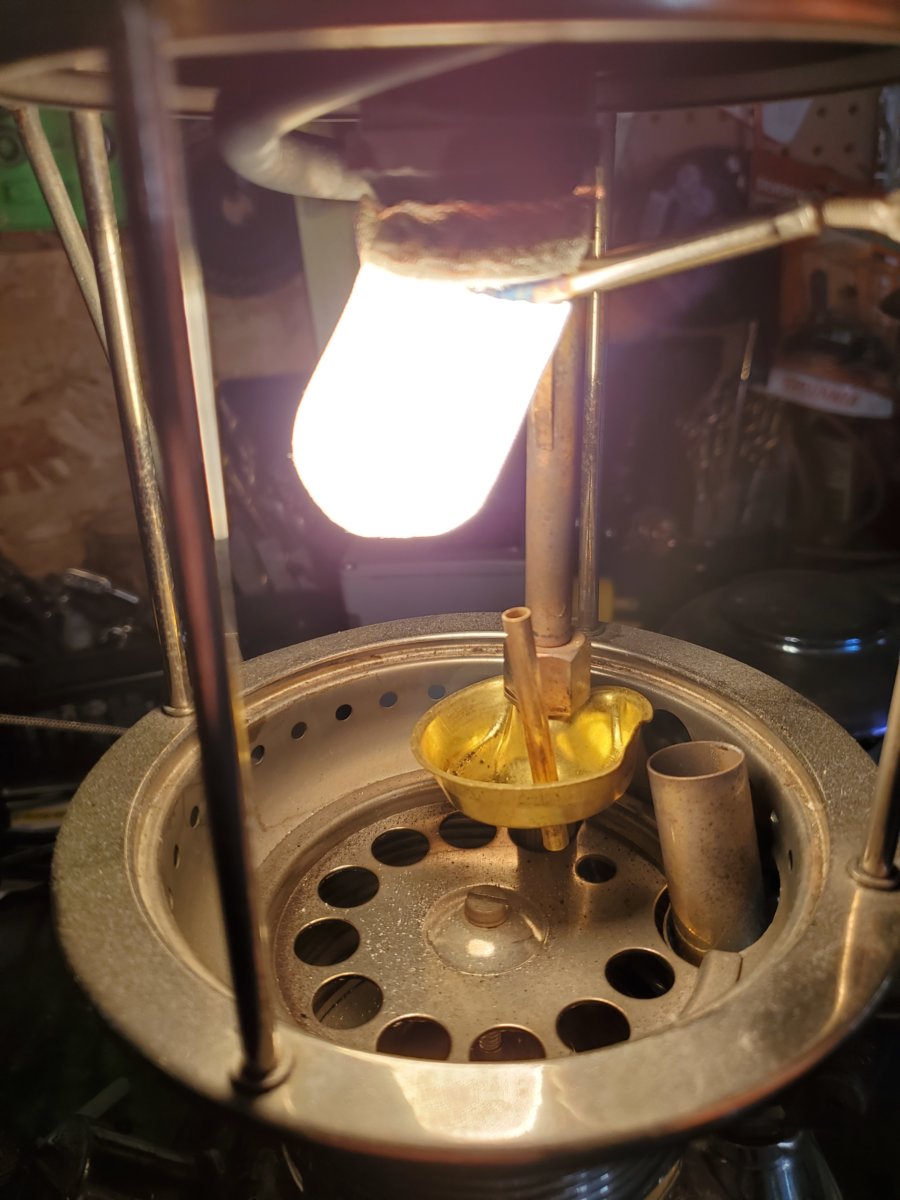

    Finally got around to measuring the mantle temp. Used a Petromax 829 that was warmed up for 20 minutes and the temp according to the thermocouple was 1988F. 20200124_101750.jpg 20200124_101832.jpg 20200124_101915.jpg

    What is the function of the copper tube in the preheat cup?

    Dendermonde, Belgium
    How many °C would that be?
  16. steerpike451
    Jun 29, 2016
    46
    Norfolk, UK.
    About 1085 C according to an online converter
  17. ColinG
    2,152
    1086 deg C is definitely hot enough to have melted the aluminium rod I originally used on the rebuilt Veritas Superb so it's a good job i asked!

    1,667
    That is the pre heater !
    It makes a nice flame which is the last part of the pre heating. The flame then ignites the light.
    You can even just see the small pipe recevoir the make the realy the last flame. The pipe is hollow and ha a hole just above the bottom of the cup, so it fills up.

  20. ColinG
    2,152
    The obvious question therefore, is how do the mantle holding bits (spigots?) not melt if the mantle burns at a temperature that melts brass?
    I'm probably just being dim!

    I wonder if it is a little under estimated. The thermocouple is a considerable size and will have lost heat by conduction/radiation.
    White hot is 1300C, 1080C is just in the orange range.
  22. AussiePete
    1,862
    @ColinG
    I’m thinking that the unburnt fuel/air mix keeps the brass bits cooler. The flame is below the burner head (that holds the mantle) consequently the heat is in the mantle, not in the burner manifold.

    Nice experiment. I'd guess that's fairly accurate. If you leave a brass tube inside the mantle, the zinc would vaporize first, leaving the copper to oxidize black. It might not melt the copper if its a large enough to conduct the heat away soon enough.
