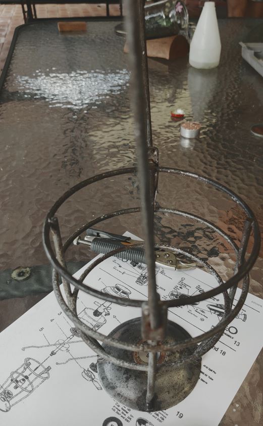

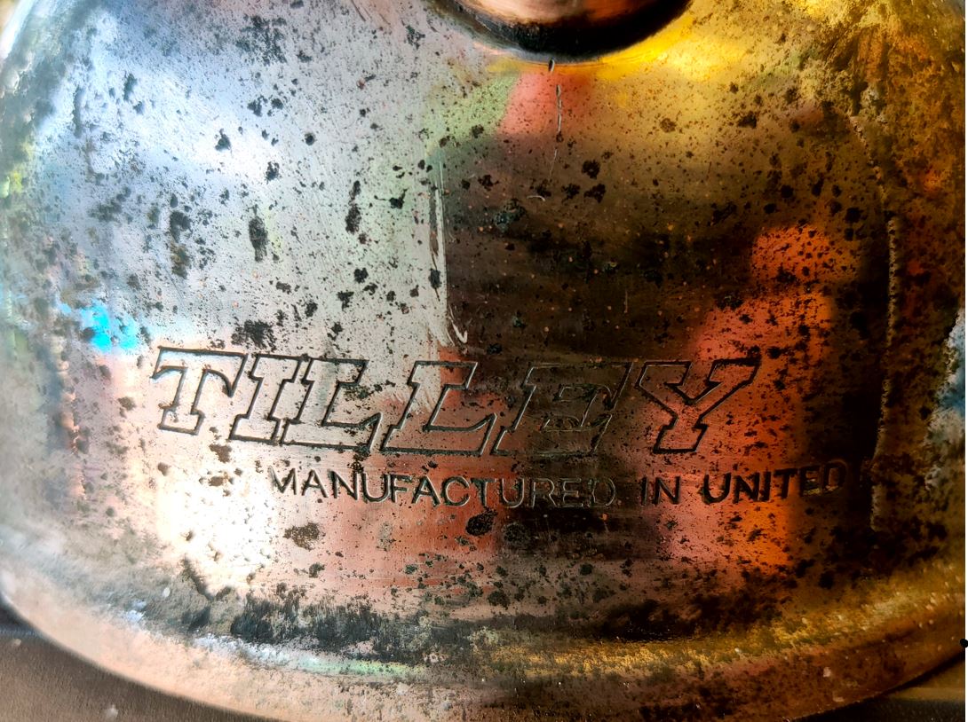

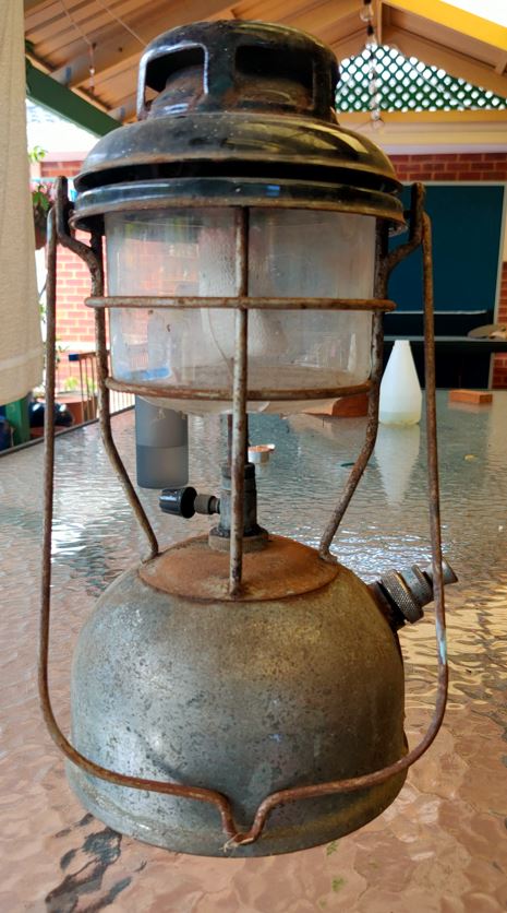

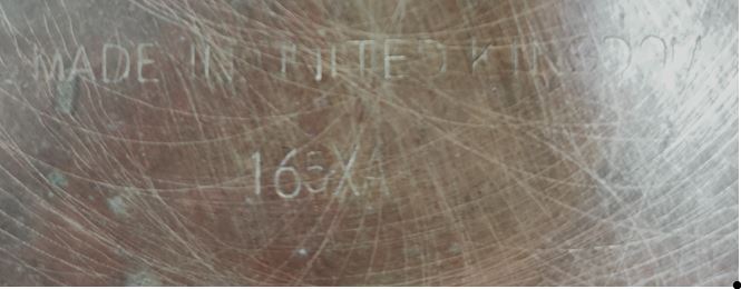

    Thanks to you guys I have worked out its a Tilley 246B made in Jan 1965 ?
    The base has a few little dents and very pitted through the plating.
    I am hoping to polish it and get running.
    As you can see the glass will need replacing.
    I am in Perth West Australia .
    I havent tried to fire it up yet. old tilley.JPG tilley name.JPG date.JPG shroud.JPG tilley name.JPG

    Welcome, Graeme.
  3. M.Meijer
    M.Meijer Subscriber
    565
    Netherlands
    Hello Graeme,
    Welkome to this site; indeed you have a X246B model. Irrespective of its experienced condition - which to me makes it more interesting especially if it had a known provenance - just give it a simpele clean and bring it back to working condition, with of without readilygiven advice from members when asked. Especially if this lamp belonged to someone dear to you it should be a special excersise: enjoy! Regards, Mike

    The 246b had two different types of seals in the non return valves (NRV). With a 1965 date it could be either. I would suggest before ordering seals, unscrew the NRV on the bottom of the pump and check if the seal is the earlier style, flat with a brass holder or the later one piece squared block (no brass holder). The other valve is located on the bottom of the control cock. All other seals are the same.

    I recently overhauled a 1970's X246B that was in worse condition than yours.
    for all the chrome I used Autosol marine grade chrome polish and was amazed at how well it all came up. areas that I thought were pitted through the chrome actually polished up very well including the frame. just goes to show how good British chrome was back in the day.

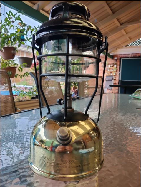

    Well the washer kit is ordered ( thank you @fettlebox )
  16. bonza Australia
    May 29, 2021
    62
    Victoria, Australia
    looks fantastic. good job
