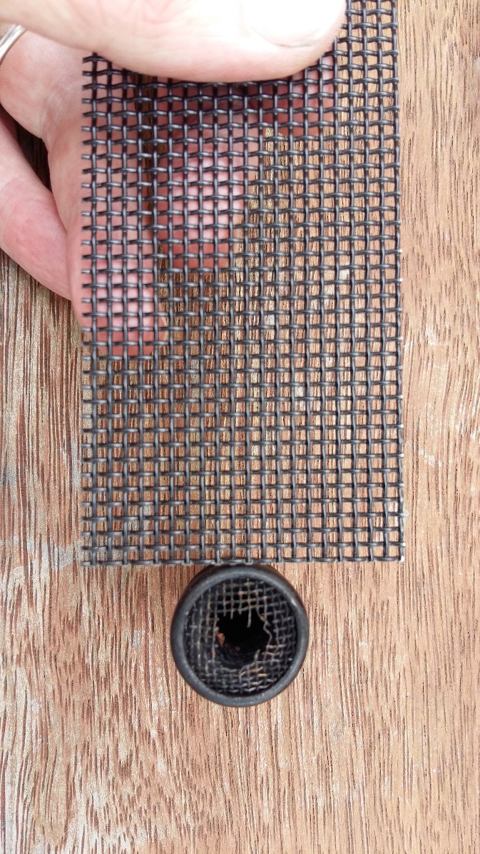

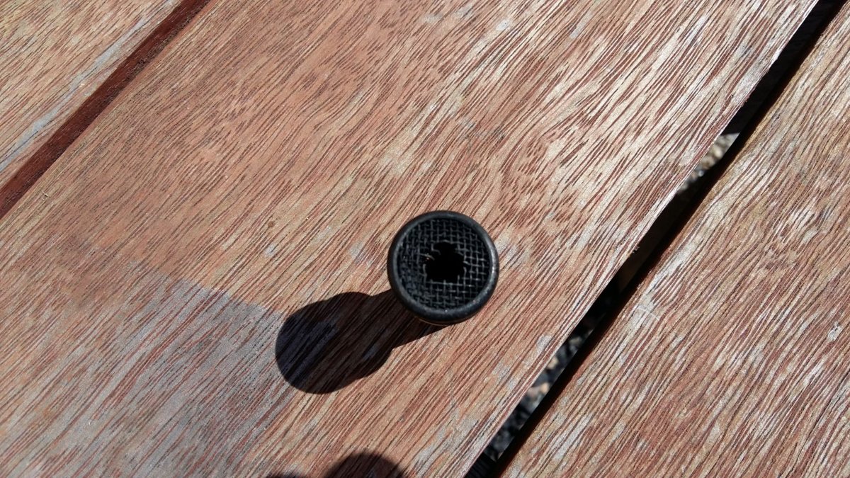

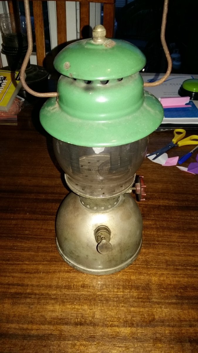

    Hi guys, another question re the fettle that I am doing on this Austramax. This is my first pressure lantern that I picked up by chance at an antique shop out west of Brisbane. I didn't even know what a pressure lantern was, and in fact have not seen one running in real life so this is exciting. I bought it because I already own and like wick-style kero lanterns.
    The burner as you can see in the picture has a rather large hole worn through it. I'm guessing this needs repair/replacement. When I spoke to the guys at oillamps (australian site) they said they only sell the different style of burner for the 3/300, ie, the one with drilled holes rather than mesh. The one I have is the mesh style burner. I've read on this forum that this mesh style burner is a two piece burner. Does that mean I can repair this? If so, how best to do that? Or should I just replace it with the newer style of burner that has the drilled holes rather than mesh??
    Thanks!

    It is the same design as the Coleman burner cap. Coleman used to sell loose replacement mesh disks for some of their burner caps. On yours, the retaining lip of the brass burner cap is intact so replacing the mesh will be sufficient. It may take a bit of experimentation to find the best grade of (stainless?) steel mesh that will not burn away when it gets hot. Cut a coin shaped piece of mesh with tin snips (sheet metal shears) and push it into place past the rim with your finger in the center. then use a wooden dowel or similar to push it flat through the tube so that the mesh seats well underneath the lip.

    Thanks Phil, to remove the existing mesh, is the retaining lip removable, so that you would remove that retaining lip first and then the mesh will pop out? Thanks.

    You do not need to do anything to the retaining lip. It is an integral part of the burner cap. Just pull out the old mesh with pliers. You are likely to damage the lip if you try to bend it open, and it is not necessary to do so in order to remove the old mesh and fit new mesh.

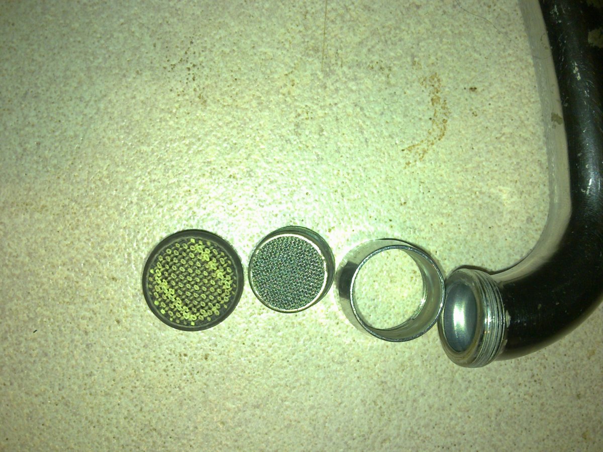

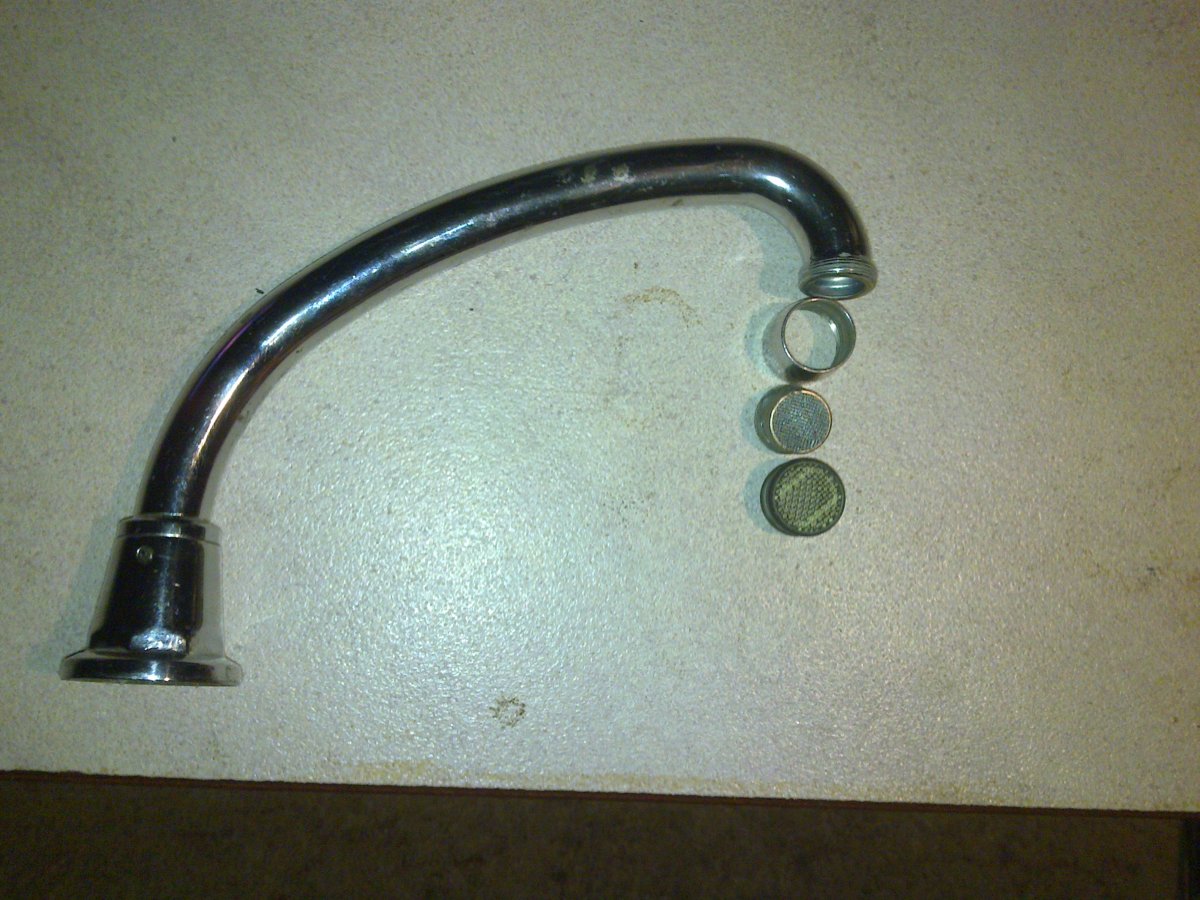

    Thought I might have found an answer for you but no, the mesh looks a bit fine and diameter too small unless they are available in other sizes. Might be worth checking plumbing supplies .
    Also thought of "termi mesh" but I think its finer still. The Austramax nozzle is the left hand in first pic.

    You will find that the mesh in taps etc is too fine and burns away in no time. It shouldn't be too hard to find some high temp stainless mesh of the right gauge.

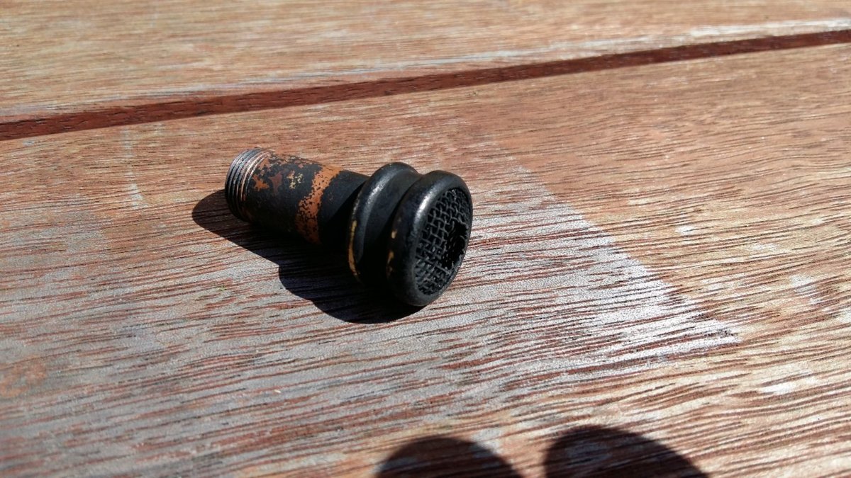

    Guys, by chance I picked up some stainless steel mesh but it is heavier than the original. Will this make a difference? Do you think it will work? I have held the new mesh up to the same height as the existing burner mesh for perspective.

    The only thing I can think of is if the mesh is too coarse, then there is a risk of underburn or burning back in the mixing tube. The only way to find out is to try it. Spares of the newer type are readily available.

    I think it'll be OK because some lanterns have a perforated plate rather than a mesh. I presume they work on the principle of the miner's lamp i.e. the mesh conducts heat away from the unburned vapour on the other side of the flame...

    I have been working on an Austramax and a previous owner had replaced the mesh with a much finer mesh (like you find in taps or pipe filters). It didn't work. When I fires it up on the bench without a mantle it only produced a fuel rich orange glow and wouldn't produce the blue flamelets (unfortunately I didn't get a picture). I think coarser would be better than a finer mesh.

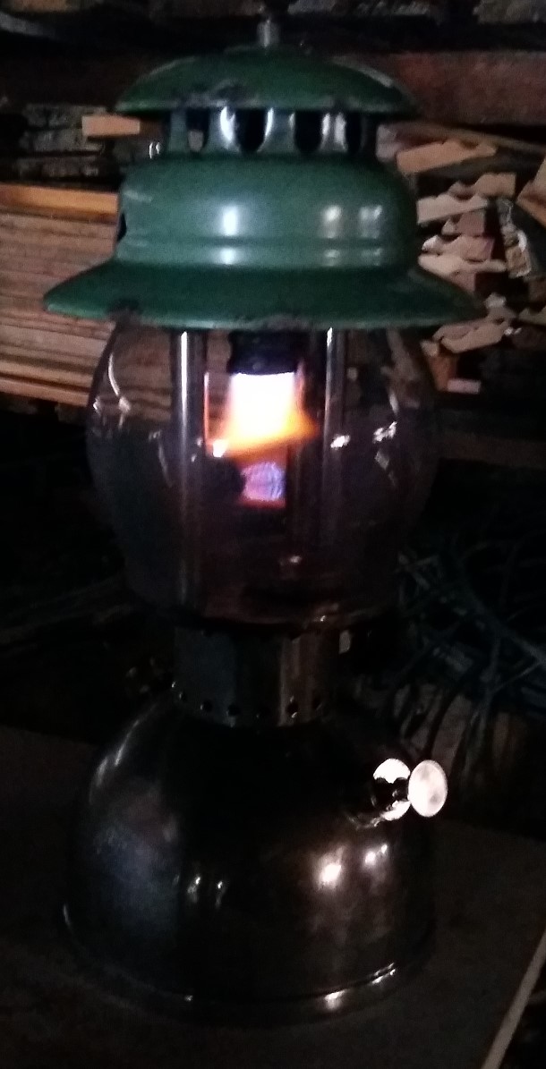

    OK this is super exciting now. I pressed the new mesh in and have reassembled the whole thing!! (aside from the handle)
    Here is where it got to, no mantle, first successful burn after me trying a couple of times without reading the instructions properly :evil:.
    What am I looking at here? Is this good, or bad? Do I need to go to finer burner mesh or is this what I should expect to see without a mantle?
    The glass is installed, so the circle of blue underneath the flame is a reflection of the little tiny blue flames poking out of the mesh.
    Thanks for your comments in advance.

    Looking with the naked eye, are those blur flamelets about 1/8th to 1/4" long?
    I would try a mantle (but I've got plenty of "test" mantles).

    I didn't pay too much attention when I had it fired up but I think they had to be at least 2-3mm so close on 1/8th".
    Thinking next step is to try a mantle and see how we go, but it is looking pretty good to me 8]

    I think you're looking good.
    "Test" mantles are cheap ones that I've picked up over the years that I don't mind getting damaged. I use them when I first light a lantern.

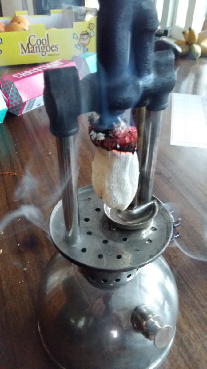

    OK, mantle initial burn done. First pressure lantern. Finding my way as I go 8]

    So, it burned and kept on burning after the metho went away, but then it kind of went dim and the sound changed at the same time... and it stayed dim - the sound got like more gas was coming through but the was dimmer and there was yellow flame blasting out underneath the centre of the mantle. Any ideas on what is wrong? Is the mesh on my burner letting too much through once it is warmed up maybe?

    Did you let it get hot enough before pumping more pressure? Is the jet screwed in tight enough so that it does not leak when the generator gets hot? (dont't tighten it so much that it breaks off, though). Yellow flame tends to mean too much fuel and/or too little air. Or too little pre-heat and liquid fuel coming out the jet. Not likely to be the mesh. A back-burn into the burner tube would make a louder throaty raspy sound.

    G'day @Pauly , my money is on not enough heat. Having said that Phil has given some good points to also check.
    A bad start can leave soot in the jet so make sure the jet is clear and try preheating twice.
