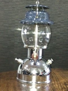

    This is a complete 3/300 including box and instructions. The appliance was black with soot when I received it in the mail. The fount was full to capacity with kero. Maybe it was used once and then discarded to a shed as the result of a beginners first pre heat not being effective causing a flare up. It cleaned up like new and works beautifully.

    Nice looking lamp. What sort of handle does it have? The newer angular style or the older round type.

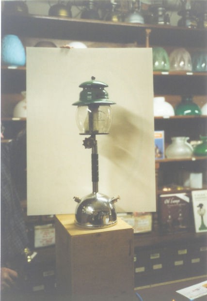

    I once saw a photo of what was called an Austramax table lantern, it had a handle in between the tank and the globe cage, but I have never seen any paperwork for it.
    So was it a production model or a cobbled lamp? Jeff.

    Nils, The handle is the round one, however the appliance has a newer style of hood, the one with the four holes around the rim for the handle. As pictured it is a blue hood with white speckles. Any idea of its age?

    Hello Nils, thanks for posting that advert, at least we now know that it is an Austramax product.
    Jim Dick sent the photo of the lamp to me, but it was a mate of his who owned the lamp..
    His mate had a shop, but I do not recall his name.
    The photo shows the lamp, Jeff.

    Jeff, The shop looks like (from the photo) TW Sands in Carlton Victoria. Thanks for the photo, I did not know about the Austramax table lamp model. I wil keep my eyes peeled to see if I can find one.

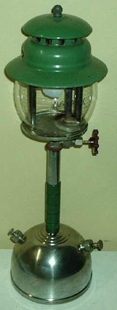

  14. Mackburner
    6,445
    I have this image of the table lamp from Albert White and my information indicates that he owned it at the time. ::Neil::
  15. David Shouksmith
    8,074
    Well, whoever it was didn't stay up all night designing that, did he... :lol:
    Get a lantern and stick a stem between the tank and the top, et voila a table lamp! :whistle:
  16. Nils Stephenson
    2,791
    Very interesting to see that picture. It shows that the tank is different to the one on the lantern. The fuel feed on the lantern is to one side and the lamp has a central feed with some extra fancy ridges as well. The valve block at the top of the stem must be different as well to align things again.
    So now we know of two.

  18. David Shouksmith
    8,074
    Looks offset to one side to me, just like the lantern...
  19. Nils Stephenson
    2,791
    The actual burner is straight off the lantern, i.e. offset. This would normally attach to a valve block attached directly to the tank in the same offset position. Here the stem is mounted cetrally indicating a central hole for the fuel feed. The block at the top of the stem then 'returns' the fuel feed back to the offset position.

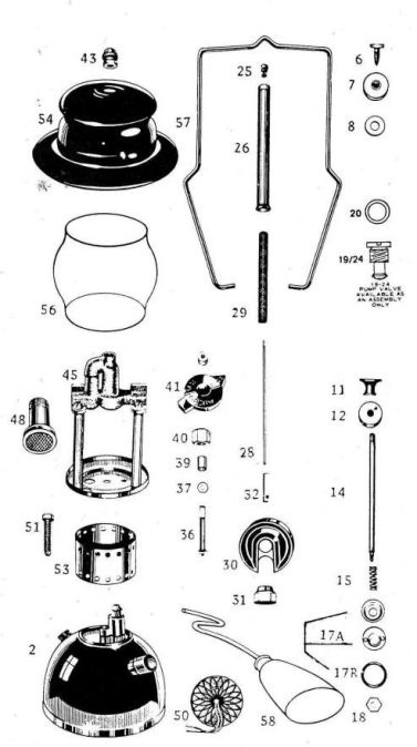

    Hi Tonebone, I was wondering if you've ever had to change a broken clearing pin or full generator ? I have one just like the one you're picturing, it did have the mottled vent, white specks on ash blue but I ruined that unfortunately by leaving it too long in mild citric solution. It's down to the steel now and I've to get it re-enamelled, ready for when ever I can actually find out how to remove the generators clearing pin. It's locked in, well I'm presuming there's eccentric block in there, with a sky hook fastening the upturn to the base of the clearing pin ? I've been searching for a solution for a long time, I really want to see it lit but all my efforts have come to nothing. I've asked Neil McRae and even he doesn't seem to know, & I've contacted TW Sands in Oz and they want me to near enough buy a new lamp, they wont tell me how to free it, nor which serial model n.o the full replacement generator is ? I hope you could possibly help me, thank you for listening if you get to read this ? I've not been with the forum for long, so don't know all the do's & don'ts.If you'd like I could try to take some pictures of the offending unit, on top of the fount > Regards Jonathan. :cry:
  21. Tony Press
    7,432
    Does this parts diagram help?
  22. jonathan fairbank
    Jul 17, 2013
    238
    Cheers Tony, I got the mail post, I've tried the best I can to list the parts I require for the Max, I hope there's no difference with the parts, as I mentioned my lantern is the older 3/300 one with the barrel globe and rounder bail arm. The vent was mottled white speck, over ash blue, originally. (Maybe early 80's, any ideas or ways to clarify its age, would be well received, also. Thanks, & a big hand shake, too ya. Jon :whistle: .
  23. Tony Press
    7,432
    I've PT'd you, and have spoken to the supplier. I can source all the parts you need - so I will work through the diagram and catalogue with you via the Private Topic forum.
