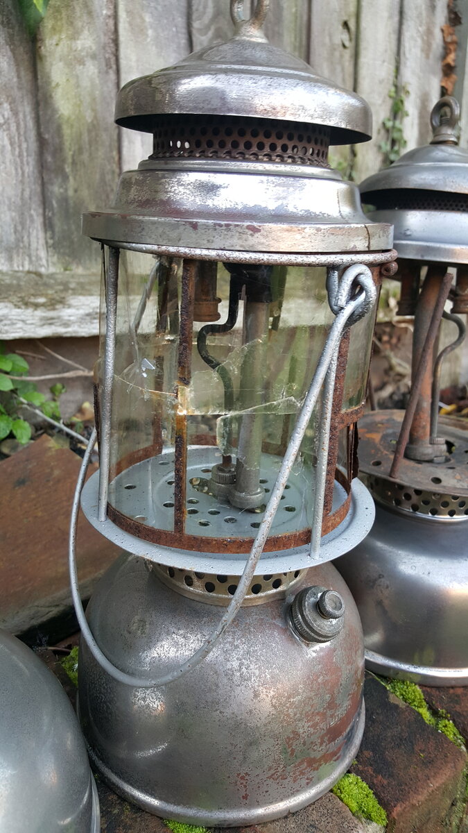

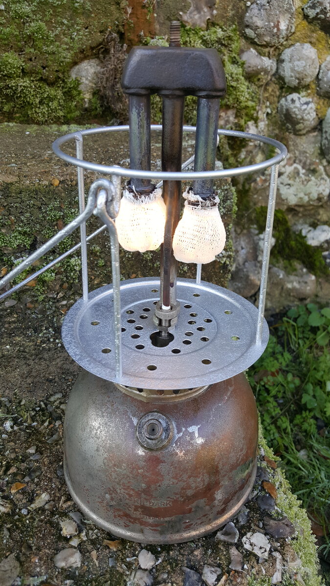

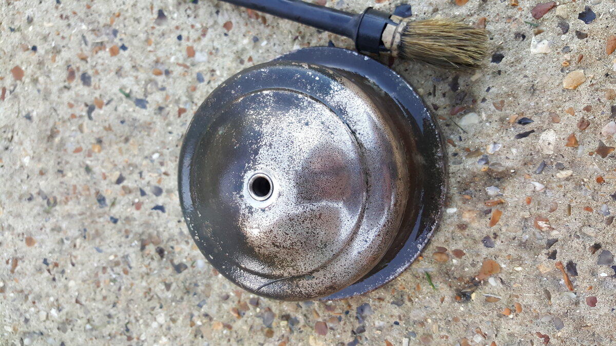

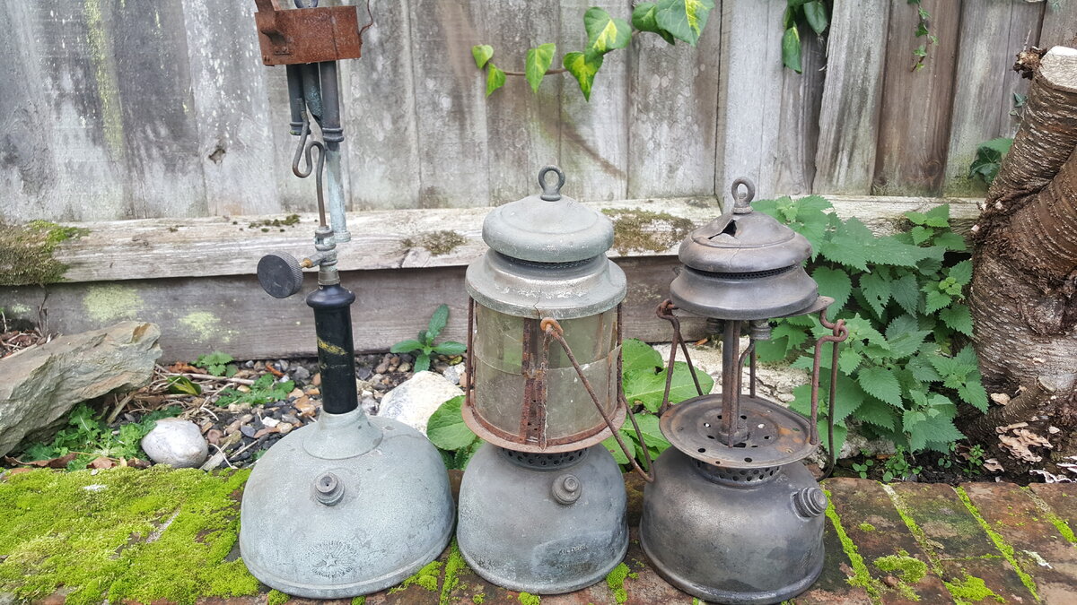

    I thought I would post about cleaning nickel plated parts using cider vinegar.
    The lamps I selected were probably not the best choice for such a demonstration delivering not so photogenic results but I decided I would upload them anyway in case someone found them interesting.

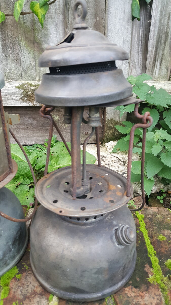

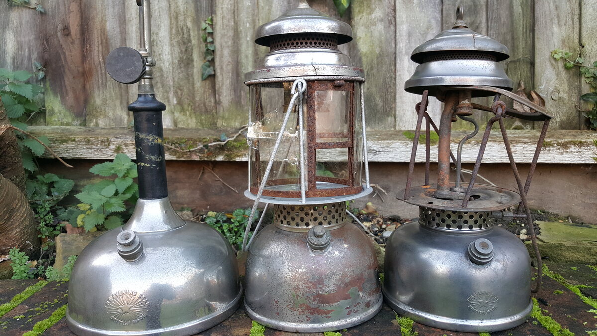

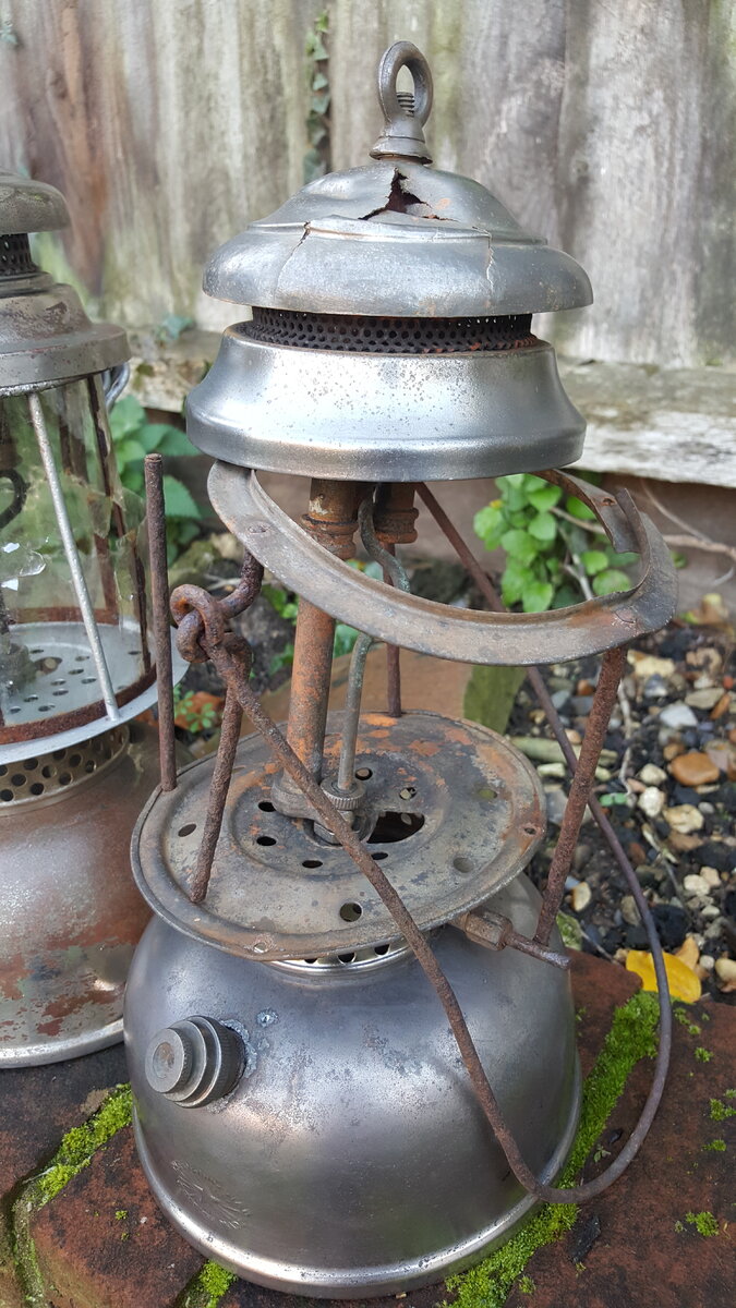

    From the stable of Curtis and Harvey we have the good, the bad and the ugly in the form of an evening star table lamp, a kildark lantern and a completely dead pre 1926 evening star lantern which appears to have been in a fire.
    I used quite a weak mix to reduce the risk of anything going pink. The ratio was 3 kettles of boiling water (It soon gets cold) to 6 good glugs of cider vinegar.
    Parts are immersed for 5 minutes or so then fished out and given a brush to assess what is going on.
    Any sign of anything going pink it's straight into a bucket of water along with anything that has had the crud brushed off.
    Once dried parts often look similar to how they started, the next step is a brush with a soft brass wire brush to remove stubborn deposits which should now be a lot easier for having a wash.
    The final step is a quick buff with metal polish, I use autosol but other brands are available.
    20221111_135636.jpg 20221111_135644.jpg 20221111_135652.jpg 20221111_135704.jpg 20221112_145635.jpg 20221112_153304.jpg 20221114_141358.jpg 20221114_135150.jpg

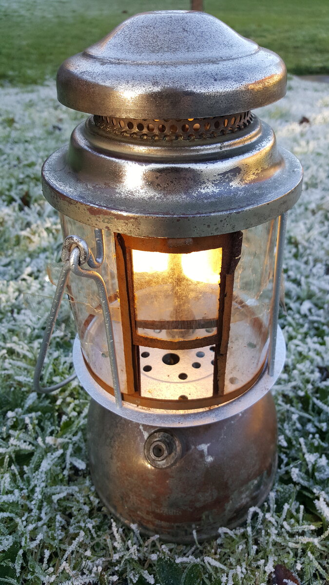

  2. James K
    Nov 10, 2017
    583

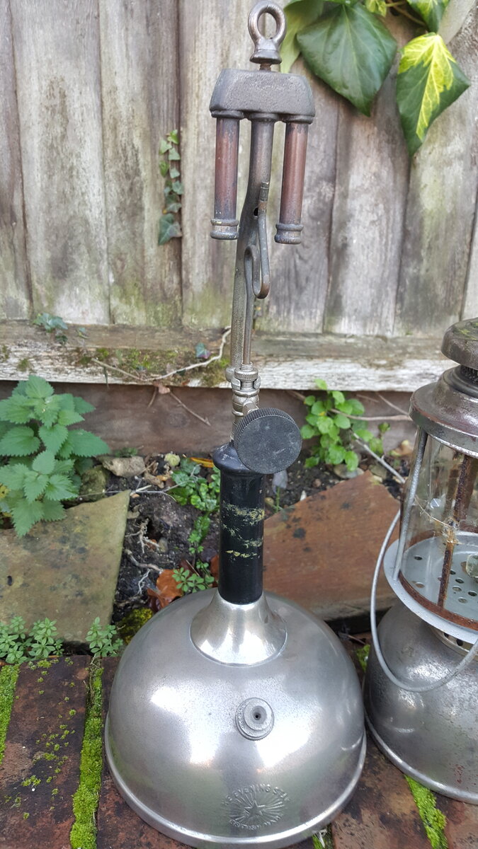

    The plating on the kildark tank was quite bad so for the after pics i fitted an identical cage from another evening star lantern. On the plus side it did seem to be a low hours lamp.
    The top and bottom halfs of the evening star lantern being cleaned were only attached to each other by the handle.
    Anyway here are the after pics.
    20221114_140947.jpg 20221114_140954.jpg 20221114_141006.jpg 20221114_141022.jpg

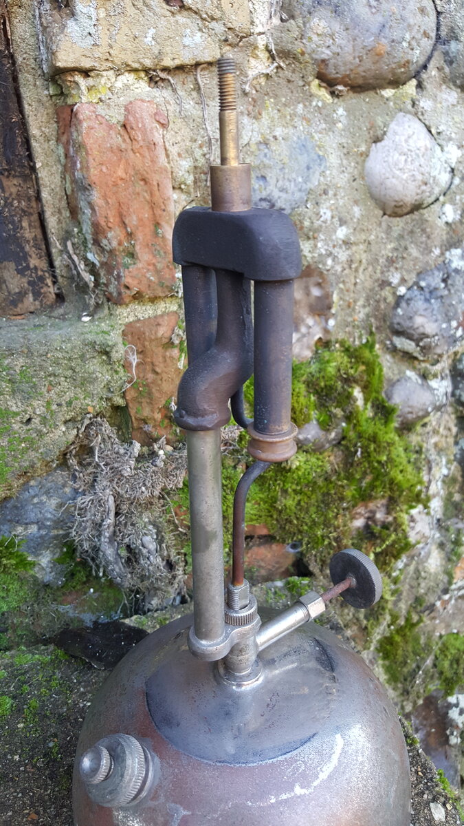

  12. James K
    Nov 10, 2017
    583

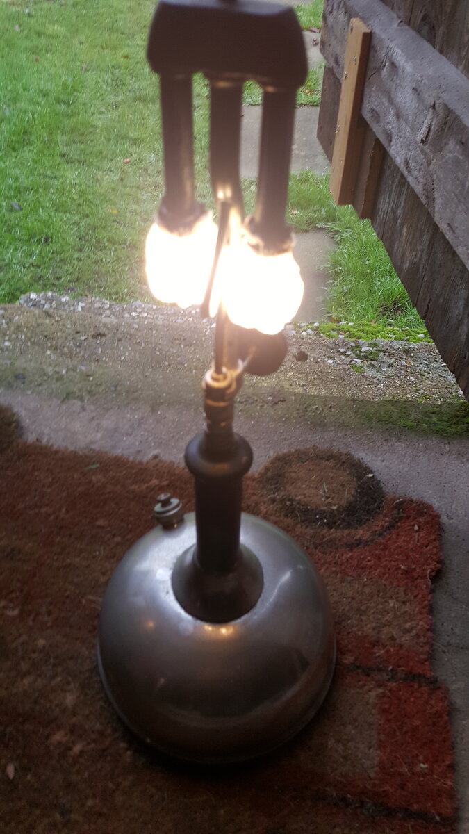

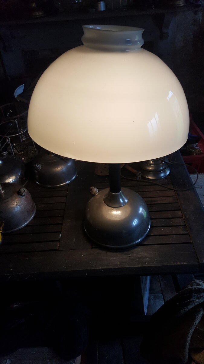

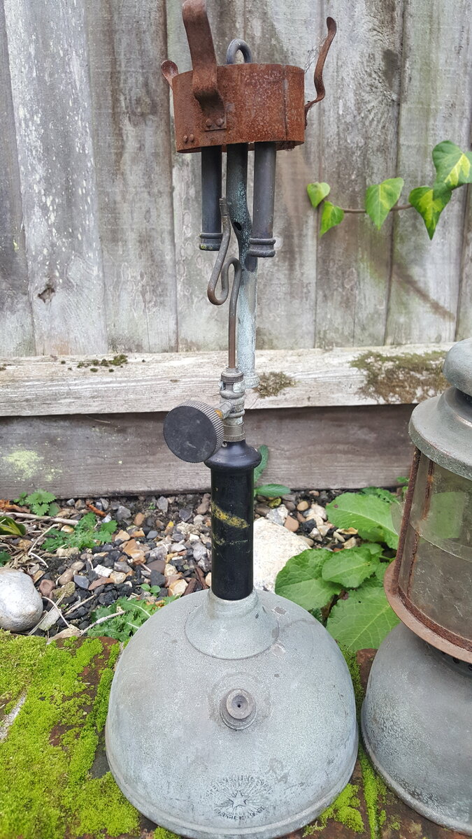

    First up for a testfire is the table lamp.
    Fettling was minimal, clean and repack the control spindle, make filler cap washer, unblock jet and swill tank to check cleanliness.
    Using mantels that were to big and a shade that is far far to big (all I had available) we have a successful test fire.
    I did have to borrow a pump cup thingy from another lamp as my pump did not fit the one this lamp came with.
    Enjoy

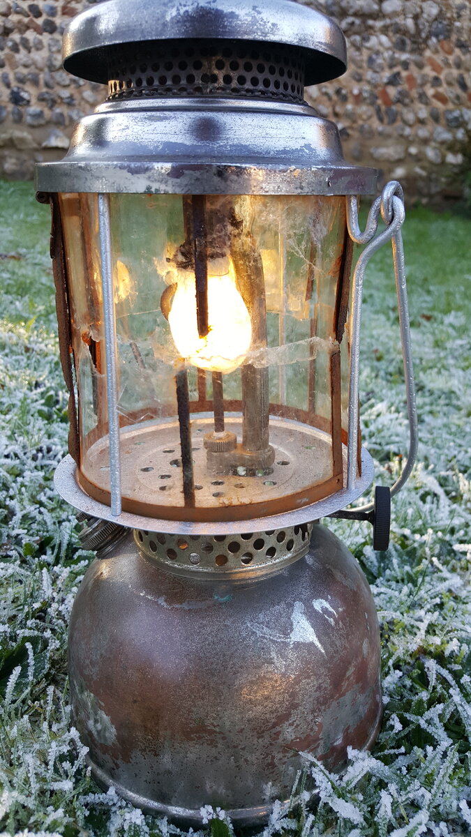

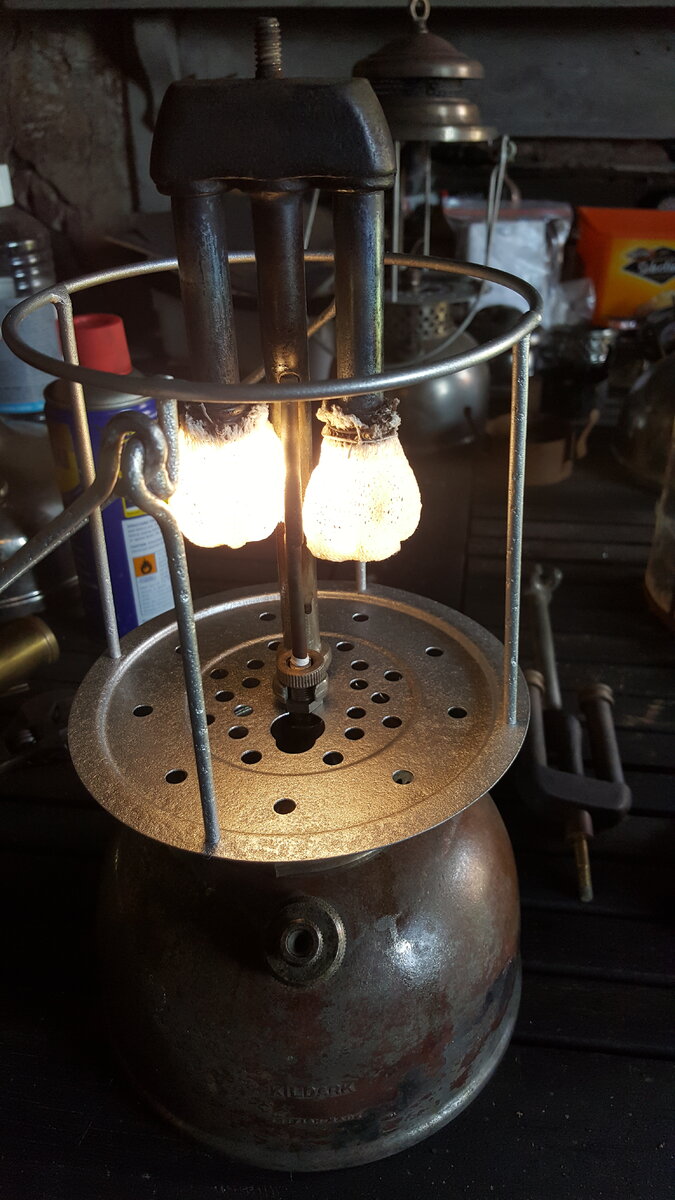

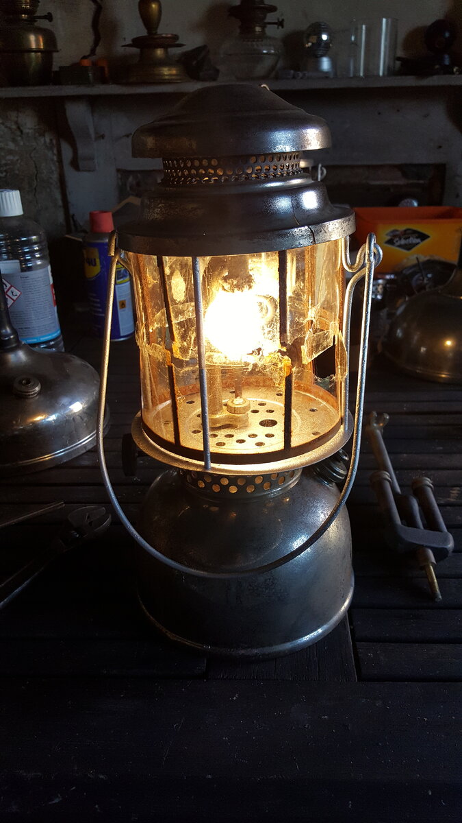

    Next up for testfire is the Kildark lantern.
    Fettling was pretty much the same as for the table lamp apart from the cage had a soak in neat cider vinegar for 3 days to remove the rust, I forgot to get a pic of the results but it was only knowing that the rust would grow back that stopped me from leaving it at that.
    The generator on this lamp had no removable jet, it was integrated like a Tilley one.
    I used the table lamp burner simply because it had mantels fitted.
    It fired straight up but ran really dim, it looks a lot brighter in the pics than it actually was.
    At first I suspected a blockage somewhere, but it ran consistently for quite a while with the absolute minimum of light emitting burn.
    I had pumped it what I thought was more than plenty for a 96 year old white gas lamp testfire, but the I remembered the ball bearing in the valve did look like it needed changing.
    I swapped the valve for the one in the table lamp and was able to get much better pressure.
    I just need to get some mantels and a ball bearing and fettling will be finished.
    Successful testfire.
    20221212_121246.jpg 20221212_121318.jpg 20221212_132528.jpg 20221212_132604.jpg 20221212_132710.jpg
