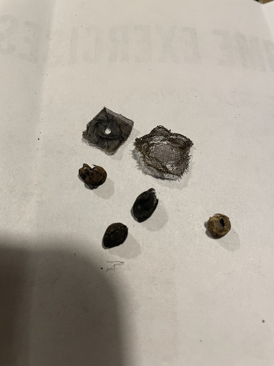

    Yes I am new also to the repaire part of coleman lanterns, I have 2x 228f lanters from my dad when I was a kid fixing/cleaning for my kid and grand kid. Yup getting old myself.
    while reassembling from cleaning went to re-install gen"carefully" bent needle, examining found screen removed it bent my needle was able to fix it but now has a kink/dog leg but does function.
    So yes some maybe all have screen, both mine did removed one was able to leave one in.
    I think back then gasoline had particulates that the screen helped catch but today gas is better runs fine with out screen so keep or toss doesnt seam to matter now adays except for if you are a collector.
