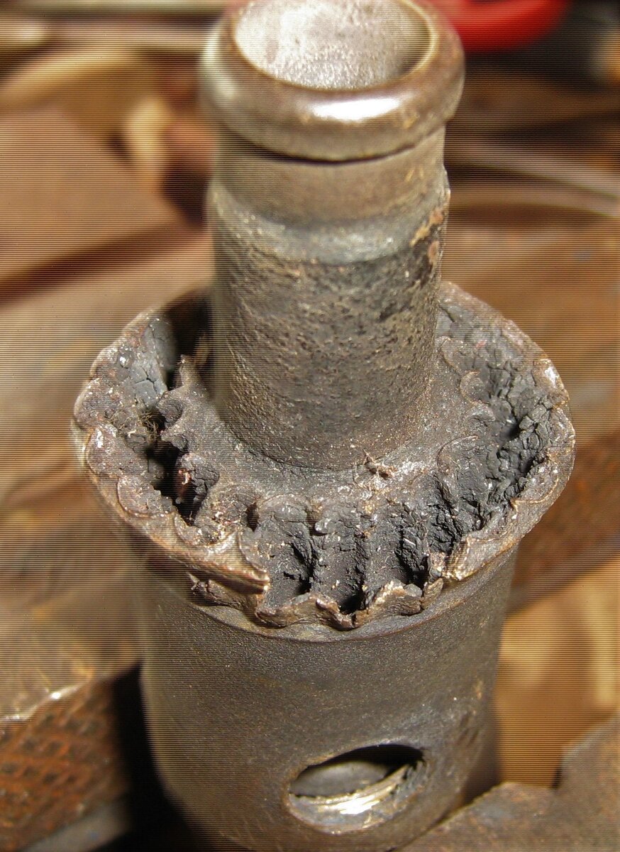

    I've just come across these images which I took just before my last camera stopped working.
    This burner was on a Tilley X246 bought at a farm dispersal sale many years ago. One can only wonder what sort of a life the lantern had had, how many hours and how many gallons of paraffin it had burned, how many vapourisers, mantles, glasses and seals it had seen.

    Rod it out a little with a pipe cleaner, and it'll be good as new. :^o
  3. MYN
    2,081
    I'd reckon that didn't happen overnight and it was somehow still working with the burner severely eroded as such.

  5. Fireexit1
    1,359
    Wow - I thought I had seen some "fair wear and tear" - that is a piece of history !

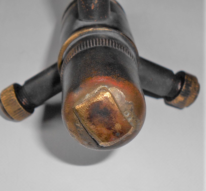

    Here's another case
    I saved this one by silver soldering a patch over the hole.

    Based on my experience I suspect that did happen overnight. I bet it went to overburn and it wasn't noticed until it got so hot the brass started to decompose and burn itself.
    Scary. I wonder what eventually stopped it. Ran out of fuel or it melted the vapouriser. Either way probably best the owner wasn't around.
    It doesn't take long for overburn to make the air tubes droop and the burner body to go triangular in shape. Seems like this one continued way past that stage.

    Would this be caused by a loss of air pressure sufficient enough to push the flames out of the burner?
  29. Tony Press
    Tony Press Antarctica Subscriber
    7,573
    “Underburn” is a widely used term. There’s no need to invent another one because it’s a Tilley lamp or it’s on CPL.
    The reason “underburn” is used is that the failure of correct ignition (burning inside the burner, rather than outside the burner) happens before the appropriate point of ignition. The same phenomenon in stoves where the incorrect burning occurs under the burner cap is called “underburn”. In many older gaslights and liquid fueled lamps the mantle was upright… the underburn would have been under not over…
  30. Tony Press
    7,573
    @John
    Yes, that’s one of the common causes.
