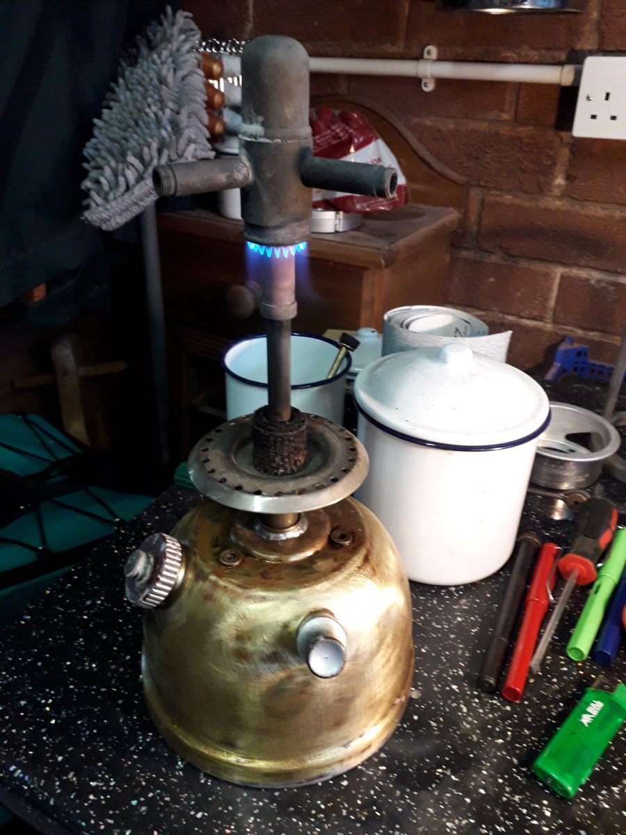

    I bought a Bialaddin 300x last year and discovered the tank had sprung a leak around the control cock boss, the previous owner had attempted a solder repair but unsuccessfully, the solder came away easily and paint / muck was visible beneath. I put the lamp to one side whilst I worked on other projects and rediscovered it last week, I cleaned up the tank top and boss thoroughly, heated the area using a gas blowlamp several times and applied flux, wire brushing each application with a small brass wire brush. Once I was happy the area was thoroughly clean I applied flux again,heated the area and ran a neat bead of solder around the joint. Lamp then loosely assembled and tested, I am pleased with the result a successful repair.

    Good work! Please post again when you have completed the restoration too. They are fine lanterns.
    9,475
    Well saved!:thumbup::thumbup:
  4. ROBBO55
    1,754
    Nice tidy repair. Along with a good method for preparing the fault for soldering. :thumbup:

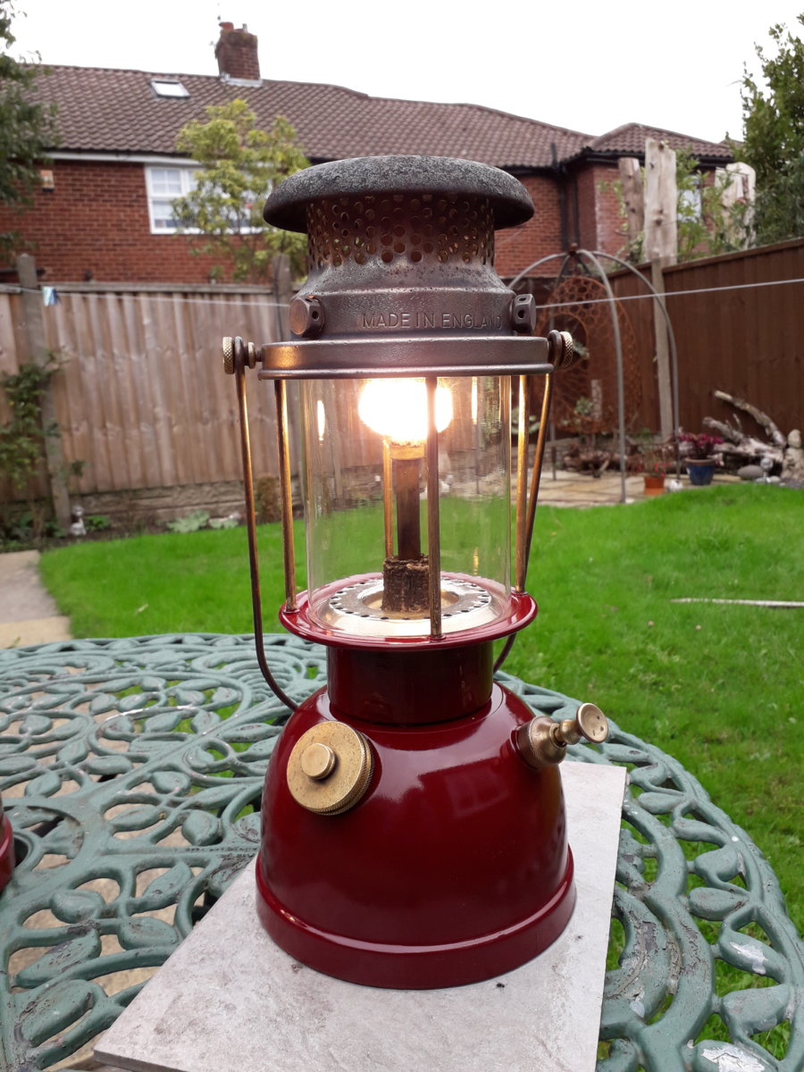

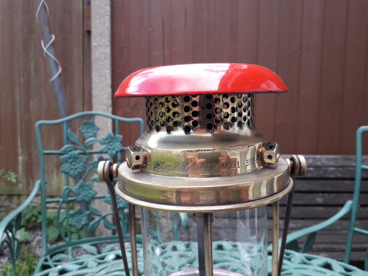

    Nearly finished lamp running with a hood from another 300x, just waiting for a new red enamelled cap, painted filler cap and painted pump assembly.
    Twins (almost)

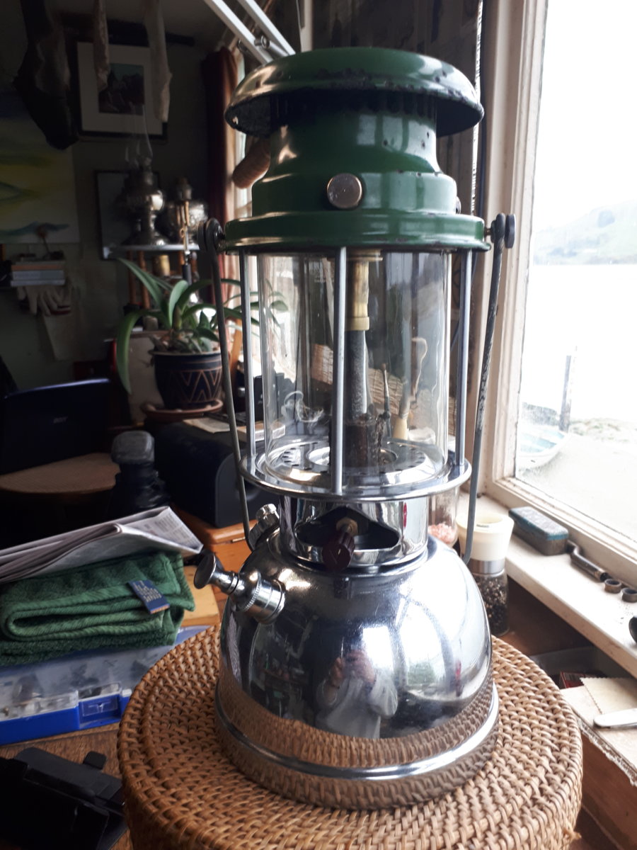

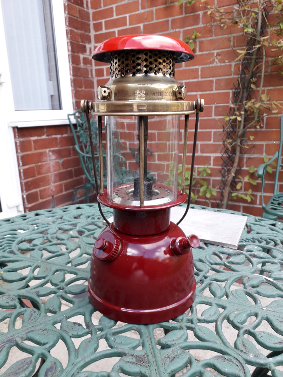

    Does it look anything like this one?
  19. toad of the cape
    toad of the cape Subscriber
    Feb 21, 2017
    87
    Yes the very same, I thought I had posted a shot???Nice condition that one of your's,my one is not too bad can't figure out what happened to the pix I posted.

    Chrome lanterns were usually supplied with a black top but Willis & Bates (like other manufacturers such as Tilley) would often raid the parts pin when faced with shortages. Either that, or someone's replaced the top at some point. Either way, the difference is cosmetic only and the lantern ought to work fine - all else being in serviceable condition, naturally.
    I've seen and got a few of these where a chrome cage support has been used on a lantern with a green tank and hood. Again, I suspect that there was a temporary shortage of the usual green-painted part. Probably W&B felt the greater priority was to get orders out of the door rather than keep retailers waiting...

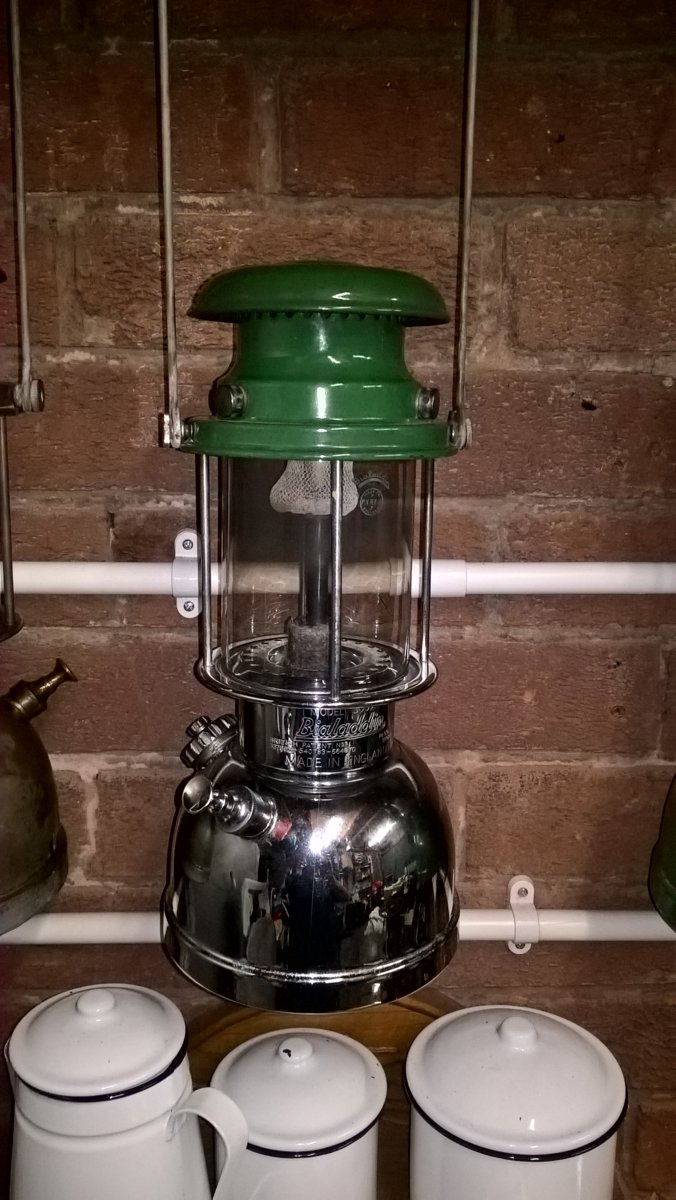

    Cheers David,I may have mentioned not a lot about here in NZ so even more likely to have raided the spare parts bin for a few down under.
    this one works well, that shot had been taken before I made the mantle(from a bulk lot of petromax mantles,also good for my tilleys.
    regards Alex

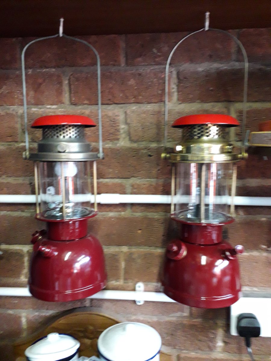

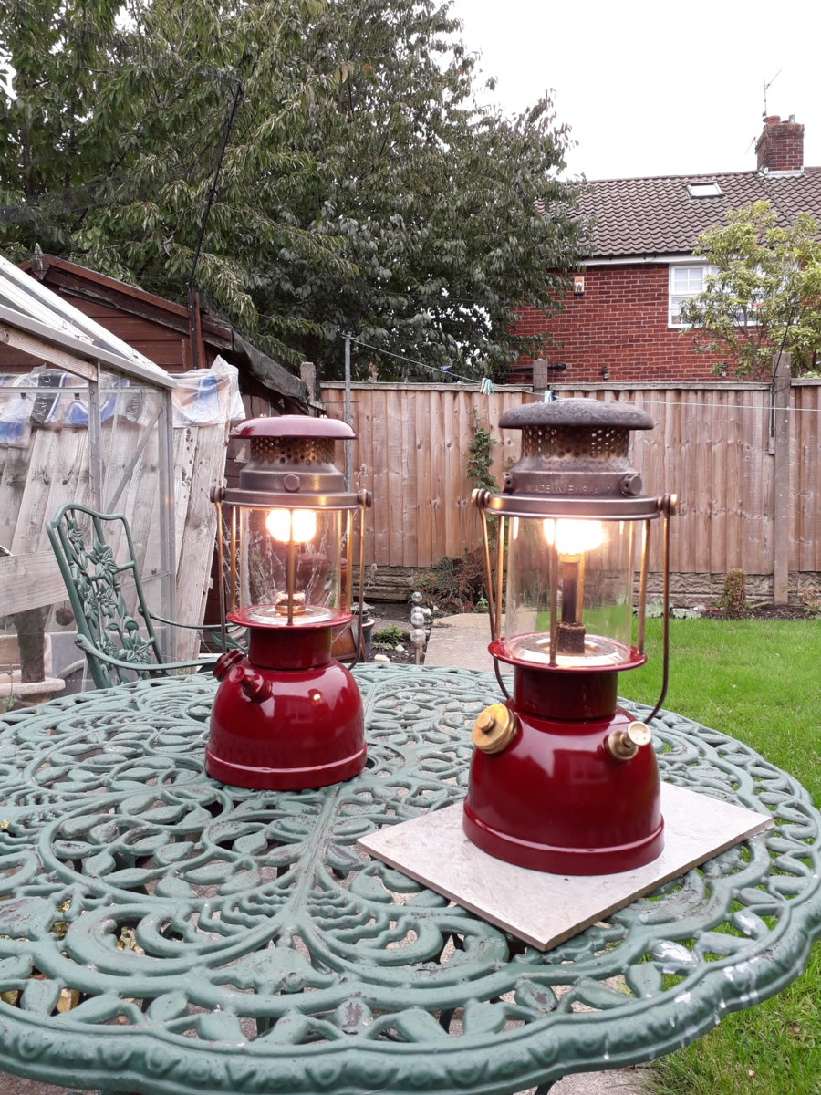

    The finished lamp:
    With its twin
    Not a bad result considering that the previpus owner had given up on it due to its leaking tank.
    I have another similar 300x undergoing restoration, I will soon have triplets!

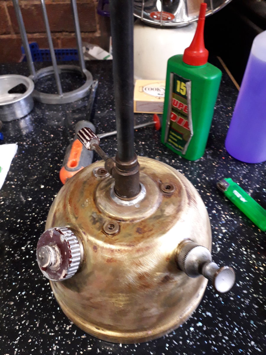

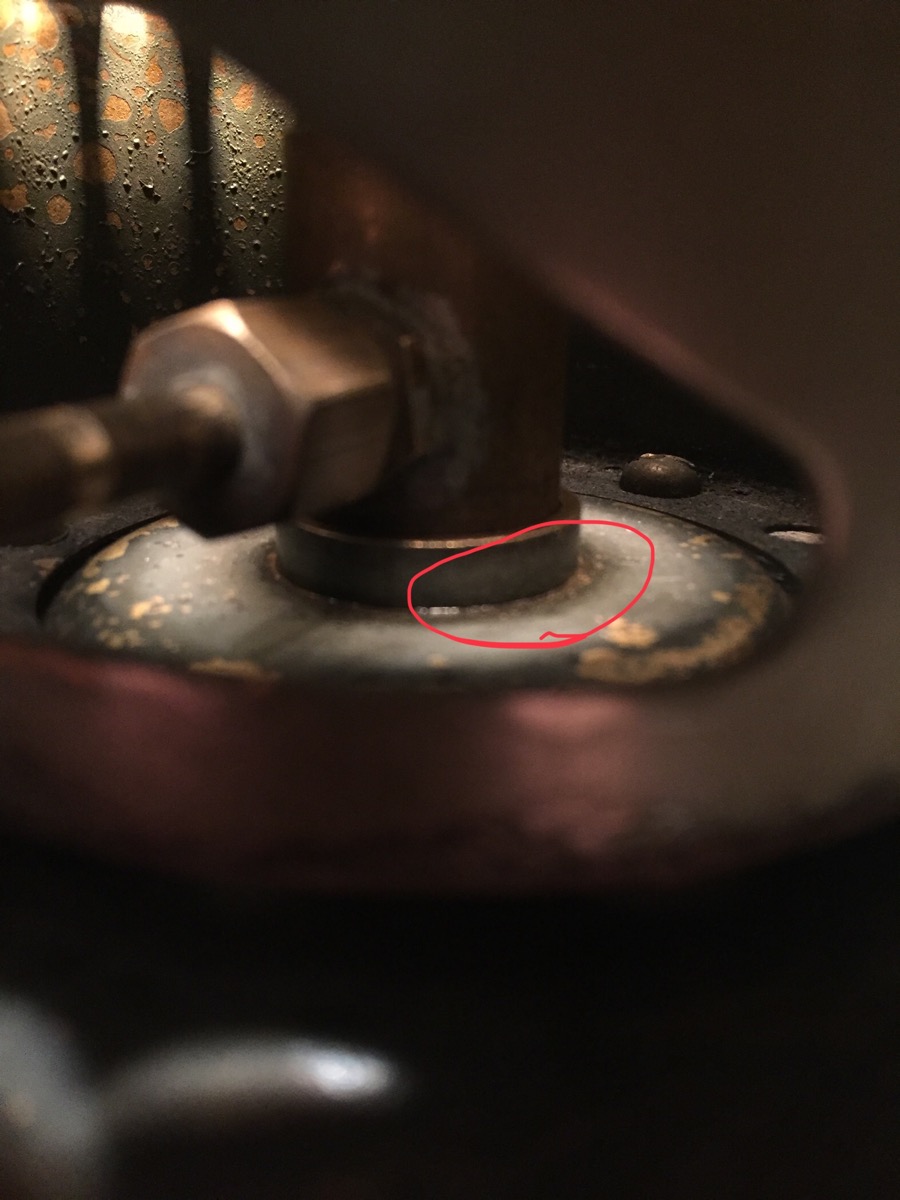

    I have just rebuilt my 300x, as it was leaking from the control cock - now all sorted with a new washer set from base camp, but on close inspection it has a very very tiny leak from around the same boss.
    Do you solder, is in heat and then put the solder directly on the boss to melt?
    Is electrical solder okay? I have some vintage flux core stuff thats proper lead thats sublime to solder components with. Would it be okay for this?
    I have a small gas soldering iron which has a flame attachment which gives a hot blue needle flame about 5mm wide and about 10mm long- would this be okay to use?
    Any tips appreciated, as i love this lamp :) 1949 Air Ministry and cosmetically unrestored (i like the wear and patina - shows its worked a hard life.)
    thanks
    Ed
    P.s its a leak around this bit circled in red. Its barely enough to wet the metal, but if you watch it long enough you can see the odd bubble appear......
  30. phaedrus42
    phaedrus42 Subscriber
    1,936
    The gas iron and solder you have will work well, provided that you clean and flux the area of the joint thoroughly before applying heat and solder. Very little solder should be needed. You can draw a border with a felt tip marker to prevent the solder from running or spreading too far from the joint.
