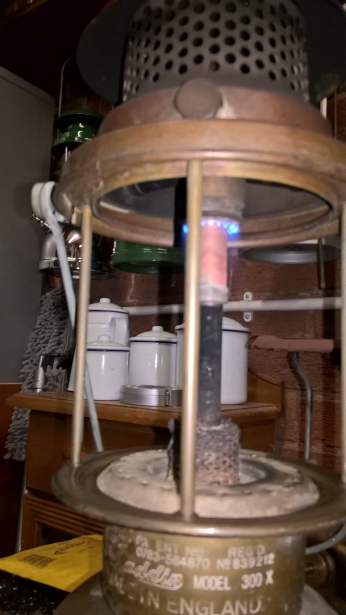

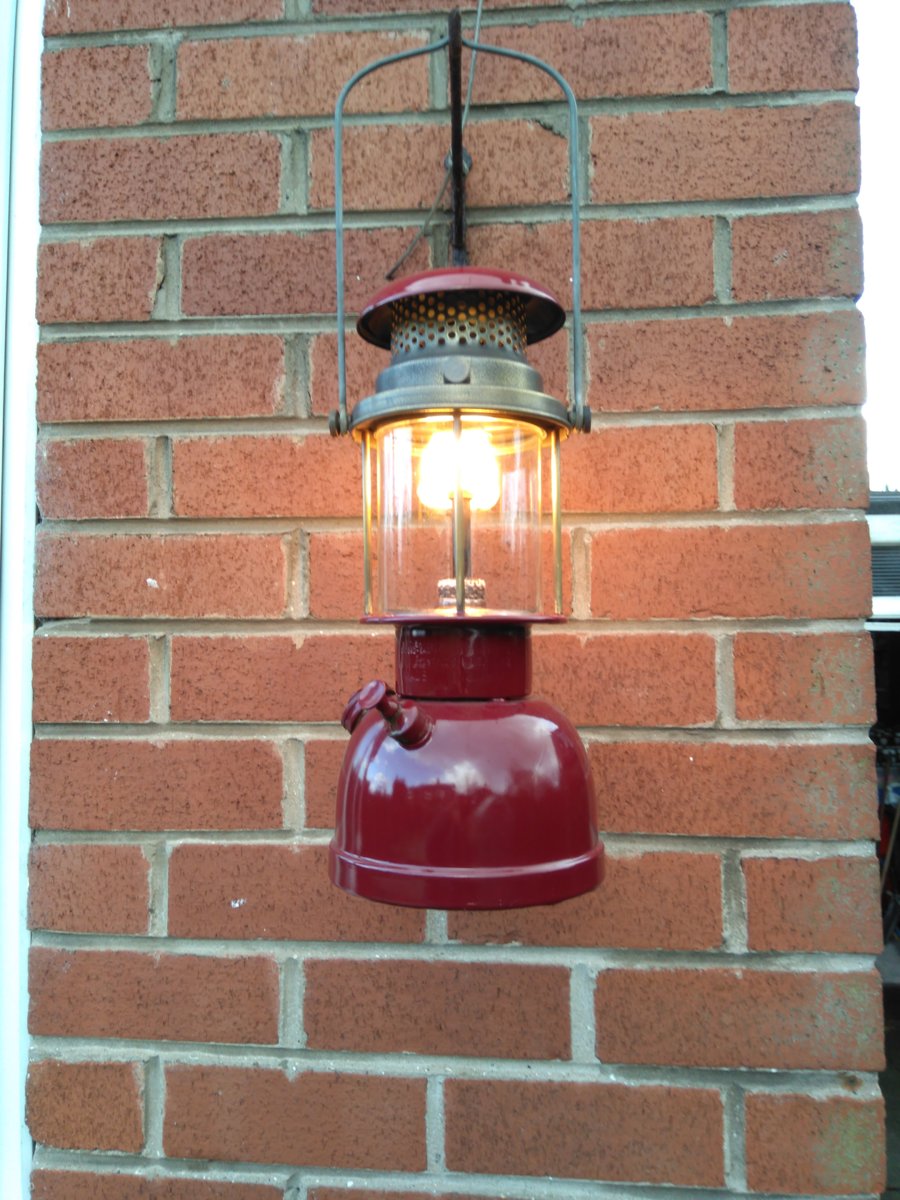

    I bought this sorry looking Bialaddin 300X which someone had stripped all the paint off and polished, by the time I got it the brass had dulled somewhat.
    Not being a great fan of polished brass lamps I decided to restore it to it's original maroon painted finish, the components were prepared, primed red, sprayed with Halfords BMC Damask Red then finished with a coat of fuel resistant lacquer. The red enamelled hood cap was badly chipped so it was replaced with a good quality reproduction item.
    The lamp was rebuilt using a full set of new seals, the vapouriser was cleaned out and a new mantle was fitted.
    The attached Pictures show the restoration process:

    Well done but is there some fuel or just lubricant leaking out of the pump rod cap?

    I thought that when I saw the picture and went into my garage to check the lamp, no defect or contamination found so I think it's a reflection of something in the shiny paintwork.

    Looks like the spirit has boiled over during priming and run down the side of the tank...

    I know I am not the only one who gets 'unbalanced eyes' by looking at a maroon colour in combination with red, as the second incarnation of Bialaddins after the initial black top.
    That red -or any other enamel colour -of the top gets darker when hot while the lamp is burning. I could be wrong but it seems in the pic of the lamp burning in front of a wall, the colours of the tank and the top are getting closer. It looks much better anyway. Perhaps there was some crafty intent involved?

    Yes the top does darken when hot and becomes maroon.
