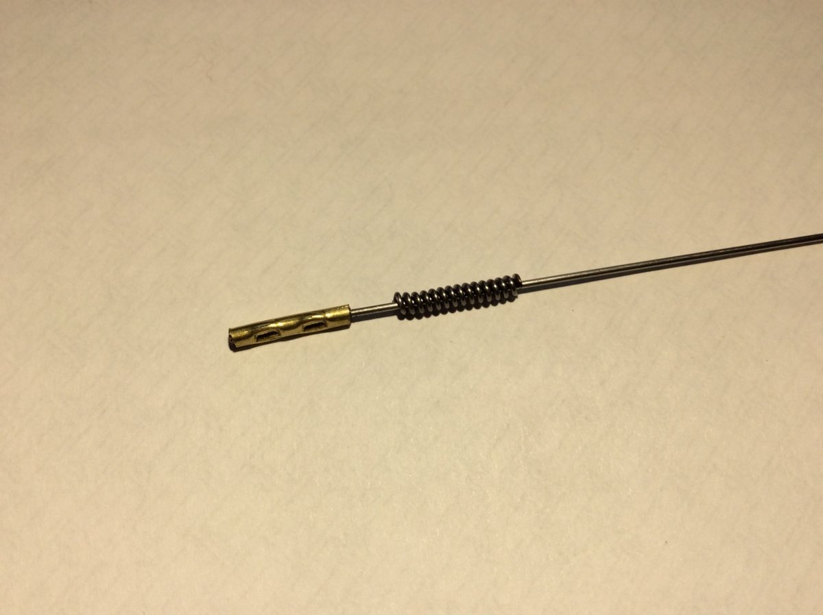

    From time to time I make a batch up and put them on EBay. I don’t make any money from it but it’s nice to fill a void now and again! If you want to know how I make them let me know?

    Well you will need some....
    0.8mm TIG Stainless welding rods
    Drennan fishing slim crimps 28-40 lbs 7 strand
    Brass tube
    Rotary tool
    Diamond files
    Crimping tool
    Good eyesight!!
    Cut the brass tube to the length of the slim crimps and insert the crimp. Cut the rod to correct length and insert into Crimp. Crimp with modified crimper tool.
    Set up rotary tool, I use a Proxxon variable speed tool in its own mini drill press but have it upside down. Fashion a steel plate spaced the correct distance away with a 0.8mm hole drilled into it. Fit the pricker blank into the chuck so the tip is just poking above the steel plate. Make sure everything is fixed solidly to the workbench. Once you have this set up it’s east to make up batches if your blanks are all exactly the same size.
    Start with a rough grit diamond file and take off the bulk of the tip as it spins at a moderate speed pressing one side only. Then as you near the final tip diameter use something like a mini dmt diamond hone in blue then red grit.
    You have to be very careful as you get near the finished size as it breaks easily. But after a few dozen you get the knack and can produce repeatable identical pricker tips. Just get something with a 0.2mm hole and make sure it fits with no snagging, don’t use an old Vap tube as it’s likely worn a larger hole after being used a while.

    Nice work but please may we know more about what this is? "Drennan fishing slim crimps 28-40 lbs 7 strand"

    @Henry Plews thanks for the link but it leaves me just as puzzled.
    I don't see one of those in the finished article so I wondered if it was about the crimping tool to use?
    Or does one lurk inside the brass tube? Maybe that is it.

    Brass tube (slim crimps) would go on the end of the pricker rod where it makes contact with cock (knob for moving pricker up and down). Think I got it right...:-k This is a great idea!:clap::D/
