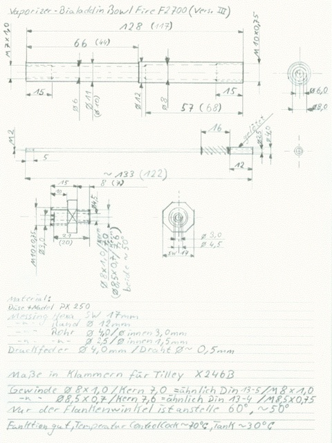

    I searched for this thread a few years ago... and i become the idea it is a little bit different to the british standad threads!?
    I messure it and built it by my one:
    Regards, Frank

    Aah, i fotget... the messure results in the (...) comes from a Tilley X246B:content:

  13. primaxel
    Aug 31, 2017
    115
    @Norman
    Yes, the diameter and the thread gradiant are standard but the angle is different to standard threads.
    That is what messured at the original parts.
    I built a tool with the correct angel and reproduced the thread at the lathe.
    Regards, Frank

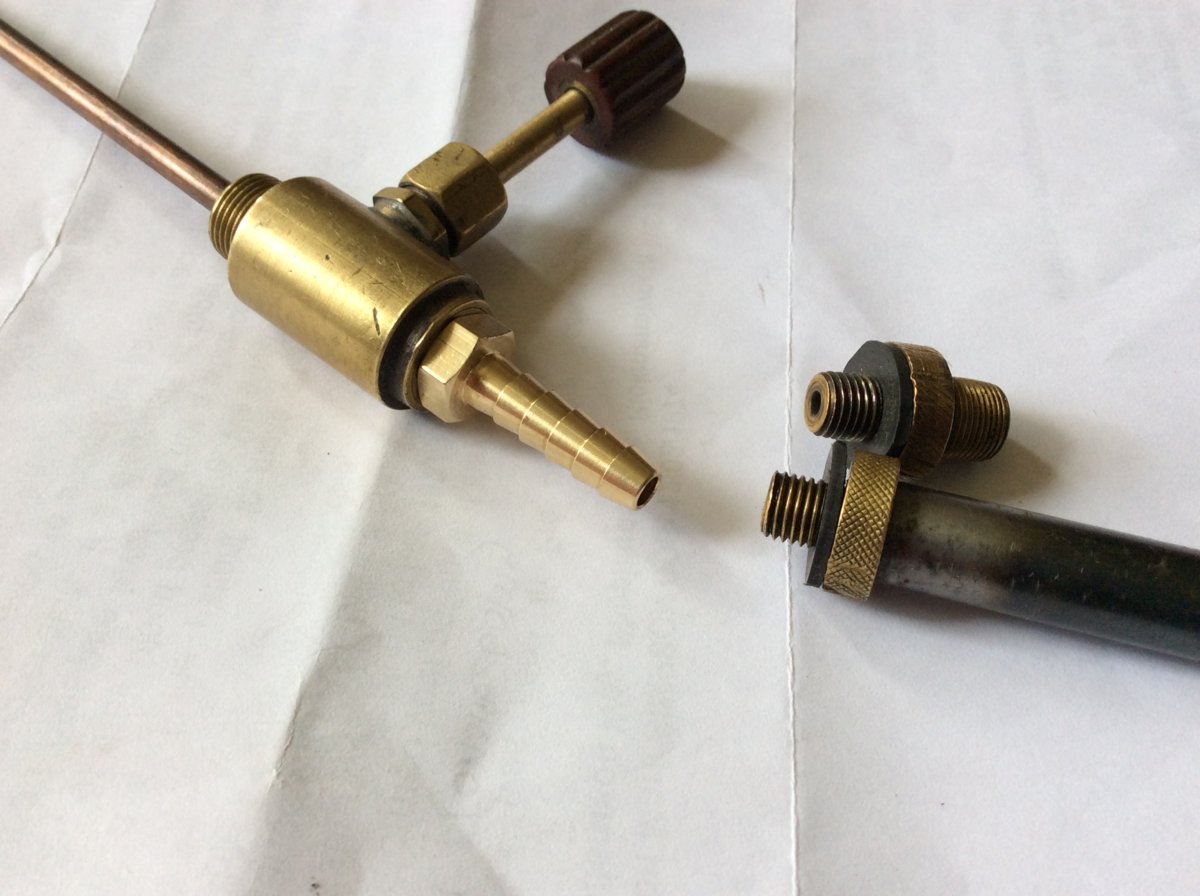

    648A179A-970A-4BD2-8A10-F4CB7EF8DA62.jpeg 1021E368-F1A6-4E08-93E5-FE1CD8EE26D6.jpeg Something strange just happened!! The postman just delivered a Brass fitting I was gonna have a play with. On trying to screw into a Bialaddin control cock it went in just perfect?? It’s an M8 x 1 mm threaded connector. I tried it in another spare cock and it went in almost all the way but bound up a bit with a few turns to go!

    953
    Hertfordshire, England
    yes - that is how a pitch error shows up. Not too bad for the first few turns then it begins to get tight - if you carry on - then something gets terminally mangled.
    I think we are a bit crossed here about Bialaddin and Tilley. No saying they are the same threads.
    That brass cock you have is not the aluminium body one that I have on an X246B - which is the one Frank measured up.
    Can you be sure that both the cocks you tried to mate are from the same source? Could it be M8x1 on Bialladdin and M8x 0.75 on Tilley for example?
    I'm sorry I don't recognise that double male adaptor in your pictures you have used for comparison - whats that?

    Yep I’m on about Bialaddin Vap tube threads here. My control cocks are all Bialaddin. The M8 x 1 brass hose connector screwed in perfectly on one cock and maybe one whole turn less on the other? I was amazed that it did as I thought they used a unique thread size. M8 x 1 or M8 Fine was almost spot on, I wasn’t aware Metric was even used when these were made?
    It may be just pot luck that it fits my two spare cocks but I have four other complete lamps to try it in! Maybe it’s just a near match thread size that will fit some and not others?
    Maybe if this works out for Bialaddin Vaps I may try it for Tilley?

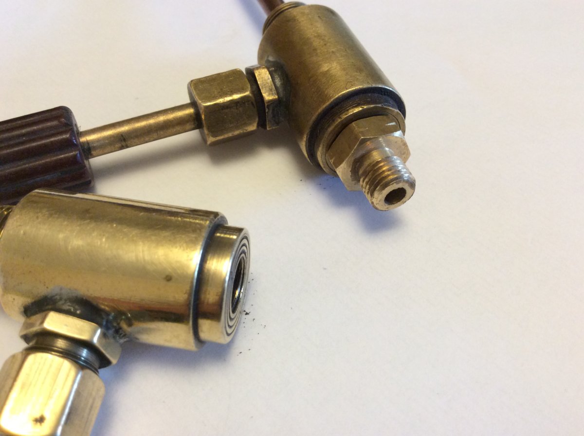

    C9261870-A2A6-4A74-B737-A8892E3F8D55.jpeg ECB1F3F3-4805-4492-A0A7-FCF61BC0785A.jpeg 3103D7FA-15D8-4150-BEA7-9AA239FCD5EC.jpeg Well another brass M8 x 1 connector turned up today. Another step in the evolution of a DIY Bialaddin Vap tube! This one is better with the twin screw threads. This one screws perfectly into both of my spare control cocks!
  23. MYN
    3,087
    From the 1st drawing posted by @primaxel, I could recognize that its one of those usually done by a German or an Austrian.
    I'm an engineer by profession and I've seen plenty of those similar 'maschine' drawings here that came together with the machines in the Plant I'm working in.
    So, if its German, they don't fancy "inches". Metric fine thread would be more likely for fluid-handling mechanical constructions.
