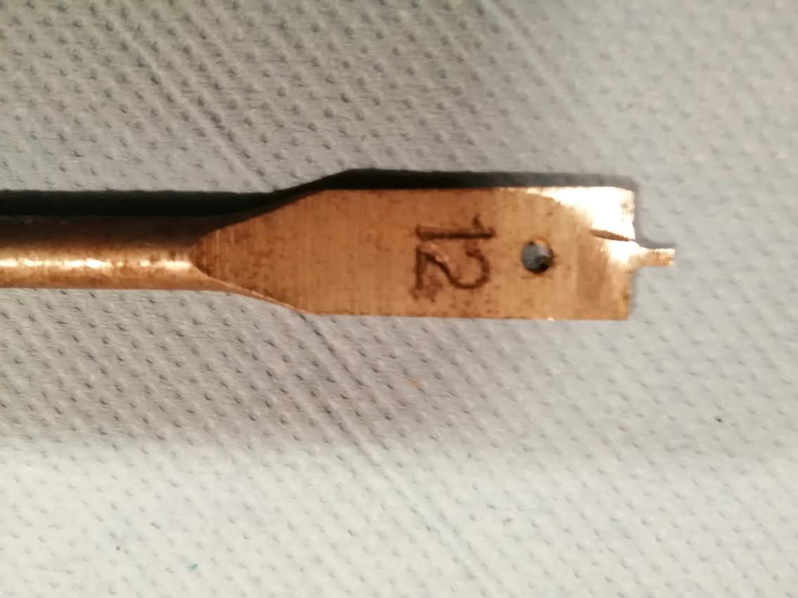

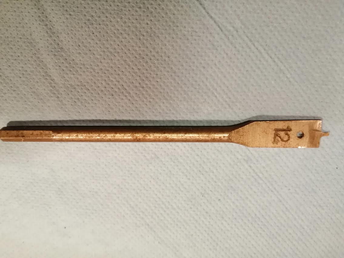

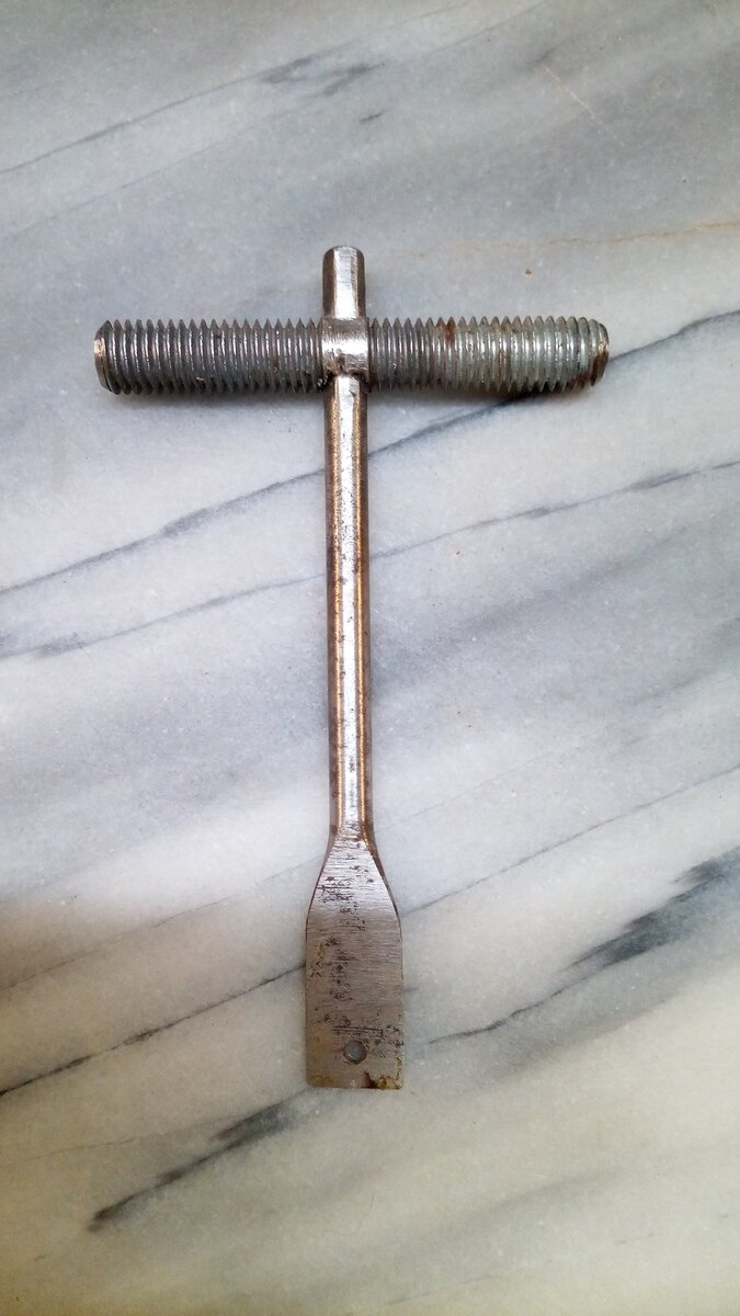

    I've always used an adapted screwdriver to access the slot on a Willis and Bates NRV but I've never been entirely happy with this solution so I decided to make myself a special tool.
    I saw someone use an old flat bit for the blade so having a bunch of duplicates I set about grinding the point off the tip. Having done that I needed a cross piece but all I had was some 12mm threaded bar but it had to do.
    I drilled a 7mm hole in the threaded bar, cleaned the surfaces, applied flux and soldered them together. Admittedly, solder wasn't the ideal choice but I figured it should hold ok
    Here's the result...
    I'll admit, it's not pretty but it does the trick!

    It looks the bee’s knees, it’ll do the job, just one question......
    Did you silver solder the tee piece on, or was it lead/tin type solder?
  3. ColinG
    3,737
    It was soft solder only, Pete as I'm short on silver solder and it's blooming expensive! Hopefully soft solder will do the trick but if there's any movement I'll drill and pin it.

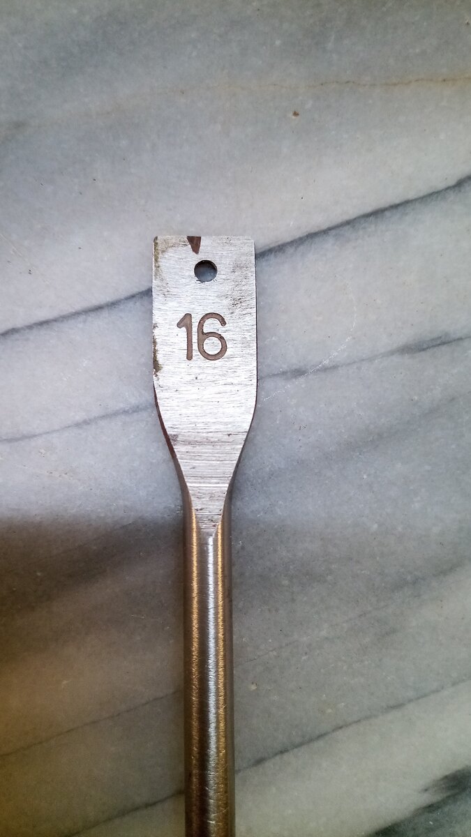

    @ColinG
    A good idea Colin.
    If you sharpen the tip of the drill, it will always be centered.
    See photo.
    Tom
