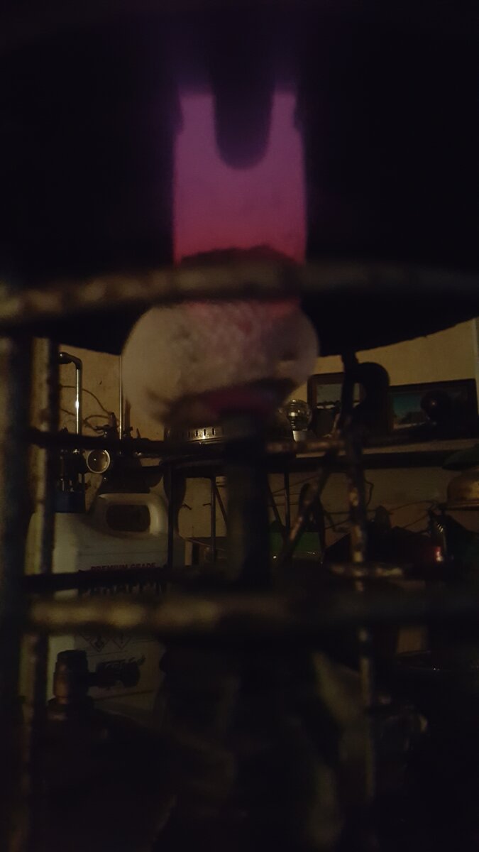

    Recently I was maintaining the fleet of workshop lamps and ran out of old ones to revive and observed these events.
    Pic should show a Tilley burner still glowing red after running with a worn generator.
    Hope my ramblings are of use to you or anyone else.
