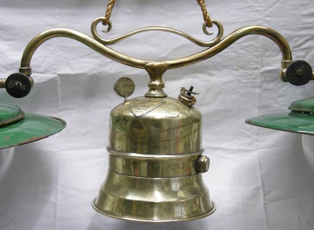

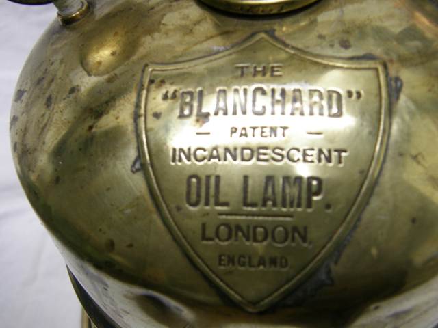

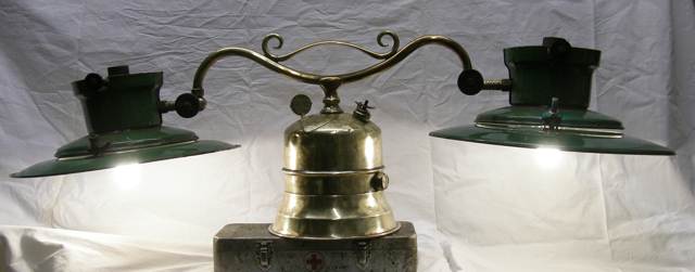

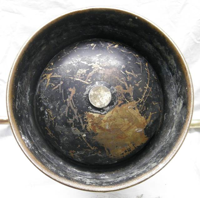

    I acquired the tank for this a few months ago and have just found a couple of burners to fit it. I have not seen another tank of this shape before so I think it is possibly very early for Blanchard. There were several very minor stress cracks around the central seam and a serious leak at the top tank boss so I have had to insert a POR15 liner to get it to hold pressure. I am not sure of the model number but since it is of a size to accept burners with the large reflectors I assume it is a 1215. ::Neil::

  5. Mackburner
    6,211

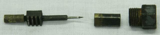

    These are always hanging lamps. When standing the globes are too close to the table and would probably scorch the surface. Their primary use was as stallholder lamps in London Markets.

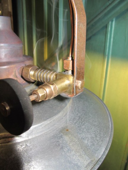

    They are tricky burners to fettle but easy enough once you get to know them. It is a clever piece of design and whilst complex they do seem to always fettle well and no matter how old still perform well.

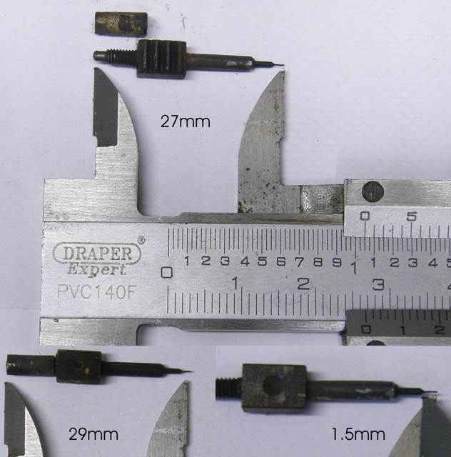

    The biggest problem is always the prickers. To access the pricker carrier rack you remove the top plug on the burner and rotate the pinion to lift the rack out of the burner. The needle is held in the rack which looks like this.
    I make new needles by grinding down a 27mm long piece of an old Tilley pricker to create a 0.006" needle end about 1.5mm long. Tilley pricker wire is the right size to fit the rack. It takes me about 20 minutes to grind a new end and I reckon to break maybe one in four. I grind the ends with the wire in a Dremel running at about 12,000rpm and after taking the wire down to about 0.020" then grind to 0.006" with an oil stone and use a illuminated magnifier to see what I am doing. When fetting an old Blanchard burner you have to remove and clean the jet. This requires a box spanner to reach into the burner. The jets are steel and after a long period of storage tend to rust slightly. This surface rust needs to be ground off by gently rubbing on an oil stone. There is a triangular block inside the jet which is a guide for the pricker rack. This needs to be cleaned of old carbon residue.

    This is a nice find Neil, and indeed an early Blanchard 1215 tank and arms, and I think it would date from about 1915 on wards.
    In the George Adams 1914 price list, it shows one early twin Blanchard Model 1255 with 2 x 100cp burners and very ornate arms and small tank.
    The style of this tank and arms would suggest this was made later than 1914 and is the forerunner of the later standard tank on Blanchard 1215s, this early style of curved arm also changed to the straight type by about 1918-20.
    By about 1915 Blanchard had stopped putting Model numbers on it's tanks, as the same tank could be used with any number of configurations of burner sizes, arm, reflectors, globes and trims for indoors and out door use, all which were given different model numbers.

    and the swage around the mid section above the gauge is there a solder joint here?
    looks like the tanks made of 2 halves soldered mid section and the base "bell bit" soldered on for it to stand on,unless the joint is on the bottom bit cannot tell so well from the pictures.
    that metal in the centre bottom will be a tube for the fuel pickup but it also holds and strengthens the tank its similar setup to the hanging lamps

    71
    Neil,
    As the above photo from Shackelton's Expedition of 1915 shows a Blanchard 1215, with the standard tank that was used on all of Blanchard's twin lamps up to 1925, and afterwards by W.M Still.
    That would suggest your tank was either made earlier, pre 1915, or was may-be one made later if there was a shortages of normal tanks, may be during the 1914-18 war years, (that's only a thought of coause Neil)
    Is there a serial number on the Arm?
    Jim
  15. Mackburner
    6,211
    The tank is made in two domed halves and soldered together with an extra skirt as a stand. It has a central tube running from the top to the base with a couple of holes near the bottom. The fuel feed is attached to the arm fitting and fits inside this tube.
    I assumed this was an early tank rather than a later type simply because it is a shape I have not seen before and in general the later a product the more survivors. The number on the arm is 53. I am not familiar with these serial numbers but maybe 53 is from around 1909-1910? Also there is no address on the shield which also perhaps indicates early. ::Neil::

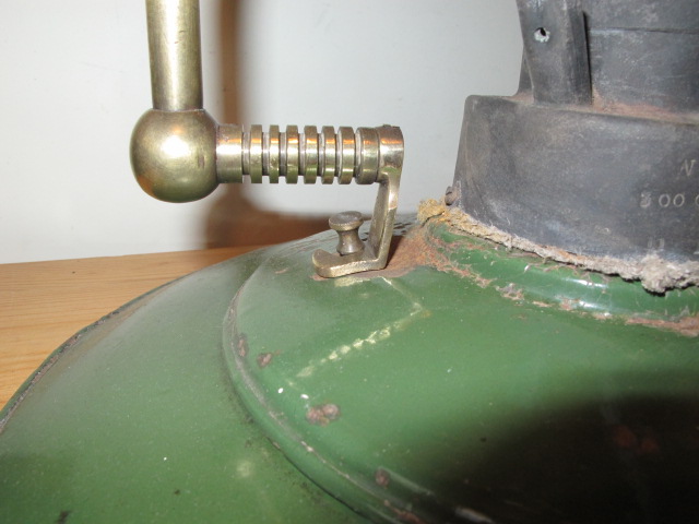

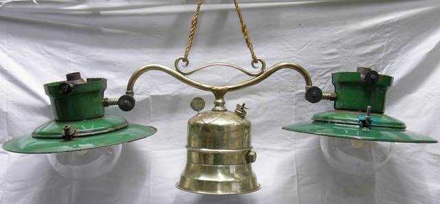

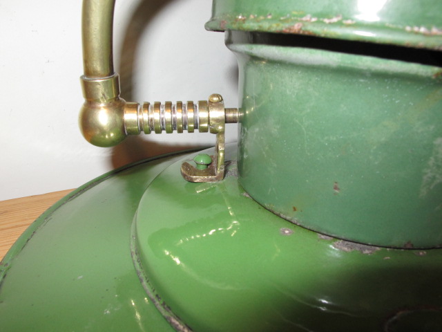

    Now this one in the gallery
    http://0flo.com/index.php?threads/2164
    has the bell tank and the sweeping arms but it has square blocks for the main control valves which as far as I know from dated lamps\burners about 1922, yours has the round ball and and sockets as all the earlier lamps have which I believe are all pre mid 1917
    There is a intermediate type just a round ball between the two types all the dates could be give or take a bit as I can only go by what I have here
    1449179824-IMG_1917.JPG 1449179843-IMG_mid_1917_on.JPG 1449179860-IMG_1922_on.JPG
    hope you can see the differences from these like
    its a good lamp neil one I would be glad to own myself still no closer dating it but nice early Blanchard
