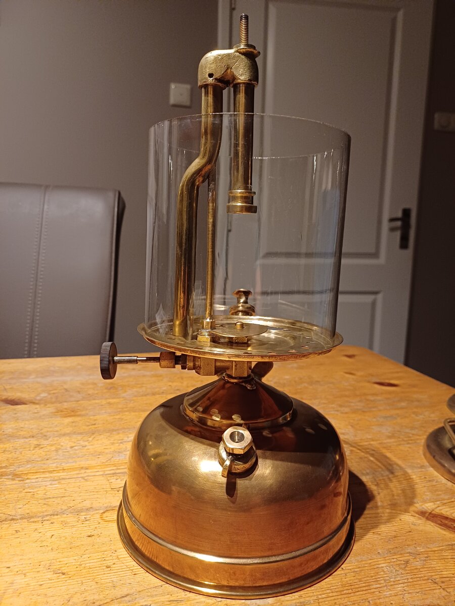

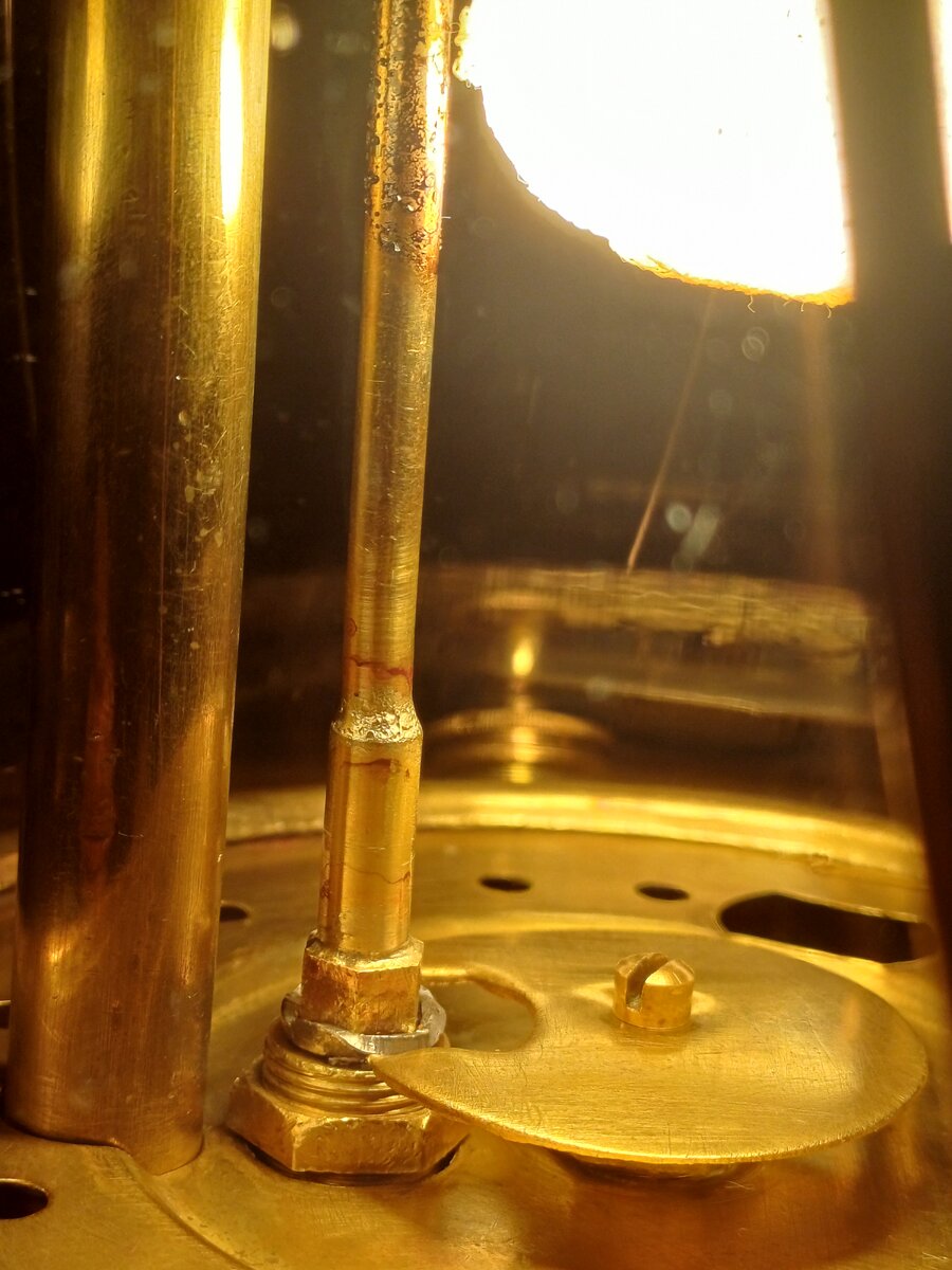

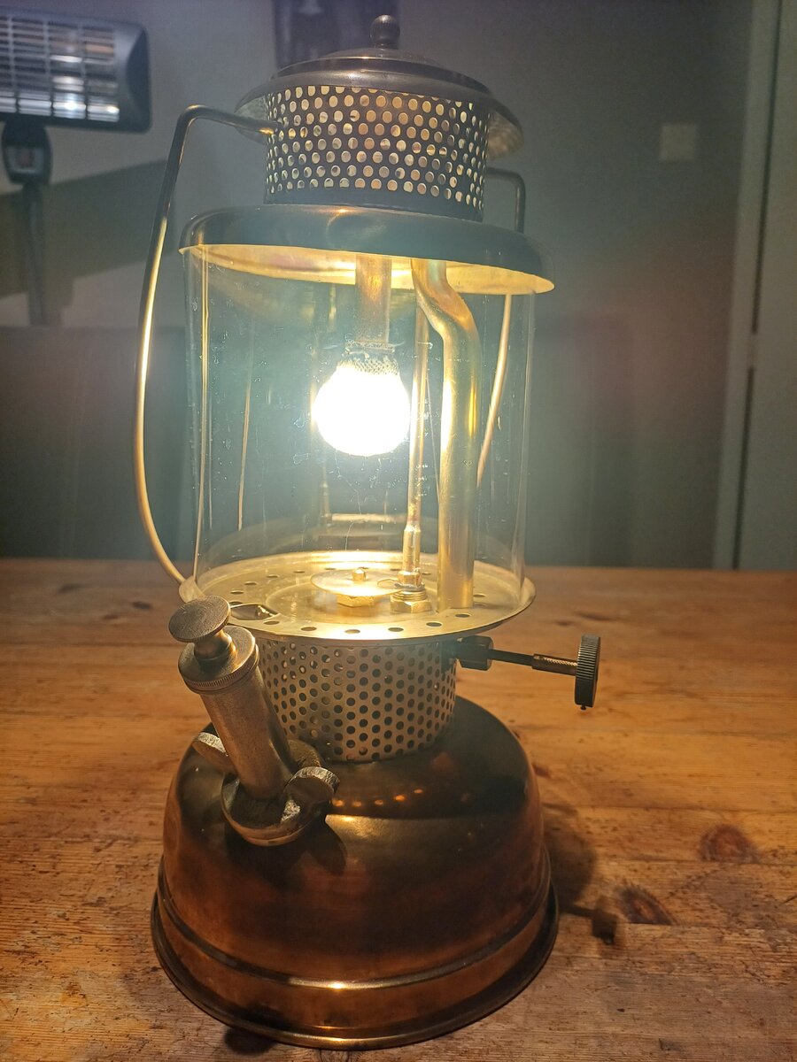

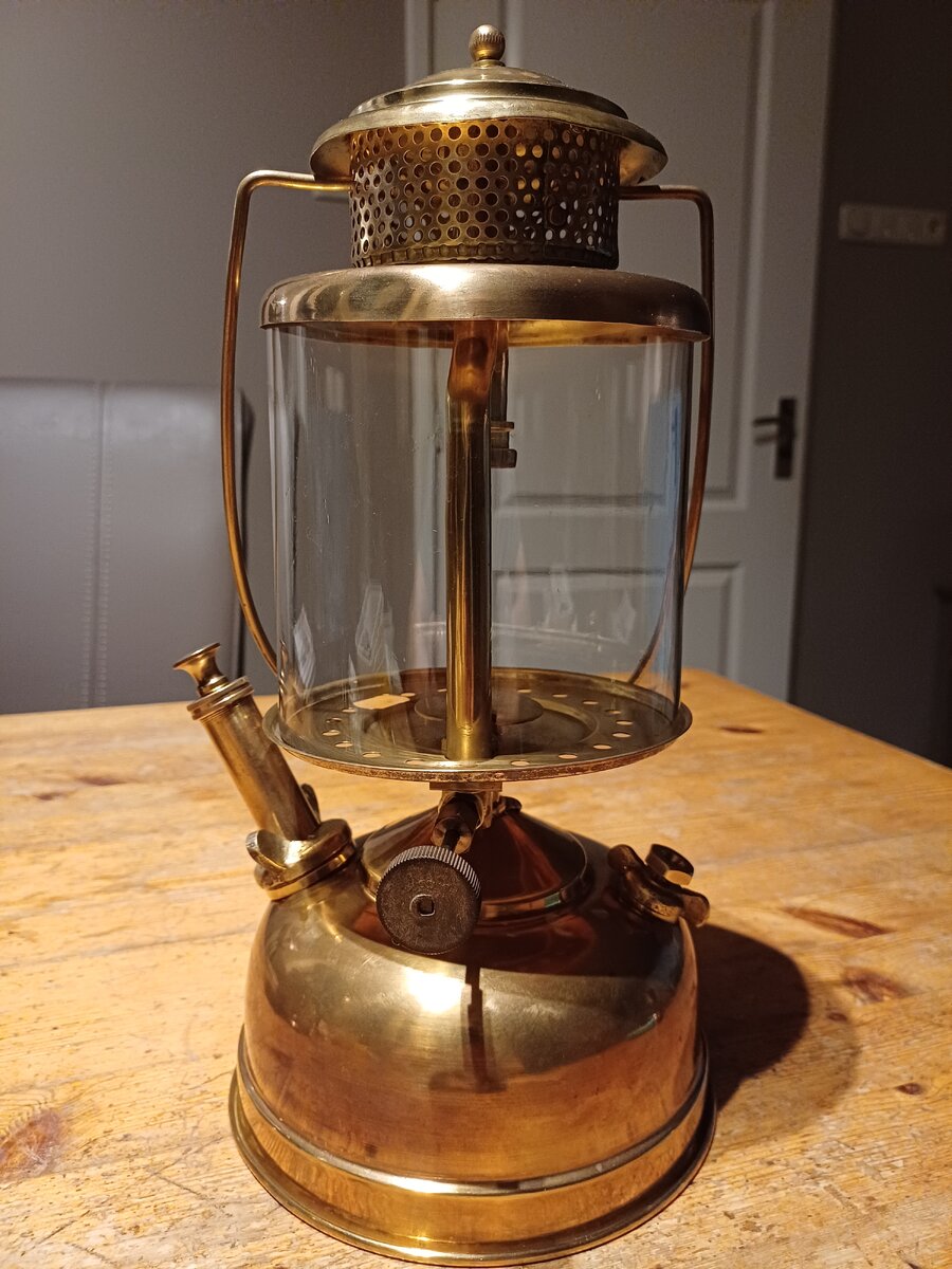

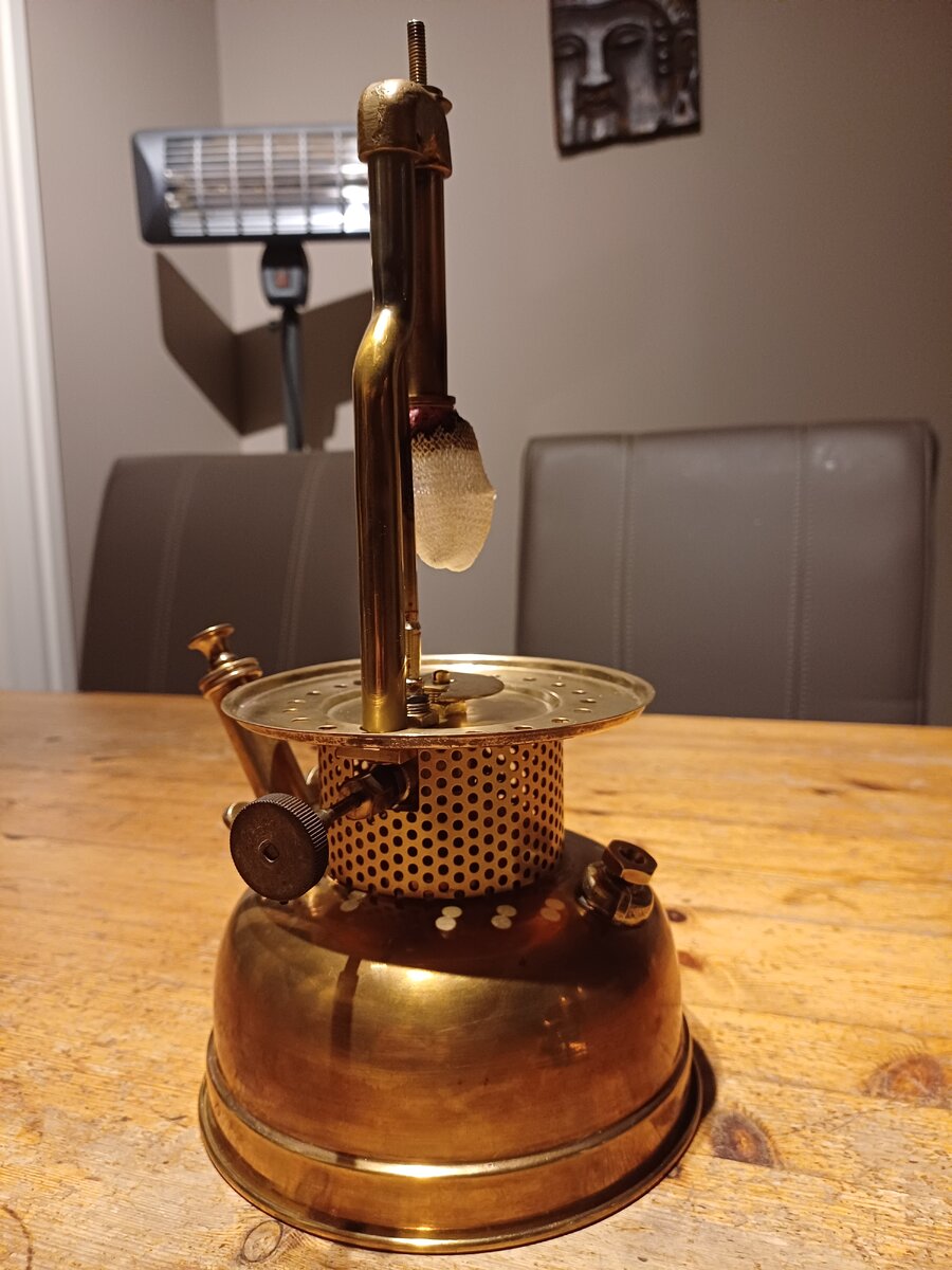

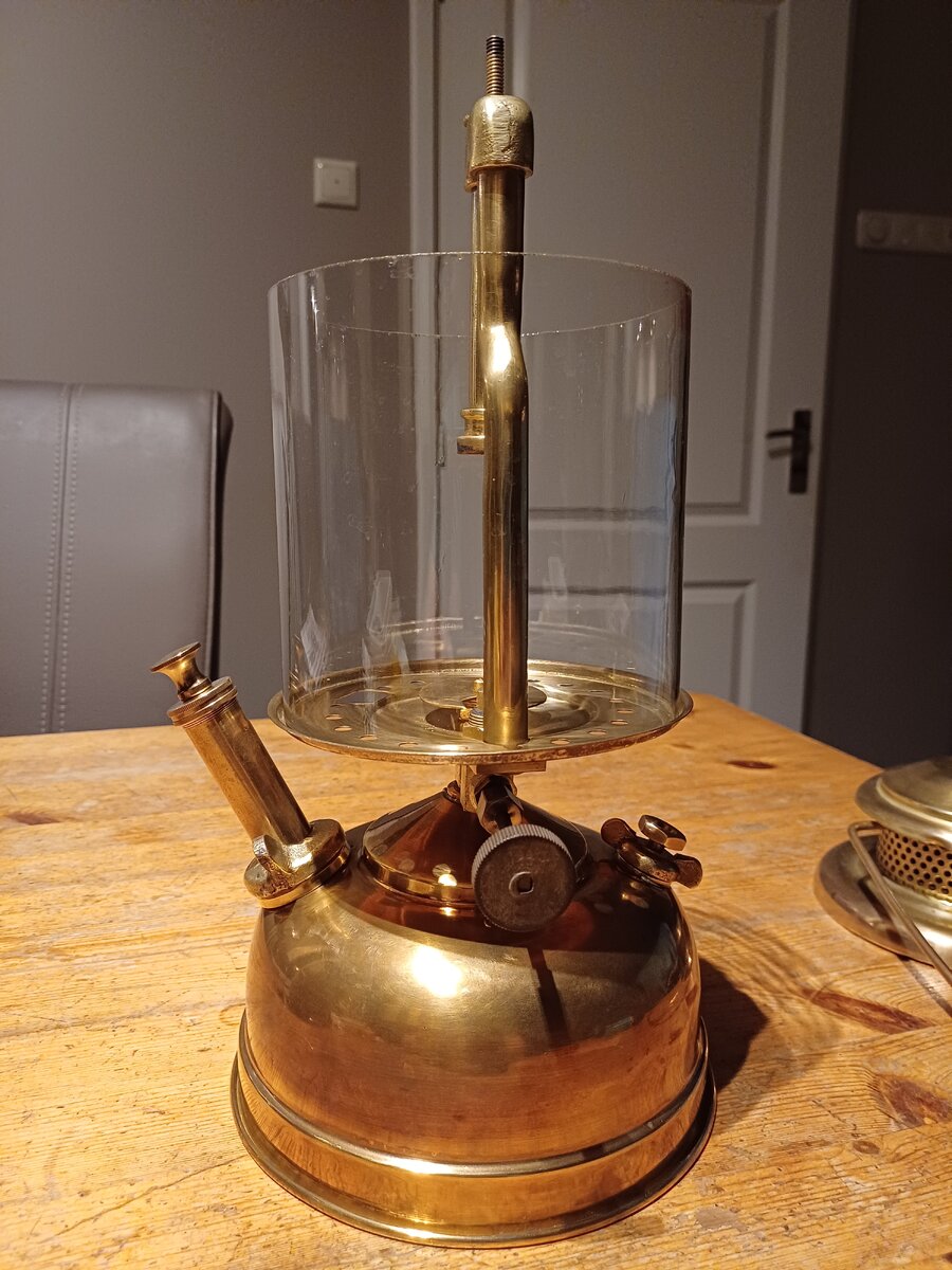

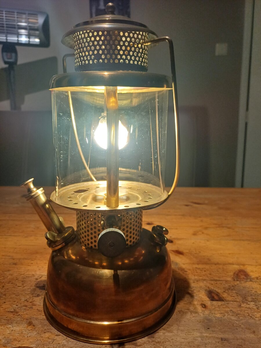

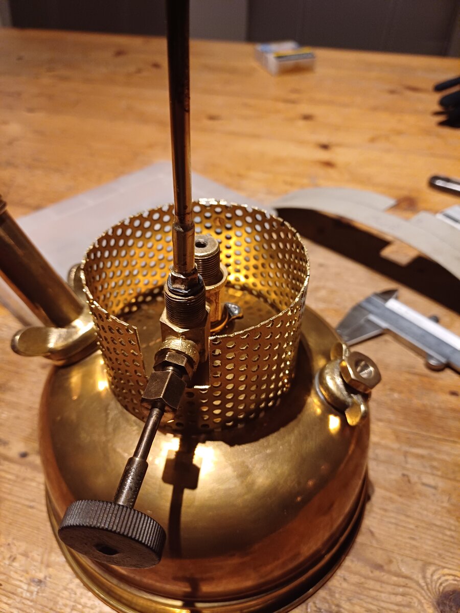

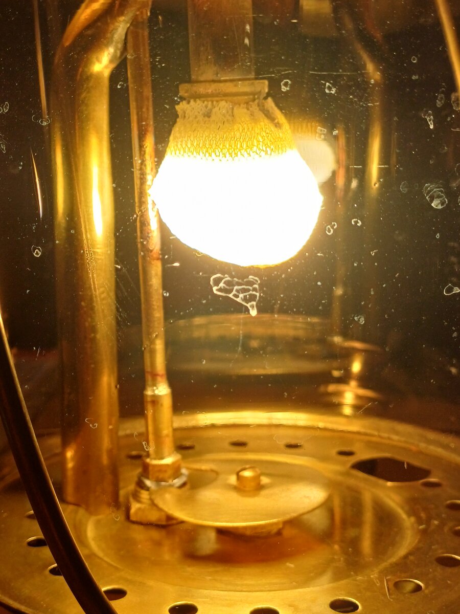

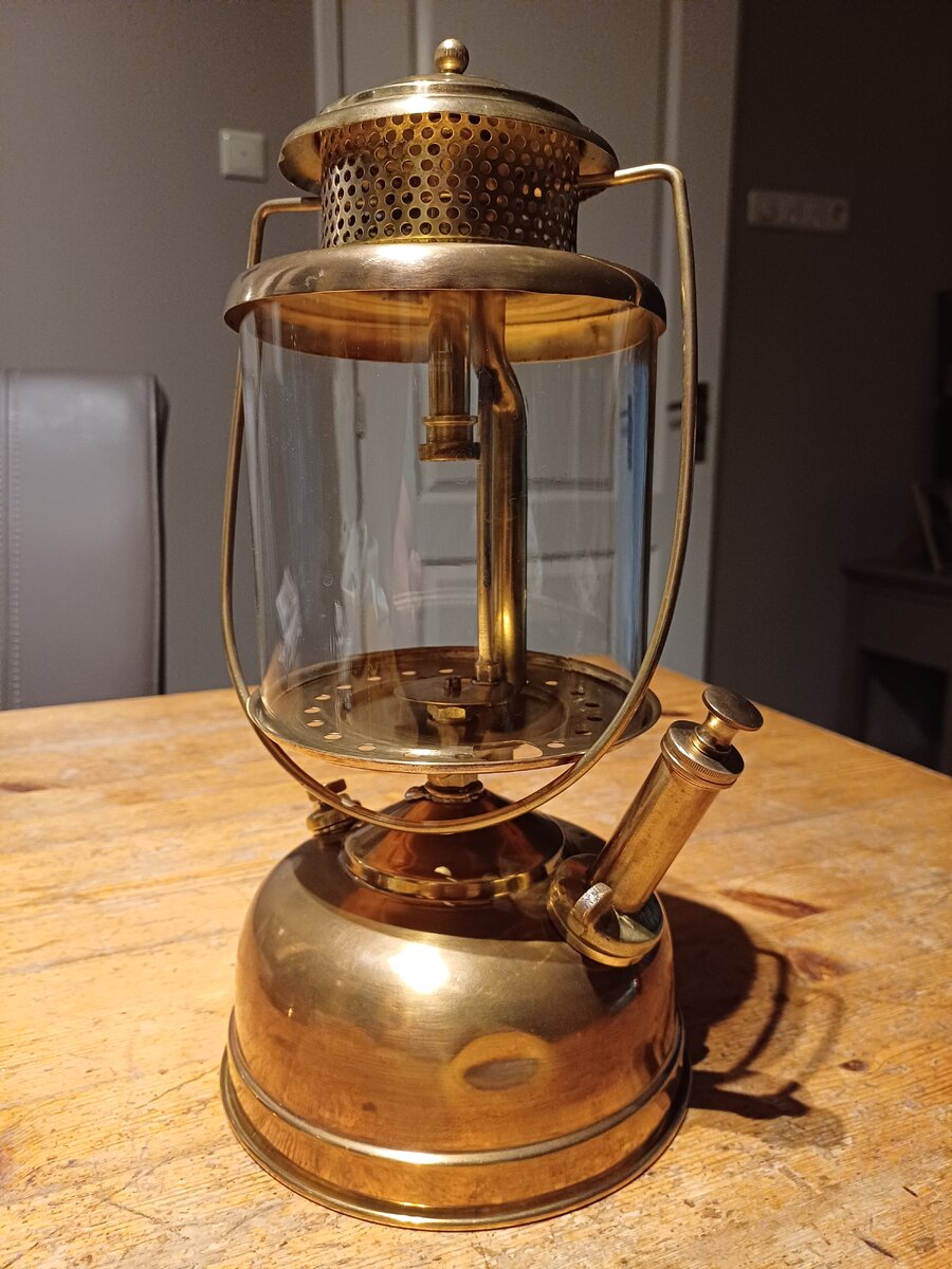

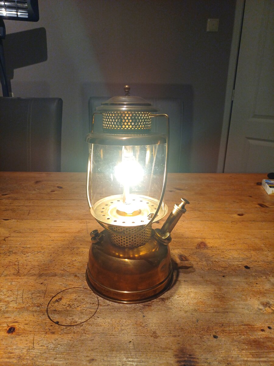

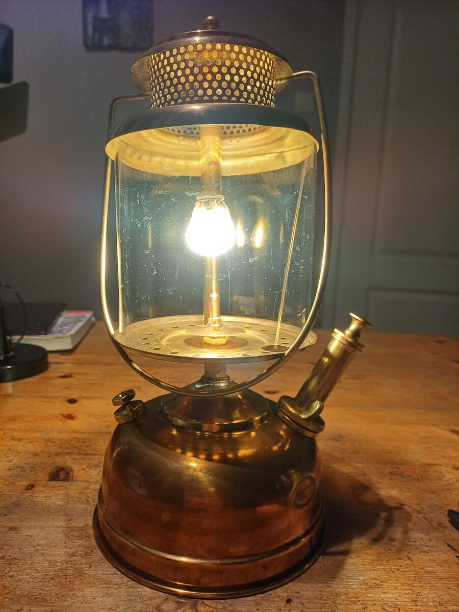

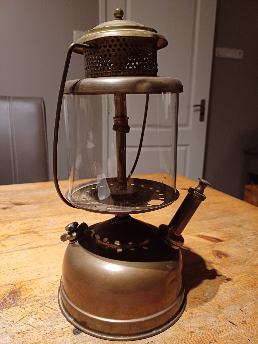

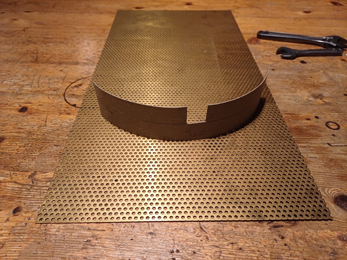

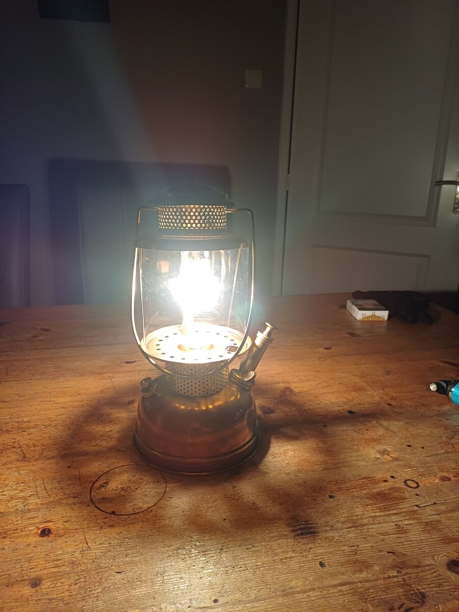

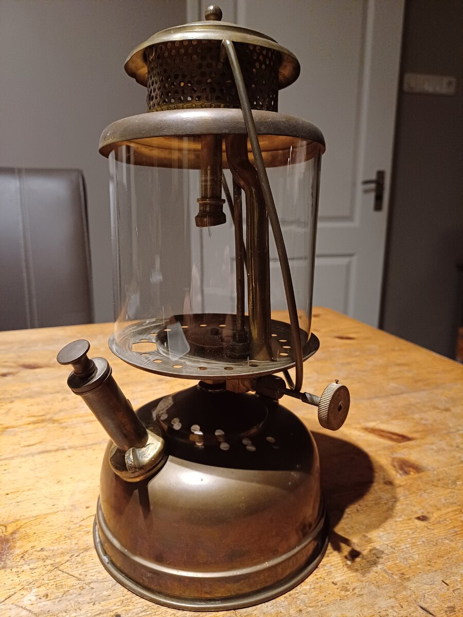

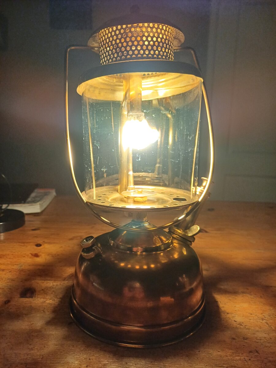

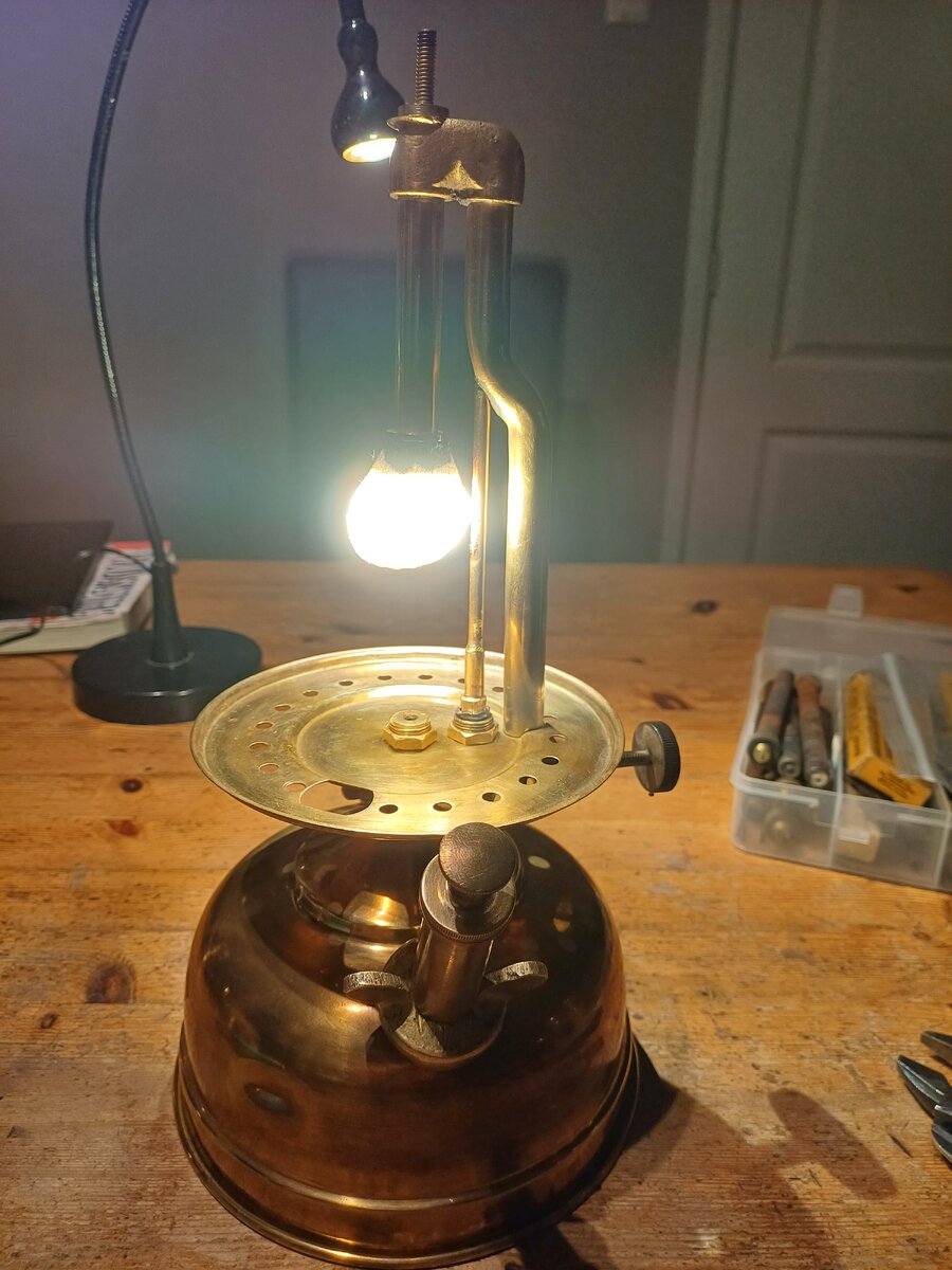

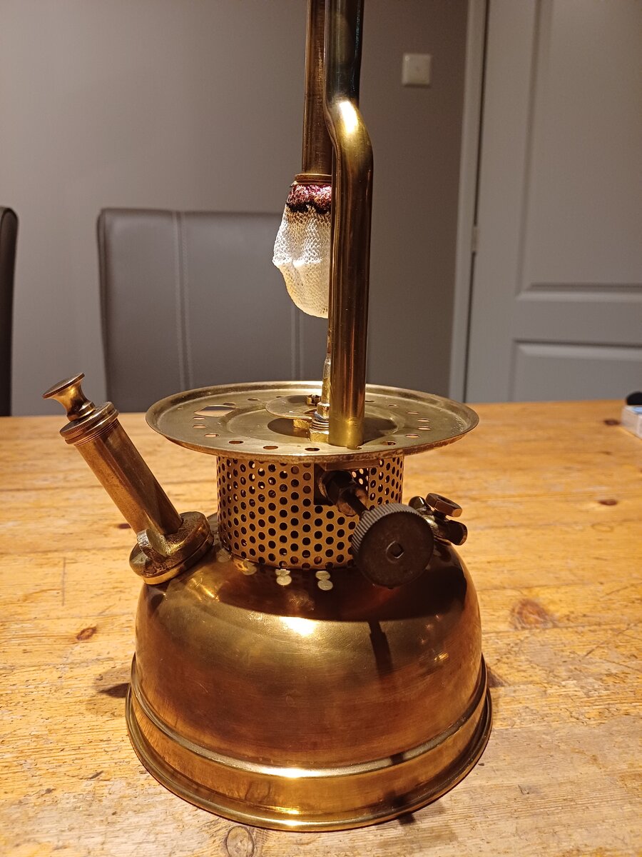

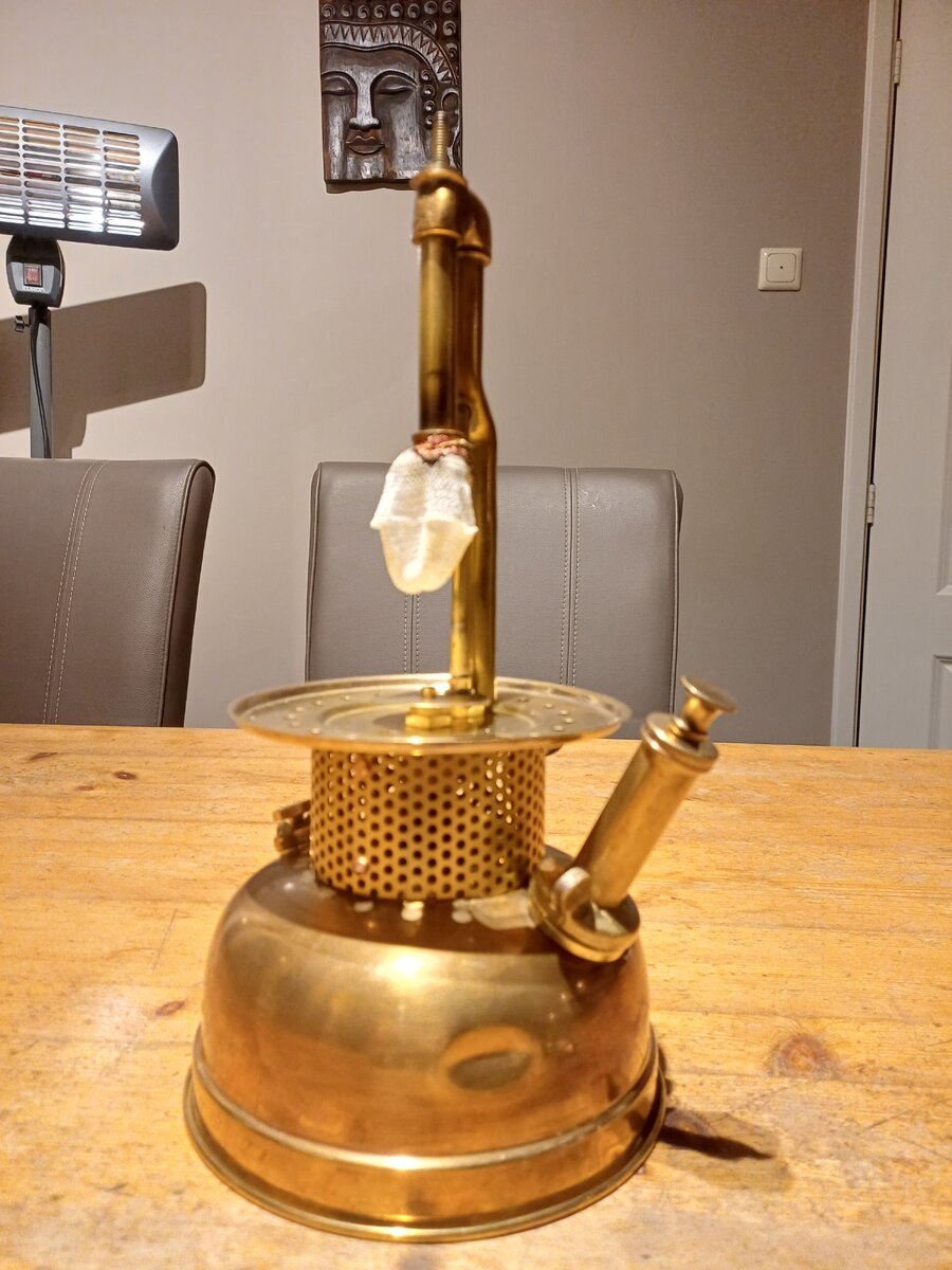

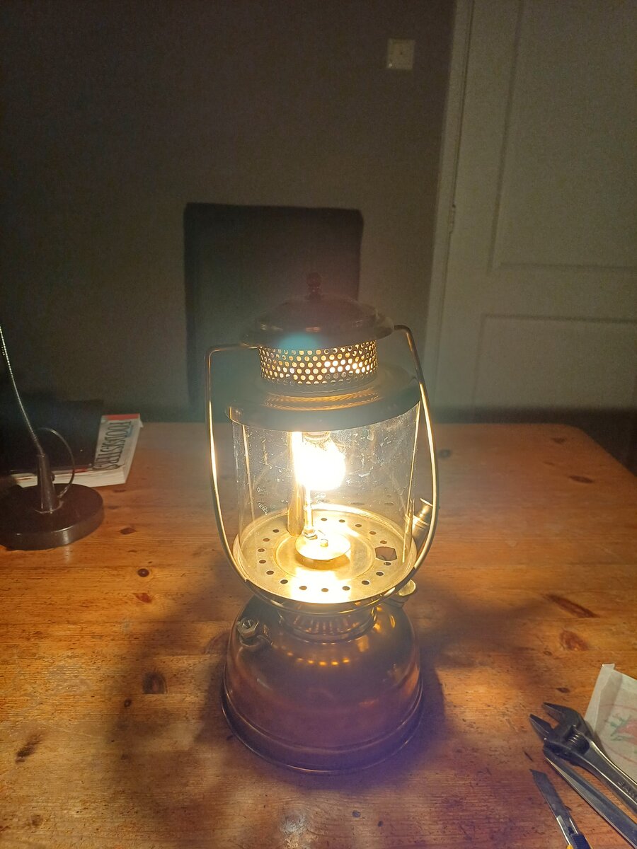

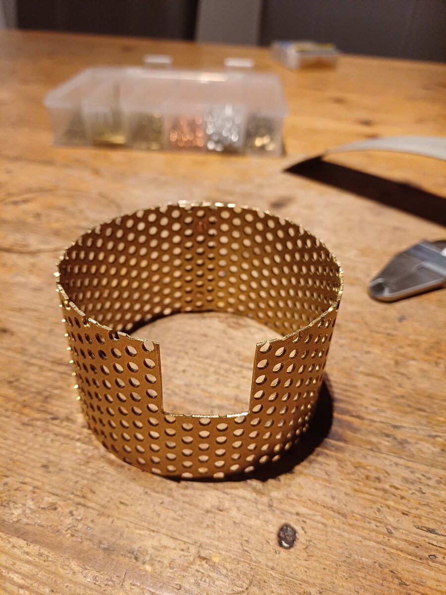

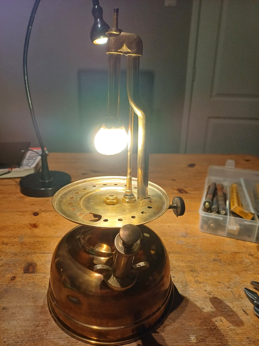

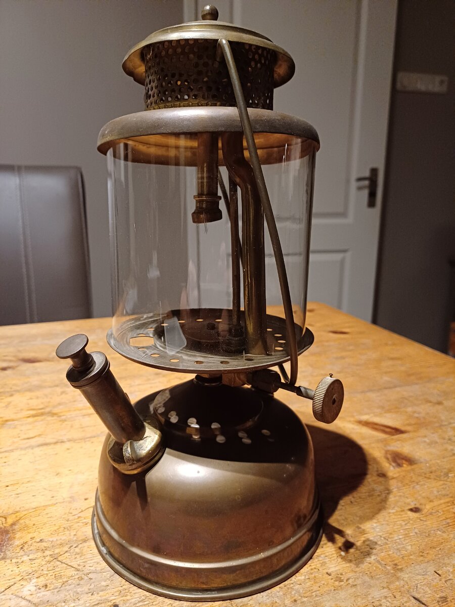

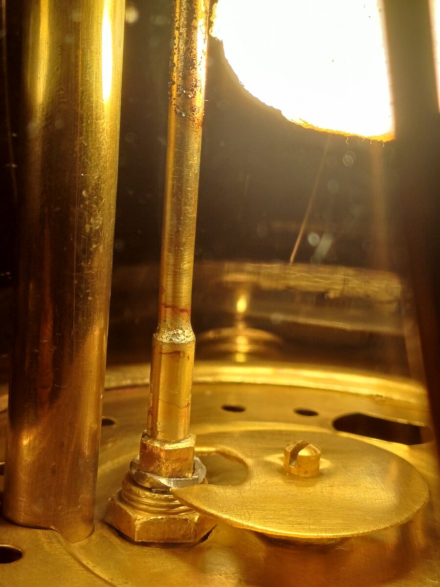

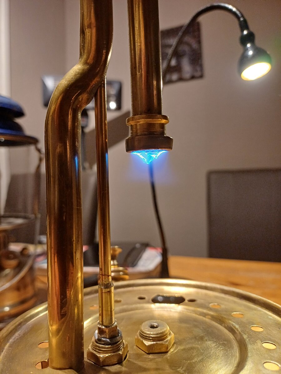

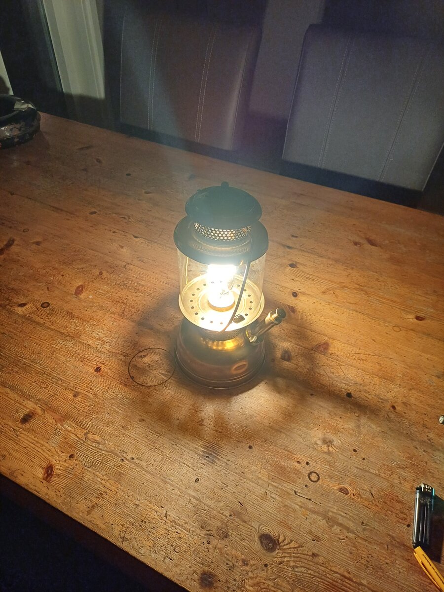

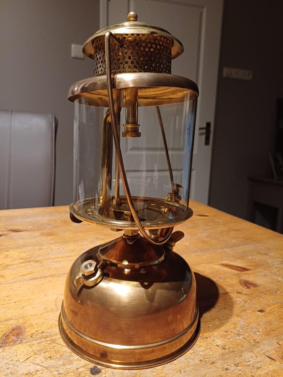

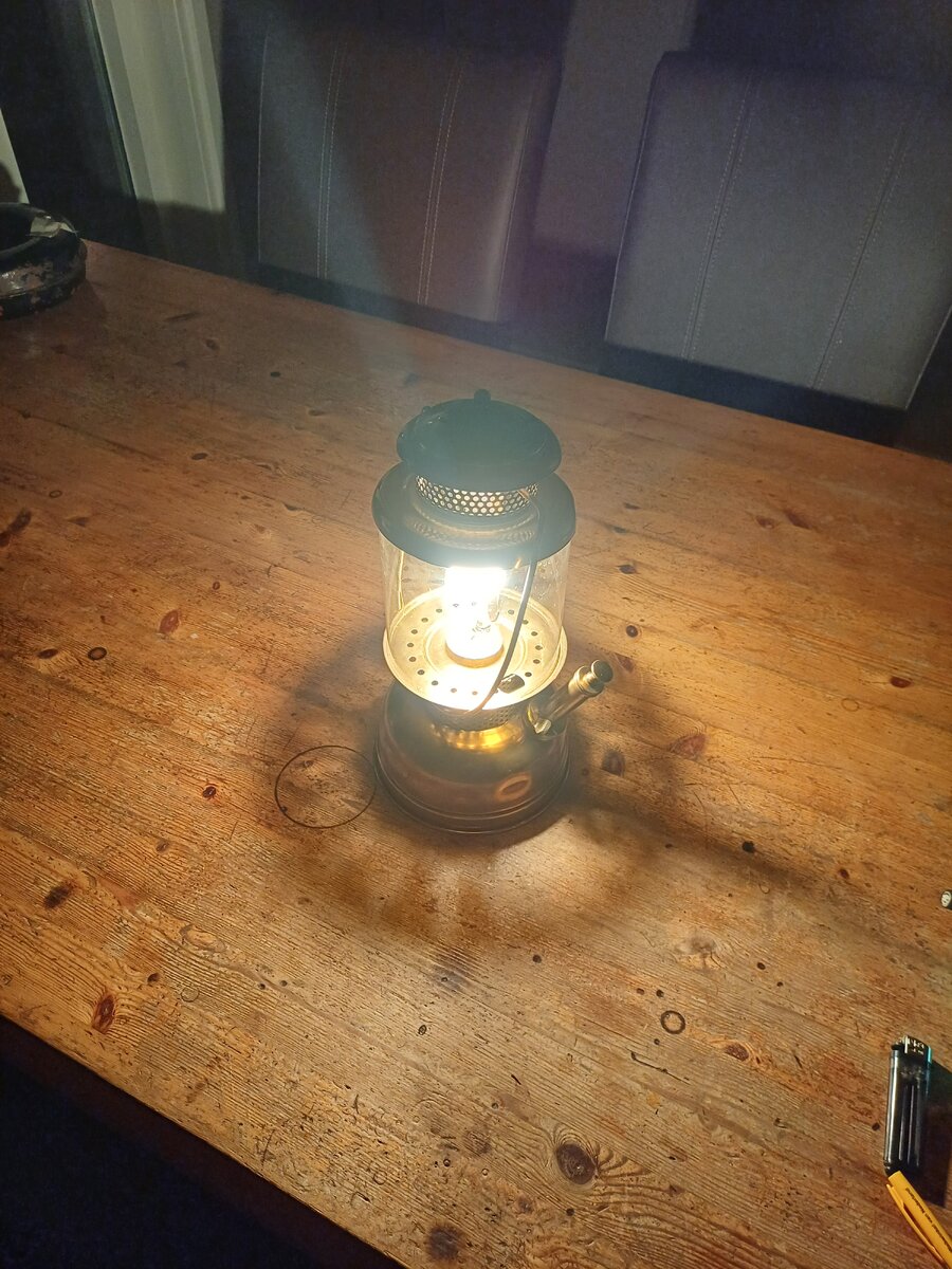

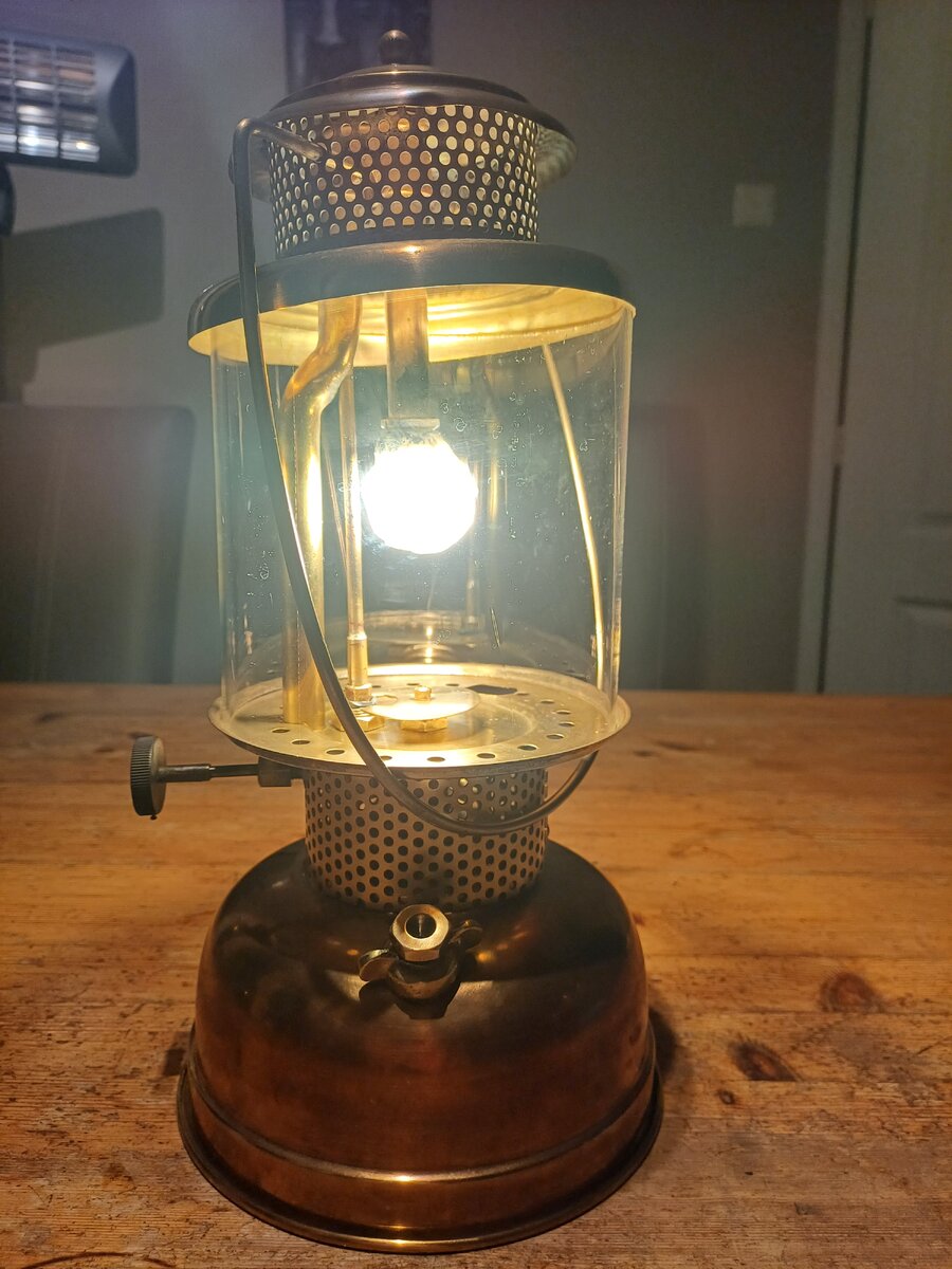

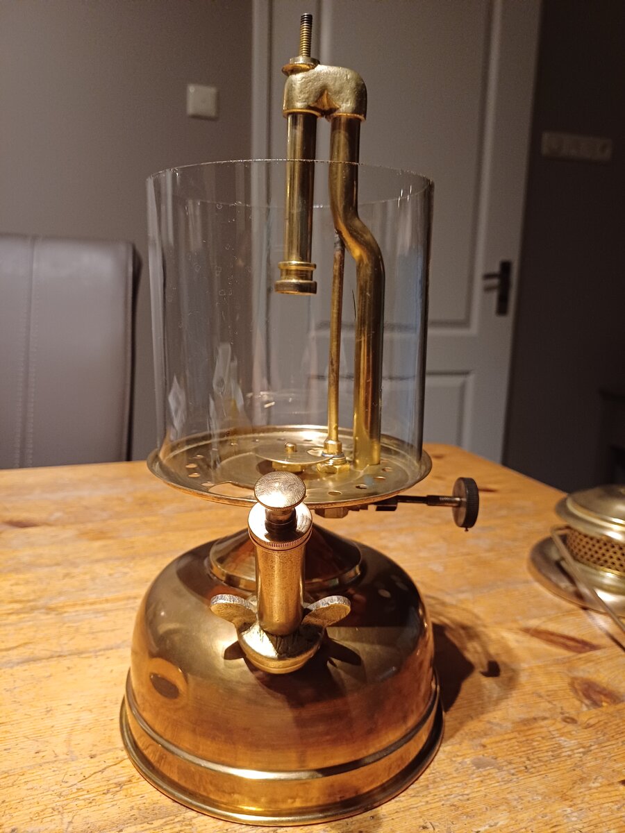

    Here's is my second Blesk from Poland. This one was only missing the collar. The generator wasn't working, and there was a little hole in the tube. I had to make a new one from a long AGM generator. Now it's working fine. The missing collar was made from a perforated brass plate with round holes, like the original

    Nice lantern, @Johan Osinga.
    I can’t quite tell from the photos, but is there any writing on the fibre control wheel?
  3. Johan Osinga
    Feb 24, 2015
    95
    Hello, @Tony Press
    There's no writing on the control wheel.

    I forgot to mention that the lamp now burns on gasoline. I haven't tried it with kerosene, as it didn't seem like a kerosene lamp to me.
  8. ROBBO55
    4,252
    It's a nice lantern, congratulations :thumbup:
  9. Tony Press
    10,890
    @Johan Osinga
    I notice it has a pressure release valve on the filler cap, which is usual for kerosene lamps rather than gasoline ones.
    Neil McRae has Blesk listed in the Pressure Lamp Caralogue as “probably kerosene”, so he wasn’t certain.
  10. Johan Osinga
    Feb 24, 2015
    95
    @Tony Press.
    The only paper Neil has with a picture of the lantern, shows a little preheat torch inside the lantern. Enough to do preheating on a gasoline lantern, but I guess to short for a kerosene lantern.
  11. Camp numao Japan
    Jan 13, 2024
    264
    Japan
    It's been beautifully repaired and looks great!

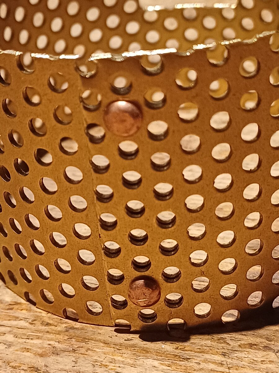

    Were the perforated sheet metal rivets used?

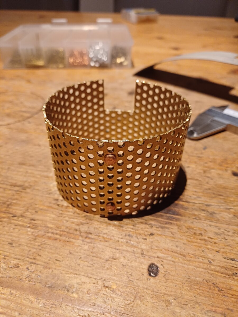

  12. Johan Osinga
    Feb 24, 2015
    95
    Hello @Camp numao,
    The rivets I used are made of copper.
    I have another Blesk lantern, so I could make a copy of the collar myself. The holes in the perforated brass sheet are the same as the original one. And to connect, there were used copper rivets.
    The picture shows the original collar.
  13. Camp numao Japan
    Jan 13, 2024
    264
    Japan
    They look almost identical.
    Amazing.:thumbup:
