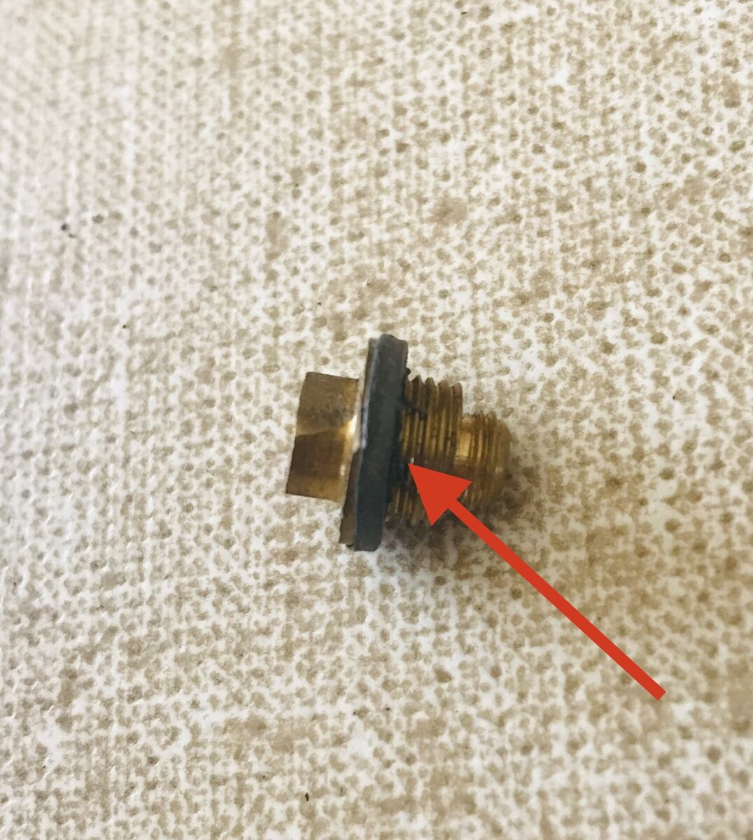

    The check valve (or NRV = non-return valve) on these blow torches should be pretty straight forward, and you probably don’t need to replace them.

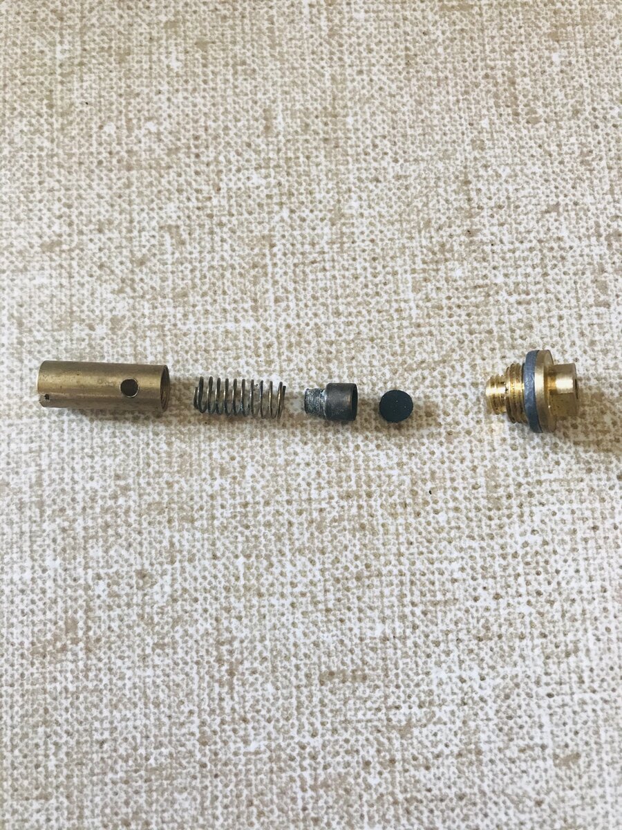

    Disassembled they should look like this:

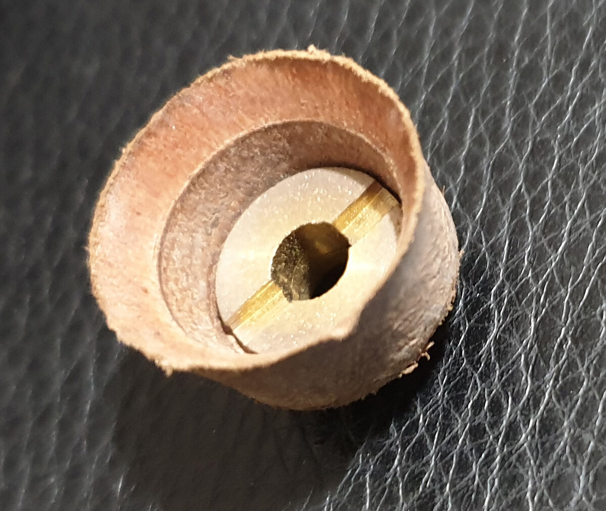

    You will need a lead or HDPE washer here:
    If your spring is a bit slack, just stretch it about 15%.
    Use good quality cork (not the modern rubberised gasket cork) or Viton to make the pip for your NRV. It must sit flat against the mating surface, and not have grit or dirt.
    Tighten the re-assembled NRV to tight but don’t force it.
    Good luck

    All good advice, especially the cork replacement. I had to replace the cork pip in my Petromax 821. Viton just won't cut it!
    6,386
    Well, I have to confess I’ve never had any problem using high quality Viton in an NRV. The trick is to make sure the surfaces are clean and square on, with no grit.
    Cork is a bit more forgiving in that when wet with fuel it will “give” more than Viton does. But good quality cork is hard to come by these days.

    Companion kerosene blowlamps are generally 1 US pt (Model 42) or 2 pt (Model 43). The fibre washer that fits the pump assembly to tank is between 25 and a max of 27mm OD and 21.2mm ID. You will need to replace the filler cap washer (23mm) and viton is best but any rubber will work for a while but deteriorates quicker. You will need a pricker for the jet.
    The NRV pip is 0.166" diameter and is fundamentally a common size used in Austramax Brand lanterns or even say Veritas 350 lanterns. The lead washer on the NRV is the same as is on common stoves such as Primus, Burmos or Radius ones at about 12.5mm OD and 7.75mm ID. The examples Tony has provided above are excellent and give you the idea of what is involved. The pump tube is a smidgeon under 17mm and the pump cup washers usually come in a small mounted assembly but other equivalents can work too. The fettlebox, advertised top right on this site should be able to assist.

    Check for leaks first and check the pump is not rising after you pump it, if it is then you have a problem. Half fill the fount (tank) and then make sure it is WELL preheated and pointed away from your car, just in case. Good luck.

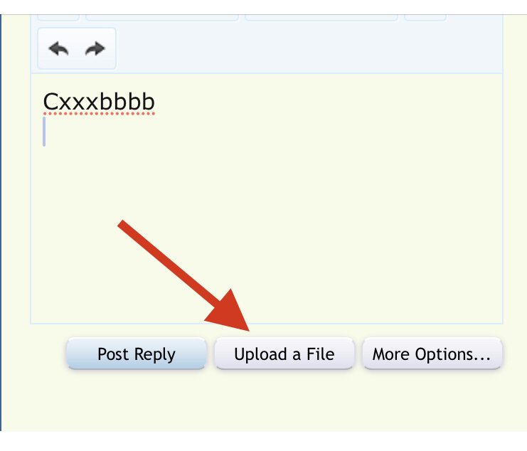

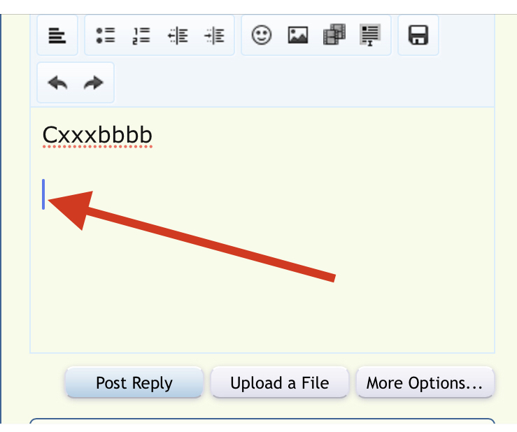

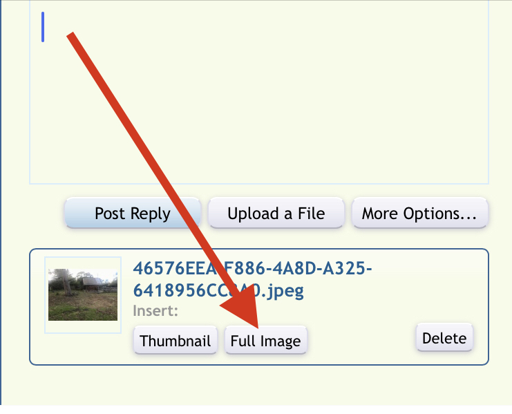

    To upload photos:
    1. Click on the “Upload a File” button at the bottom of the dialogue box.
    2. Load your photo from your file.
    3. Place it where you want by putting the curser at that point.
    4. Click on “Full Image”.

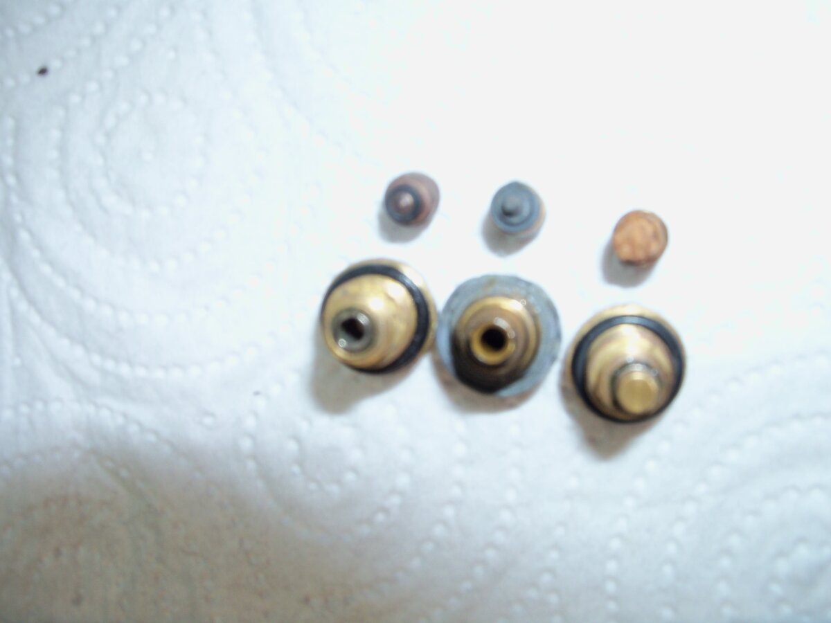

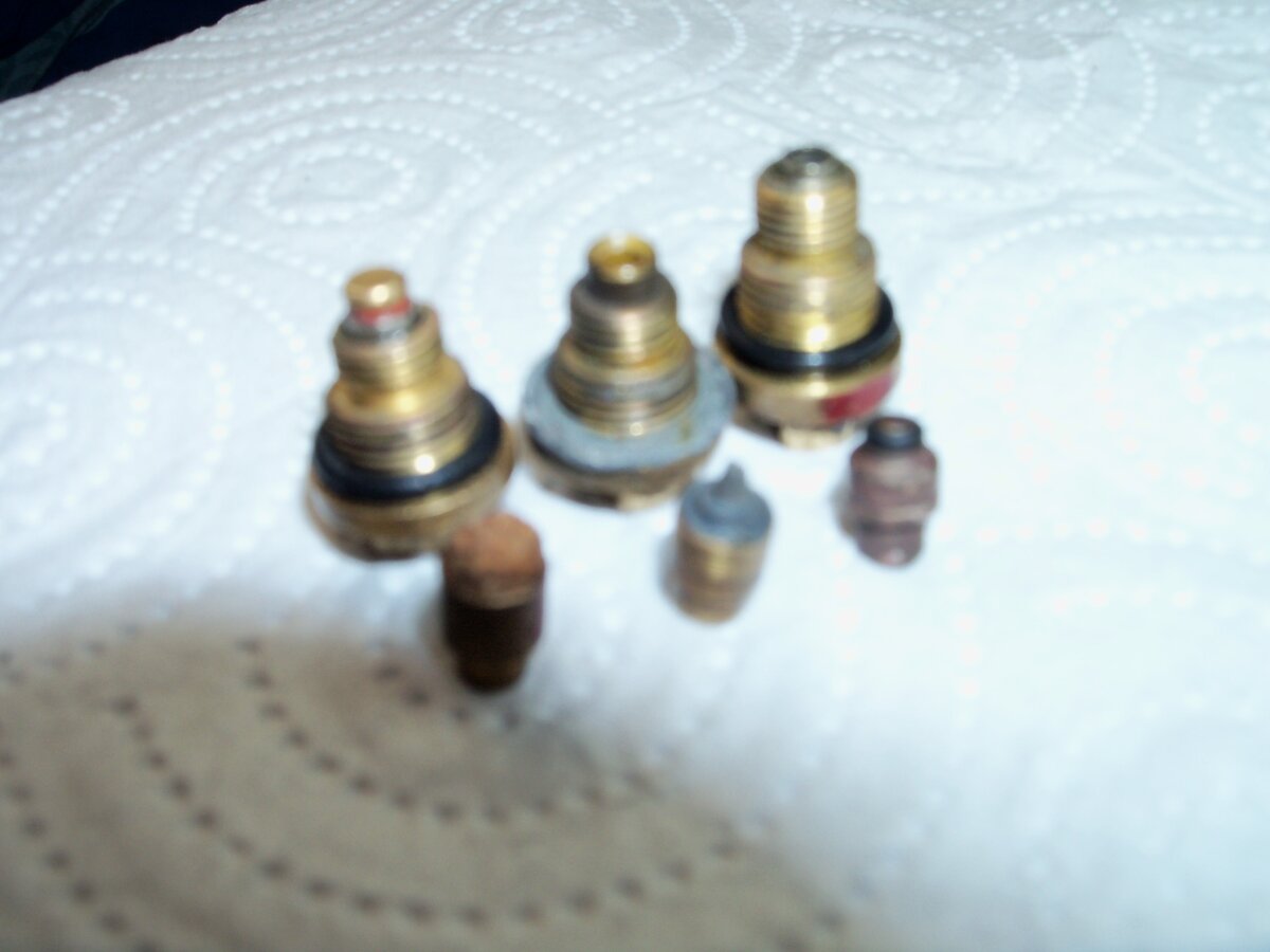

    Sorry Tony I stuffed up putting the photos up please feel free to delete them. You might be able to see the three different end nuts for the NRVs. One has a brass disc on the end (no air can go through this one! ). Another one has a brass end machined for a needle. And the third one has a stainless steel sleeve through it (a bit sharp on the end) The three brass "pip" holders - one has the cork, another is a machined brass nipple with a thin rubber ring around the base and the last one is a non brass needle. Not to worry I might have to put them back in the shed till I can find some new NRVs Cheers for now.

    Over the weekend, I’ll look what I have in my shed...

    Thanks Tony but don't worry I'm going to my uncles place he has some in his shed. Many thanks
