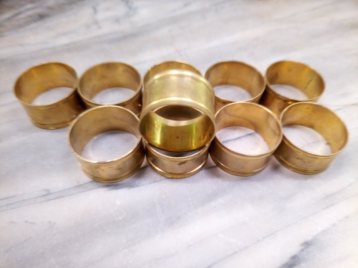

    I was in my local charity outlet and these came my way.
    Some of them will be made into pre-heater cups, the others will be kept for future projects.

    Lucky find. So what were they originally intended for?

    Look like crimp rings for plastic pipe.

    Napkin rings??? :-k
    I like your thinking :thumbup:... lookin forward to seeing to seeing the finished fettle!

    @podbros wins the prize. It's a set of 10 napkin rings and the lady literally gave them to me as she didn't think anyone would want them! They'll be carefully split into two rings, a base will be added and a tube fixed in the middle. When that's done I will drill out the middle of the tube and clean everything up.
    I'll try to post some photos of the process.
