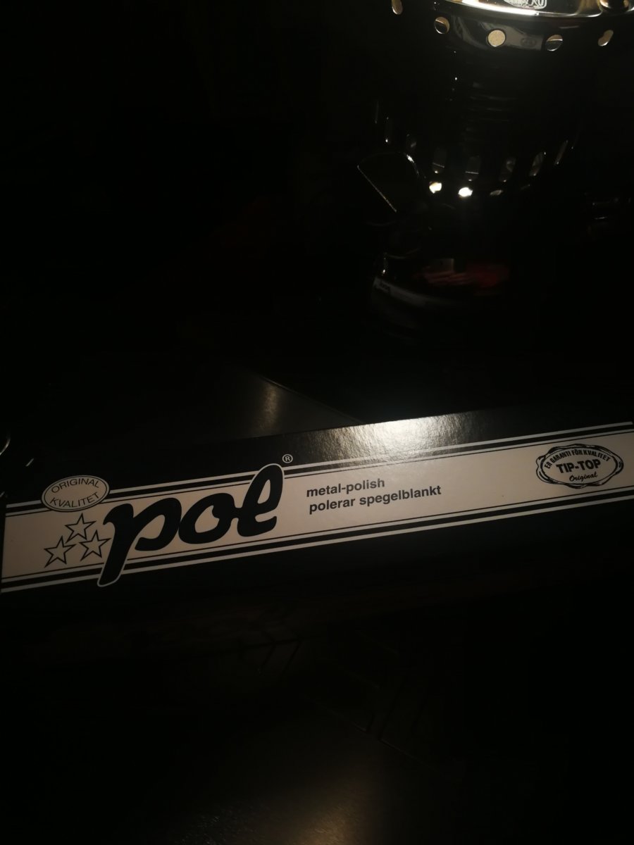

  17. Matti Kucer
    Matti Kucer Sweden Subscriber
    Mar 4, 2018
    167
    Sweden
    I guess you all want to save the plated surface so I'd like to recommend the "POL" metal-polish which does not harm the surface.
    Regards Matti
