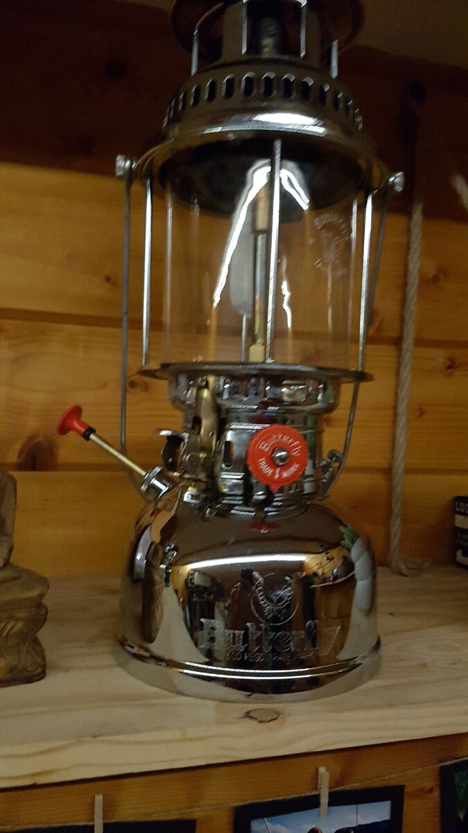

    Hi everyone, I just registered to this forum in hope to find some spare parts or information for my newly acquired Butterfly brand pressurized lantern. (I think its the Petromax copy #828?)
    Does anyone know where to get parts like the leather cup for pump, gaskets, seals etc?
    Thanks in advance
