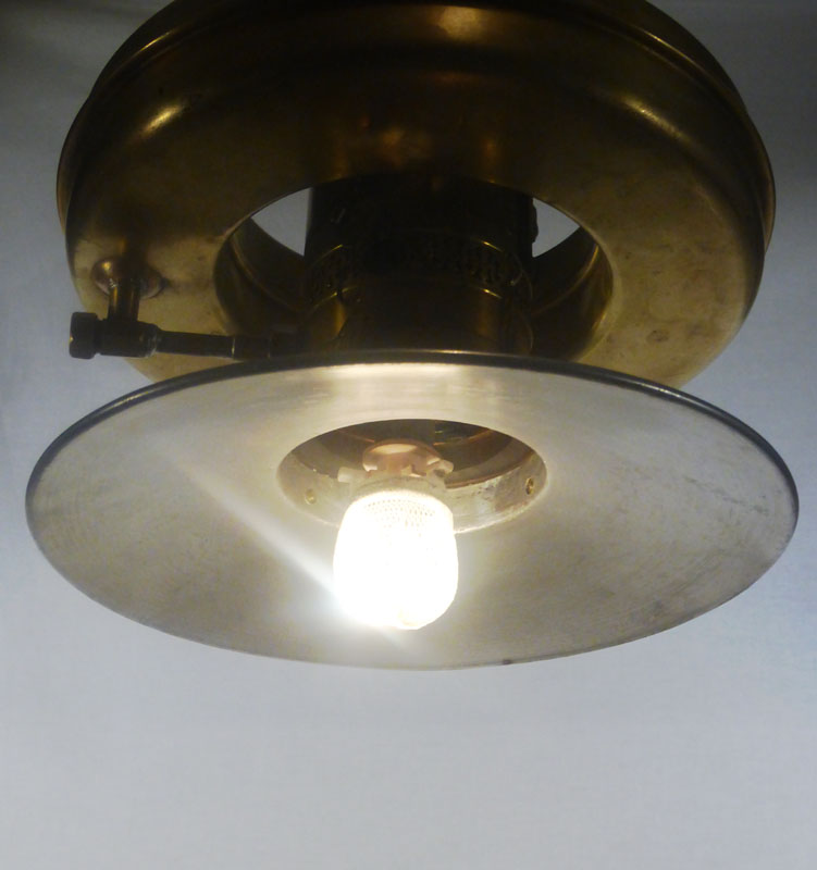

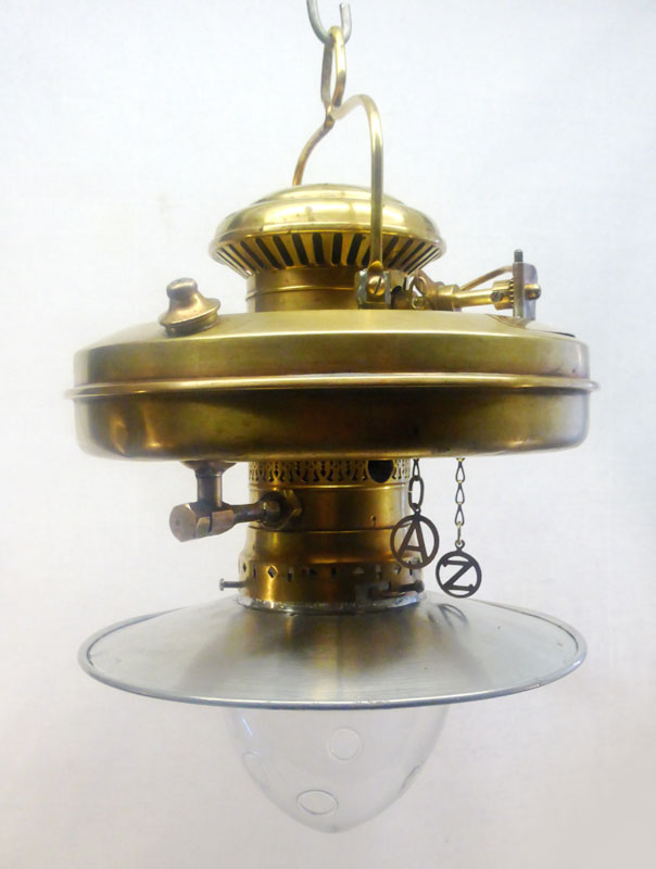

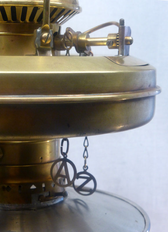

    Hi all,
    This alcohol donut lamp has been stored in my "cold case" box for maybe twelve years. The tank was cracked and several burner parts were destroyed or missing. A couple of years ago I found a scrappy sibling and now I have tried to puzzle the parts together. It is a kind of puzzle as there are many parts and the burner case is very tight. I also had to make a new fuel feed tube as the original had a crack. Finally got all the pieces together and got it to shed light again, maybe after 110 years of its birth.
    This is a Hugo Schneider HASAG alcohol donut "Lipsia" lamp for domestic use indoors.
    Could be find in a 1910 Hasag catalogue ( Jürgen Bredenstein hytta.de) and also in the 1911 Goldberg catalogue. A very sophistic alcohol fed lamp with an integrated automatic pump filling a pre heater cup. Ca. 100 CP according to catalogue info and a nice looking small donut lamp. I have searched Hugo Schneider Hasag patents for this lamp, but struck no luck!
    /Conny
    Lipsia lamp.jpg Lipsia parts.jpg Lipsia tank  logo.jpg Lipsia valve with chains.jpg Lipsia vent and valve.jpg Lipsia vent and valve 2.jpg Lipsia lamp from above.jpg Lipsia burner nozzle and rigid mantle.jpg Lipsia Bunsen flame.jpg Lipsia lamp lit mantle.jpg Lipsia lamp lit.jpg Lipsia lamp and 1910 catalogue image Hytta.jpg Lipsia catalouge 1910.jpg lipsia.jpg Lipsia Goldberg 1911.jpg
