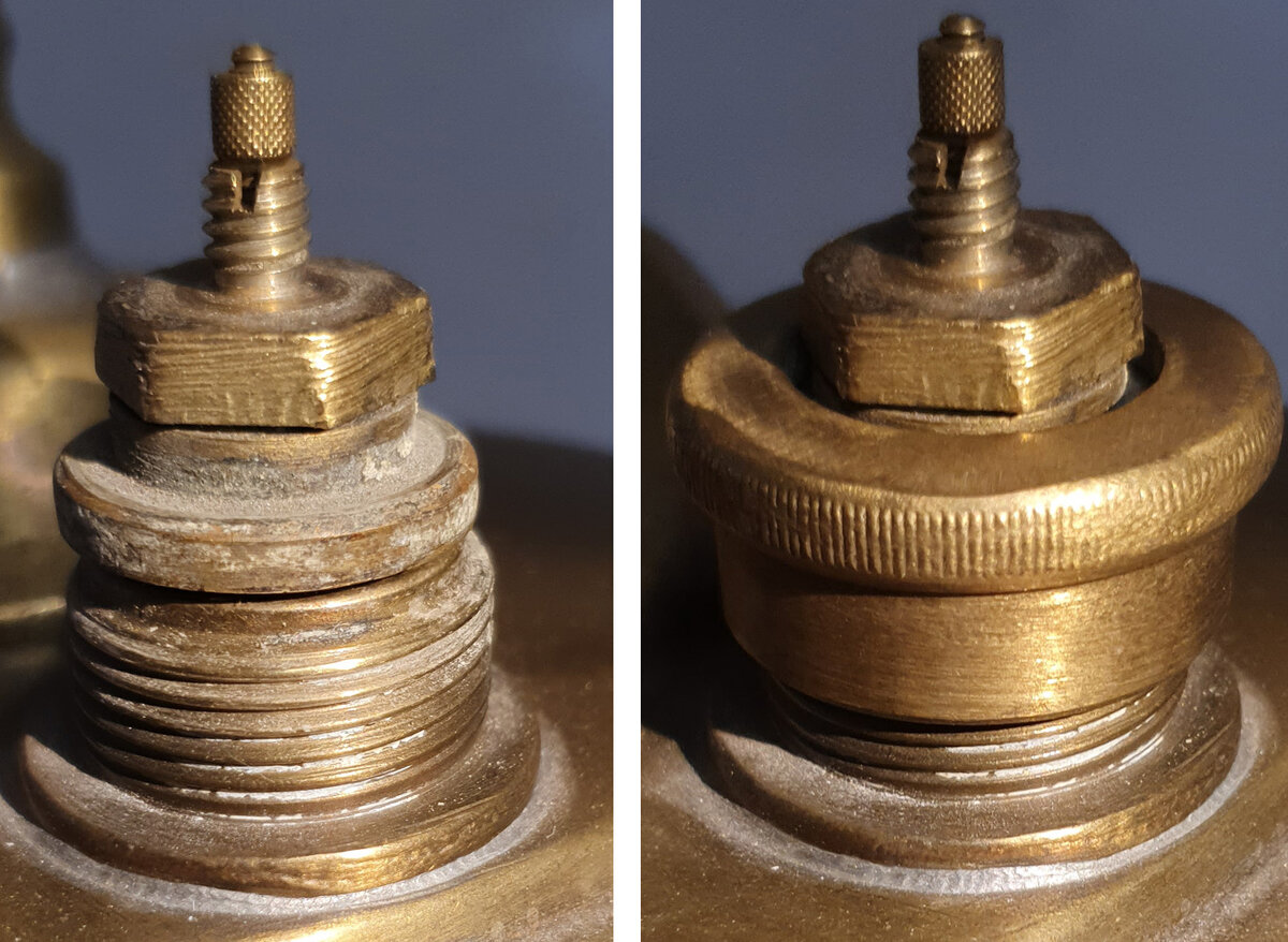

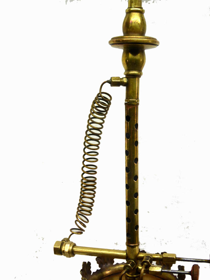

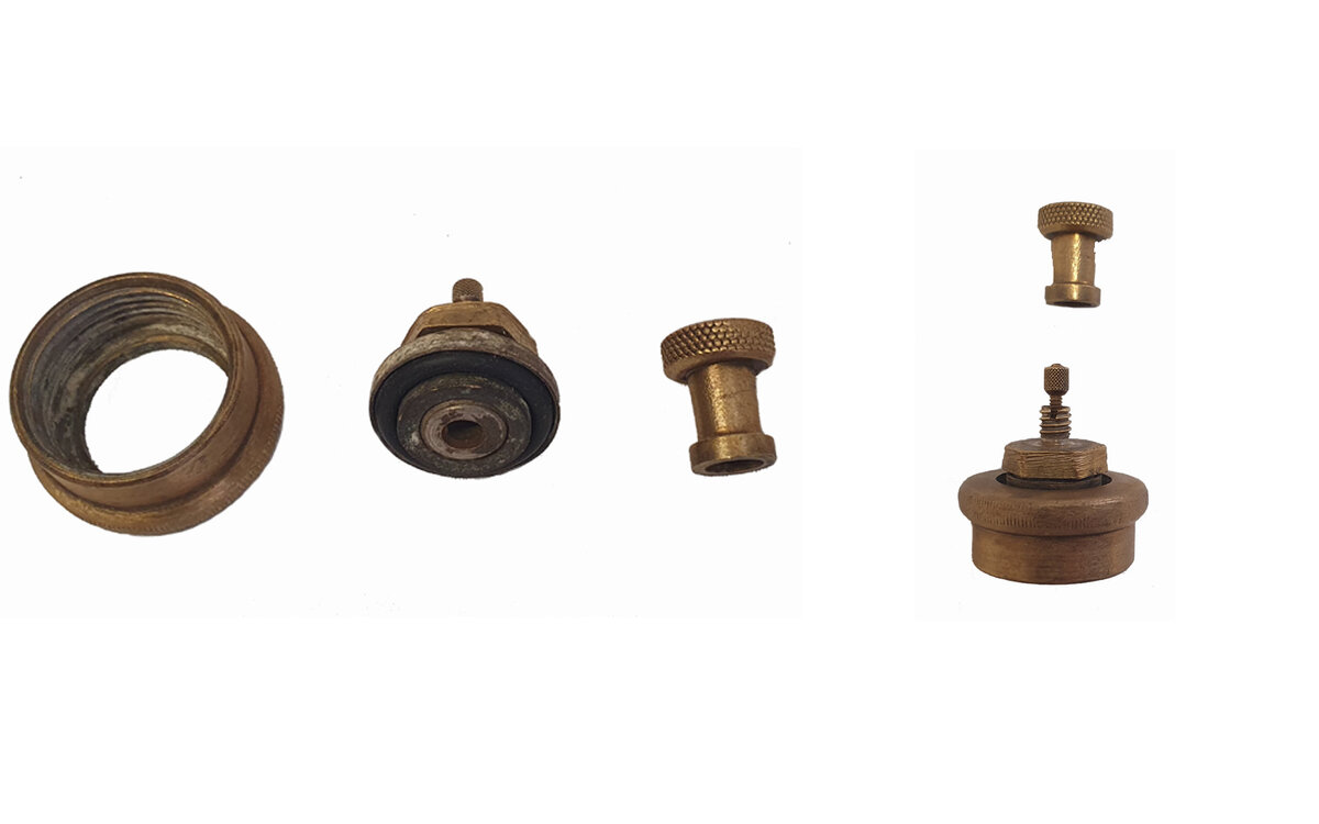

    This lamp came to me with a scarred and gold metal painted surface. Everything (except the cleaning needle) was painted, even the jet. A couple of big cracks and multiple small ones.
    I had a problem to unscrew the gauge, but managed eventually and could see the original state of blackened, scarred and corroded surface that was there before a previous owner had painted it with gold metal paint.
    This is one of the hardest restoration I have done and will not bore you with the details. On the bright side - everything except the shade was there; so after working with this one nearly two weeks now, I can finally say it is up and running.
    This is 150 CP gasoline fed burner and uses an alcohol fork type asbestos torch for pre heating. It ran pretty good, but I think a bit too rich (some yellow in the Bunsen flame).
    The shade is an original Lilor one, and was an option among other gas type shades used for this burner and lamp.
