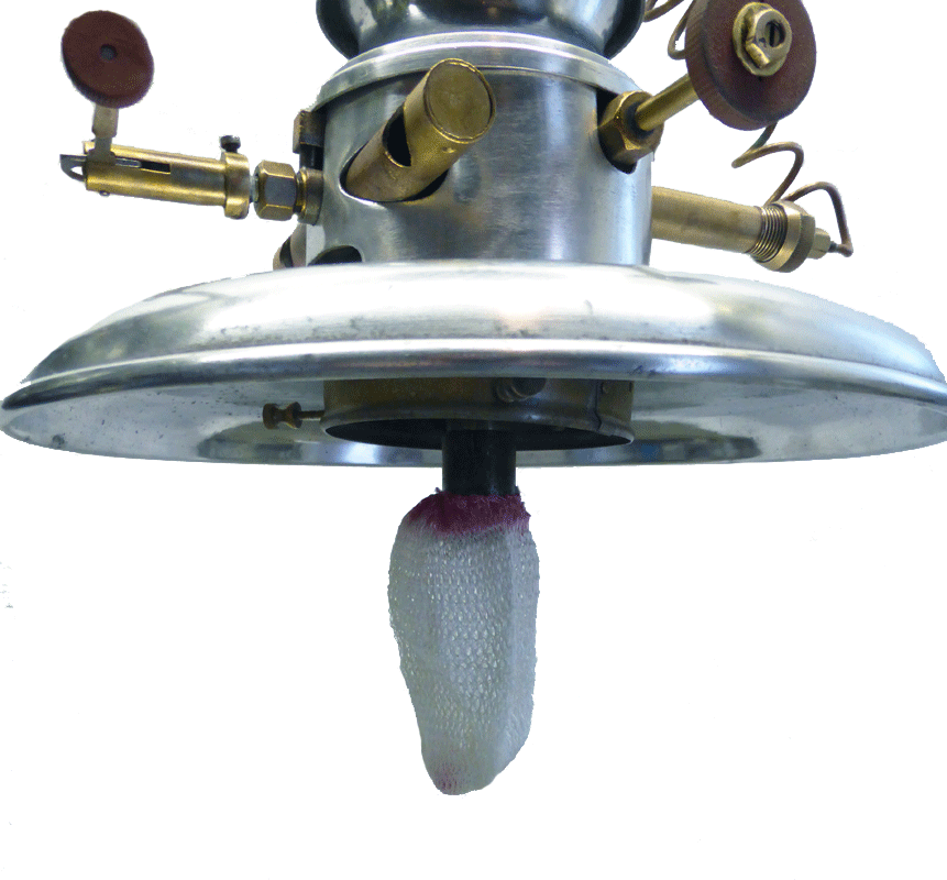

    Hi all,
    This is an outdoor gasoline fed hanging lamp , Succes 104 Autonome, from the French company of Guenet & Abbat. Probably made around mid 1920,s and is said to give 160 CP light output.
    The burner head on this lamp is the 103 "Bec Forain" and has the same burner components and parts as the "Bec 101 bis", seen here 1930 Bec Succes 101 bis holllow wire lamp . As always, when it comes to lamps and burners from the Succes brand .... many parts and many joints to connect. After many working hours, it turned well in the end. OK performance, although maybe not optimal! This is the only example of this lamp, I know of!
    /Conny
    Succes 104 hanging lamp.jpg Succes-104-hanging-lamp-par.gif Succes 104 hanging lamp tank.jpg Succes 104 hanging lamp burner head.jpg Succes-104-hanging-lamp-manometer.gif Succes-104-hanging-lampfuel.gif Succes-104-hanging-lamp-bur.gif Succes-104-hanging-lamp-jet and needle.gif Succes 104 hanging lamp mantle.gif Succes 104 hanging lamp pre heating.jpg Succes 104 hanging lamp Bunsen flame.jpg Succes 104 hanging lamp lit mantle.jpg Succes 104 hanging lamp lit 2.jpg Succes-104-hanging-lamp-lit.gif
    catalogue pages ……….. Succes-103-104--catalogue-1.gif Succes 104 hanging lamp parts catalogue page.jpg

    @Conny C ... Thanks Conny for another remarkable presentation...
    I absolutely love these intricate and marvelous lamps you find... Just stunning...
    Is the main body some sort of Aluminium alloy? :-k

    The number of parts in the photos and catalogue is quite a wonder in itself. I expect that a very tidy workbench is required for success with the Succes. Congratulations on a fine effort.
    Is the preheater torch original to the lamp?

    @podbros Yes the burner casing and reflector is made of aluminium.
    @Tony Press The preheater torch is original for the Tito Landi burners.
