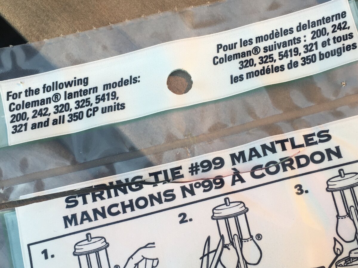

    I managed to get hold of some #99 mantles, correct for the model.

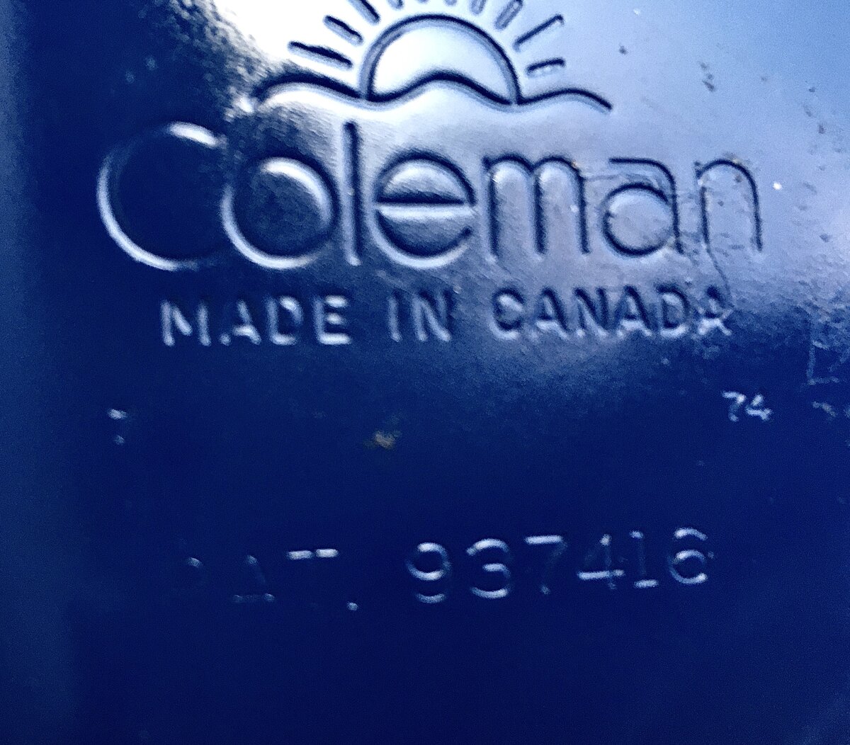

    So, replacing the missing label. Firstly, I photographed each of the five panels on my other 321 lantern. Obviously trying to get a shot of the label in its entirety would introduce extreme distortion and out-of-focus effects.
    48B9EAA9-2DD2-4C1F-9A5A-6655EADC3ED5.jpeg 17F7CC57-CF09-4521-9874-A136B213D1C8.jpeg 5B116B3B-439F-4B63-8606-483041269B92.jpeg C80DF8DD-CE2B-46E7-A752-241433F06C29.jpeg 636E353D-F8BA-4DE9-87BB-5ABEC89EAE38.jpeg
    I then assembled them, electronically, in a Word doc and printed the result (two of) on decal paper.
    I confess that before that successful example I got the colour balance wrong - too pale.
    Corrected on the final print.
    Waterproofing and durability of the label was ensured with a couple of coats of clear lacquer.
