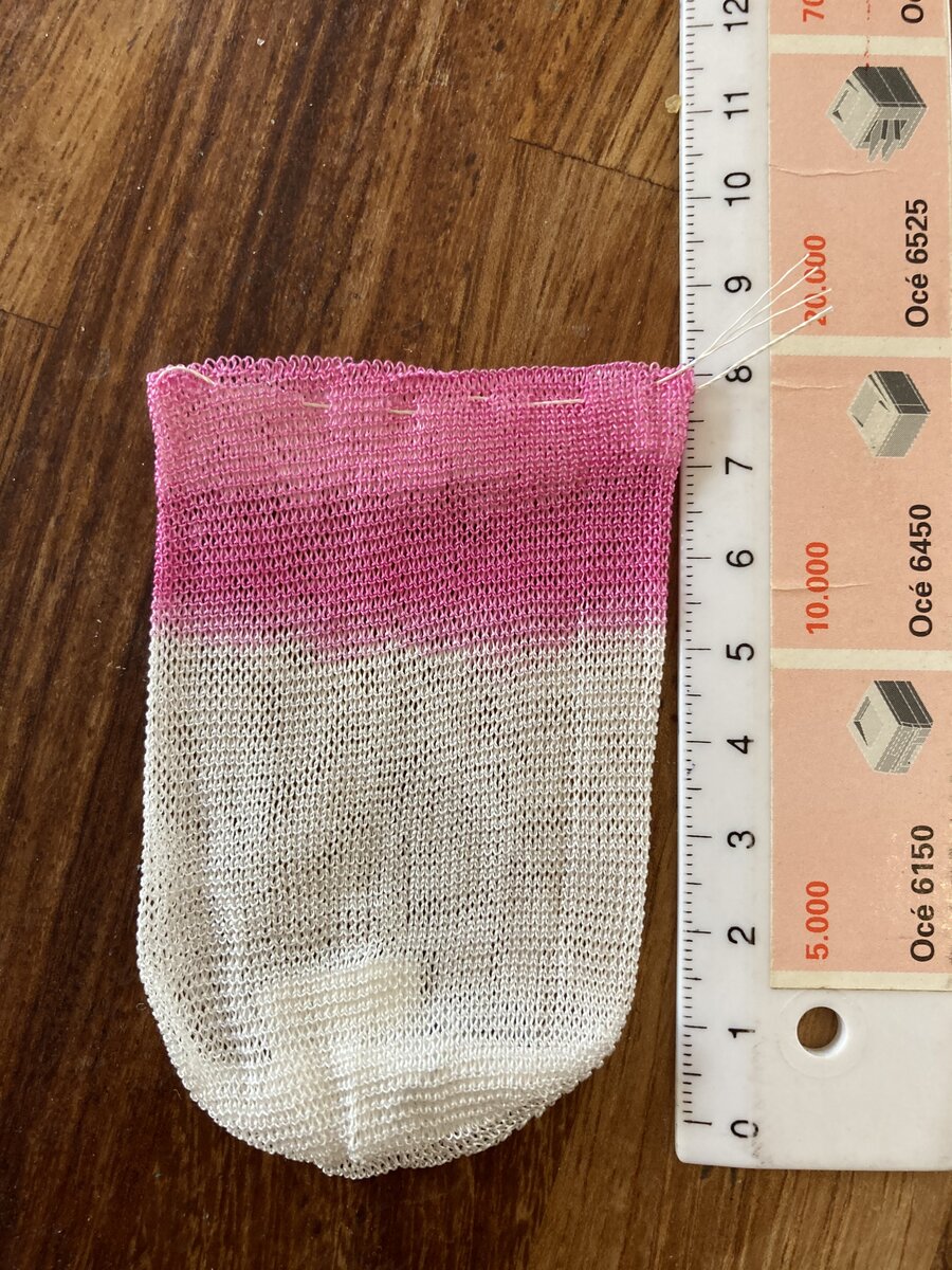

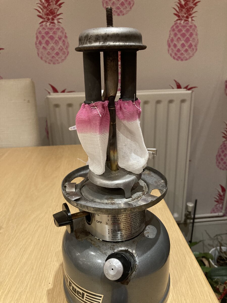

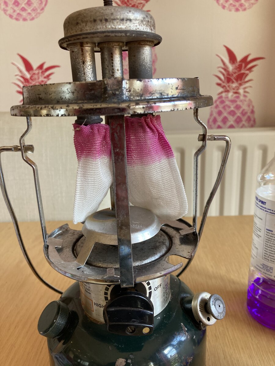

    I ordered these from a seller on Ebay - advertised as 8x6cm. At £3.17 all in for 10 I thought worth a try:

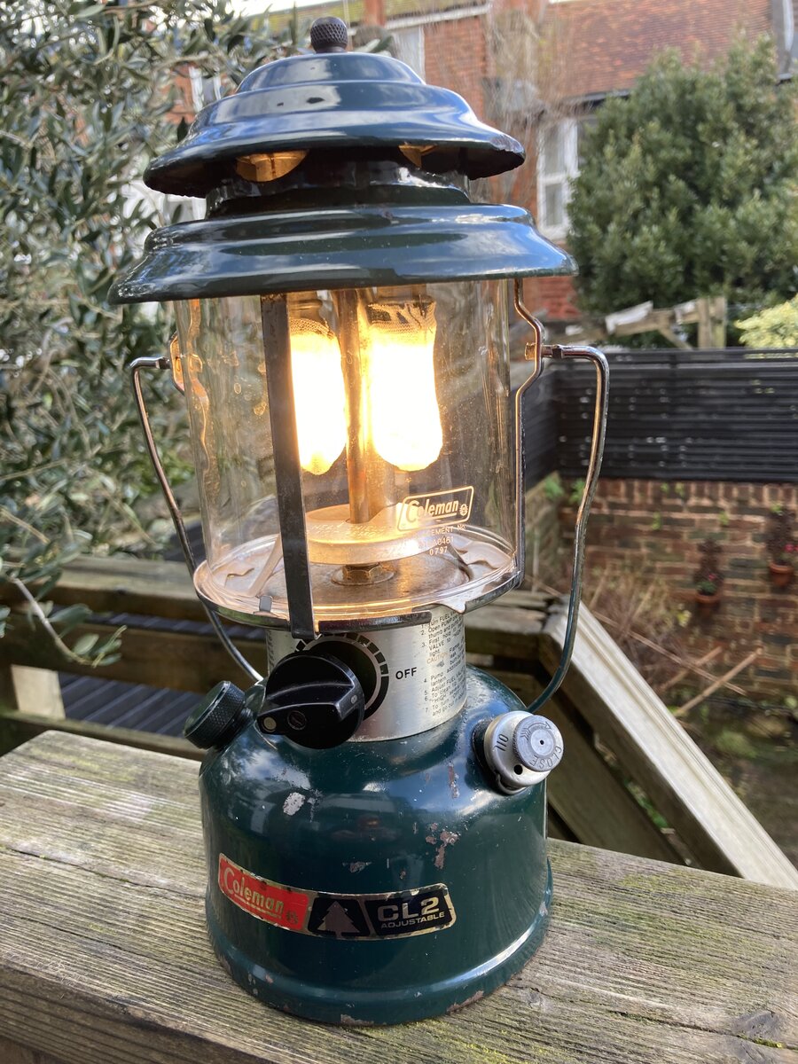

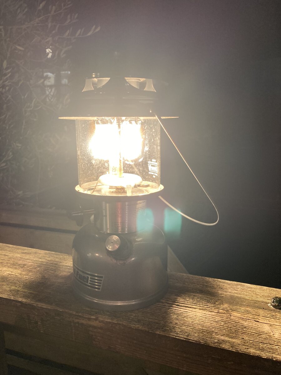

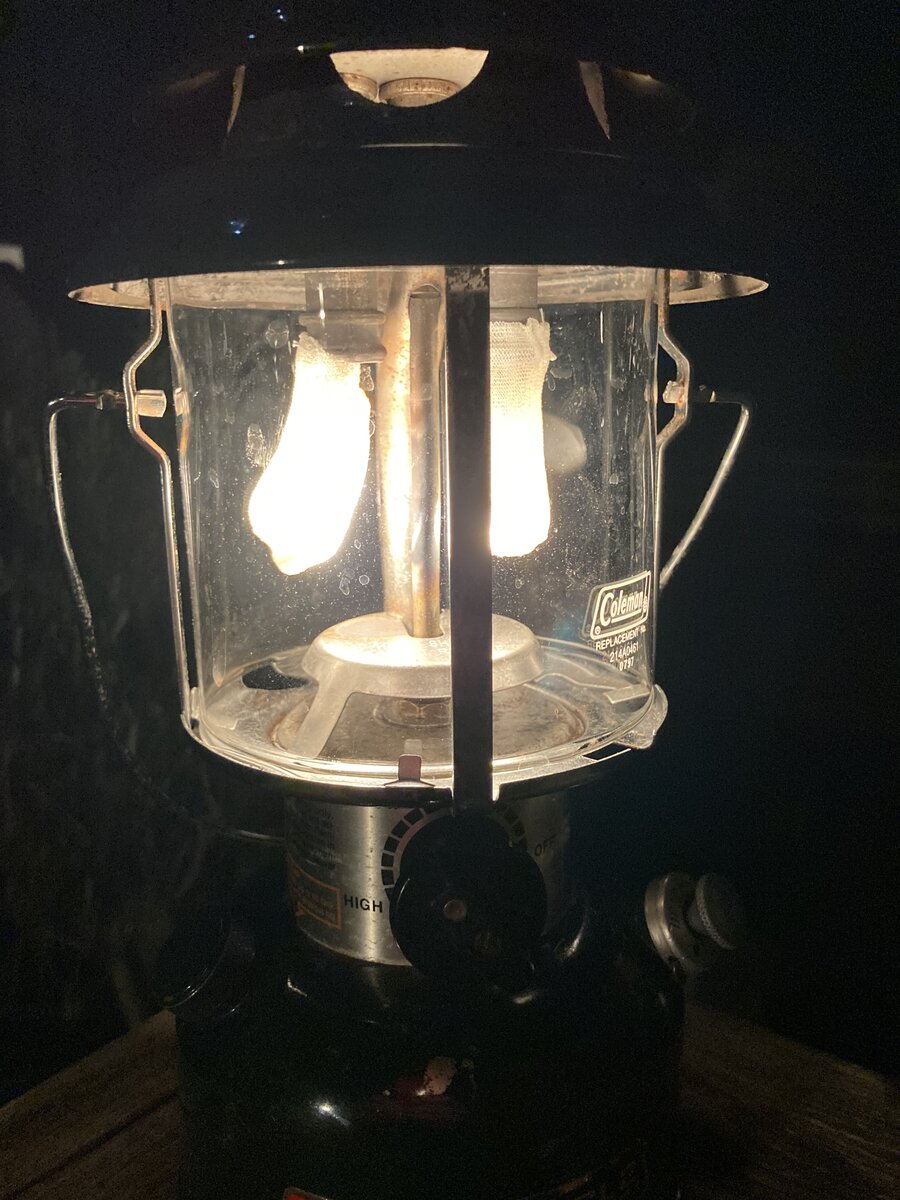

    The pictures tell the story. Short strings meant fiddly but not impossible to put on. I tried them on a 285 and a 288. I could have done better on the 288 but it works. They seem to end up slightly larger than the genuine Coleman #21. I have lit the 285 4 times with no apparent damage. Compared to the £8.00 per 4 that genuine spares seem to be sold for I am happy.

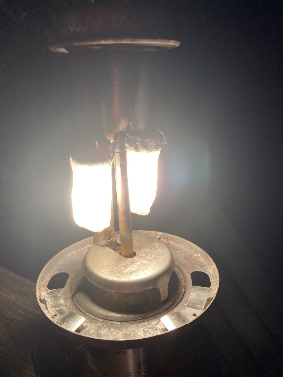

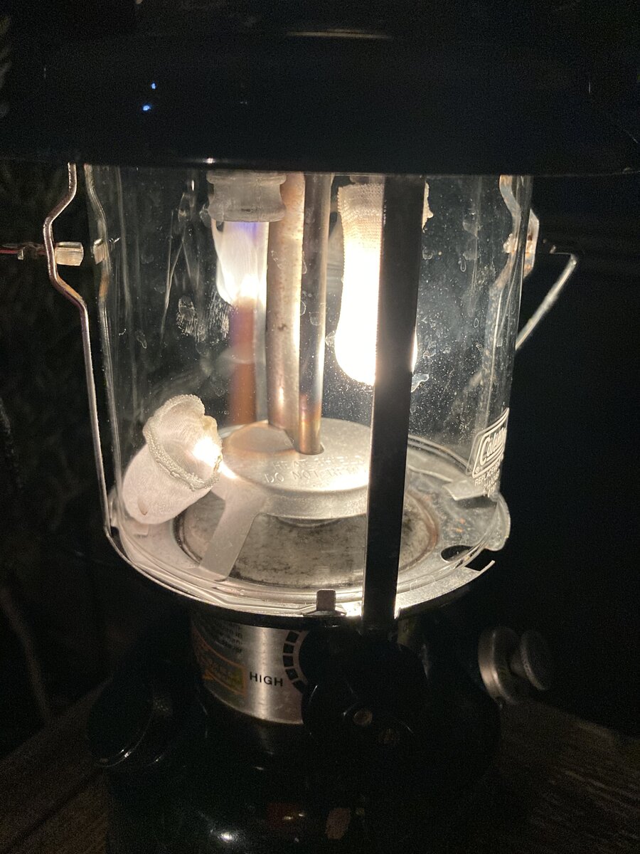

    After 10 re-lights the mantles on the 285 are still going well. Good light and I think easier to light. However the fiddly nature (and my fat fingers) led to one mantle on the 288 dropping off, after some disconcerting whistling noises...

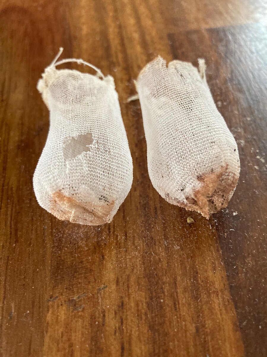

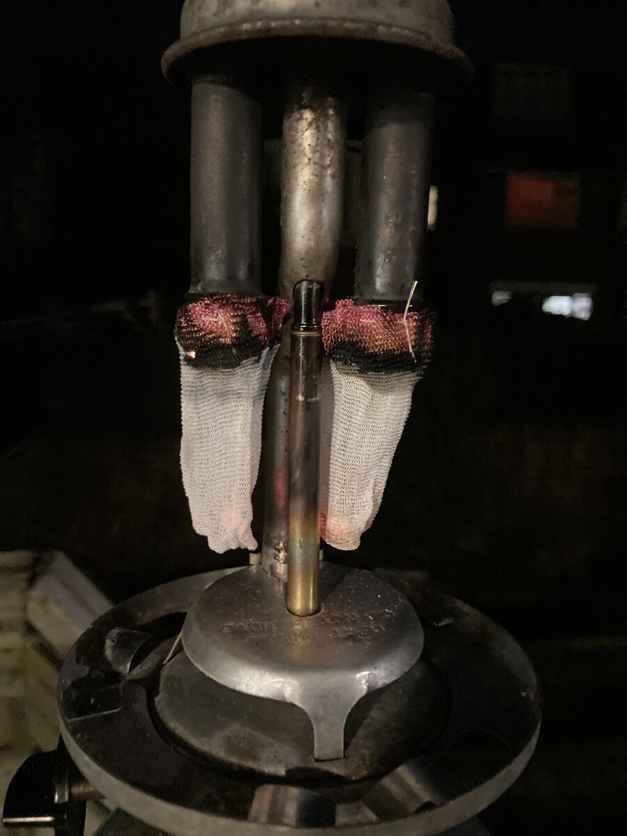

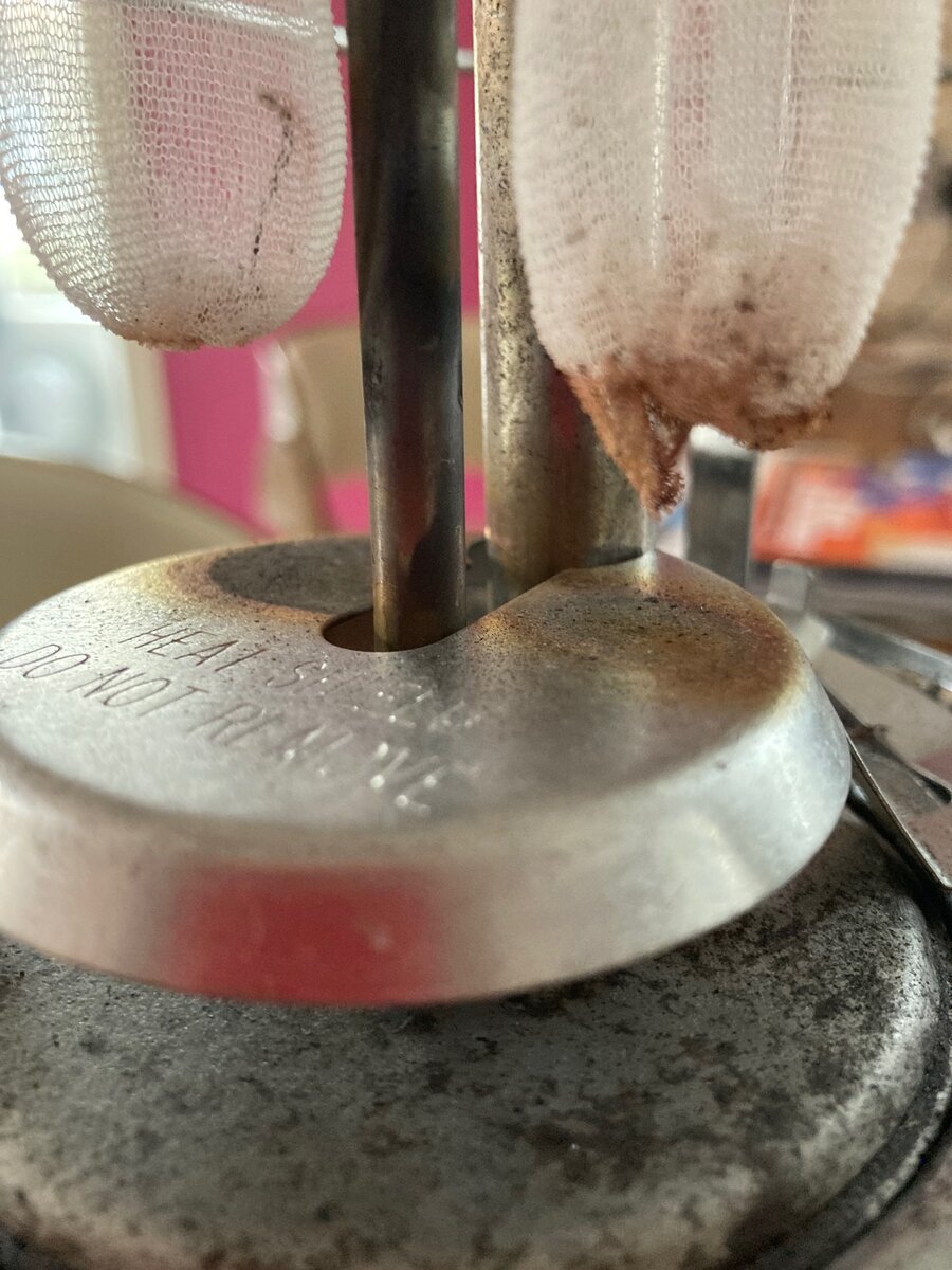

    So the mantles on the 288 have failed after about 35 hours. The check valve on the 285 died taking it out of the testing.
    As you can see on photo no2, one got thin on the sidewall, and the bottom blew out of another. Luckily my Yttrium 2C-HG Peerless mantles have arrived from New Zealand so I can try them next.

  16. ColinG
    3,212
    Eruuuuwwww! I've never need mantles go like that!

    I agree in terms of the price/convenience trade-off. If a catastrophically burst or holed mantle results in a cracked globe they cease to be a bargain.
    True, a quality mantle can develop a hole - many firings on hopefully - but ones I’ve had that have done so haven’t failed with such a gaping hole as that.
    Still, they didn’t wreck the globe on that occasion I suppose.
