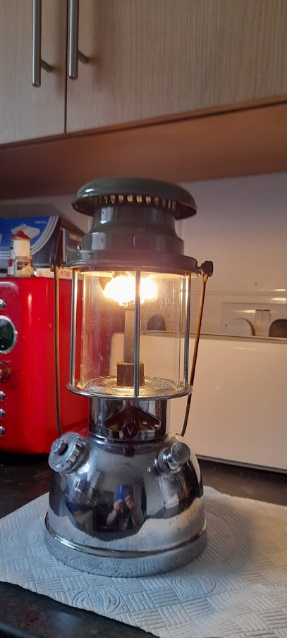

    After a successful fettle, using salvaged parts I fired up this Chrome Bialaddin 300X. I used a Tilley mantle which I find take a while to shape, but a lot brighter.
    I intend to use this lamp, hence the not too in-depth clean up. I couldn't get a Chrome Ventilator (yet), so used an old M1 Vent.

    That is very tidy

    :-k Was there a chrome ventilator?

    Apparently some folk got the brass ventilators plated, because I was wondering about that.....

    Nice to see it lives :thumbup:

    It's cleaned up nicely, Johnny. :thumbup:

    That’s looking good and a nice lamp for a user.
