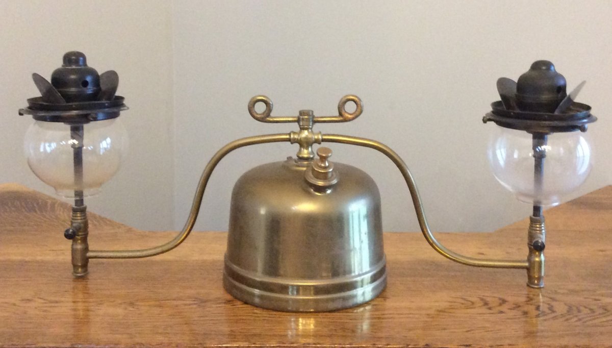

    DB85C145-6814-4645-9AAB-BF78F5453188.jpeg This was actually one of the first lamps I ever bought when I became seriously interested in Tilley lamps. Had to go all the way up to Thurso to collect it but well worth the trip. It’s just as I bought it with the silent burners fitted. Assume the tank had been stripped of its gold paint but it’s in good condition. And before anyone asks, no, I haven’t ever tried to light it!

    Hello Jean, the CL-72 was offered with either a highly polished and lacquered finish or a plated finish.
    Your lamp would have originally been fitted with the early XN control cocks and 169 vapourisers and a filler cap/pressure valve.
    The link below shows relevant information.
    They are a scarce lamp and it's a great find!:thumbup::thumbup:

    Of course I have all the correct parts Jeff but for some reason I’ve not even considered replacing what’s on the lamp. I’m quite fond of it as it is.

    My eyes might be playing tricks but it looks like it's plated.

    That is an outstandingly beautiful and desirable lamp, it does not get much better than this.
    Two matching batwing burners are worth a drive of any distance, as if a chandelier wasn't worth the effort on it's own.
    I do agree with Jeff on the early control cocks and 169 vaporiser's .
    I would add to Jeff's fantasy vision for this lamp that I would like to see a hanging frame made for it and finished off with some nice early teardrop globe's, the ones with the word Tilley in a large shield logo sandblasted into them.

    Thanks James, perhaps one day I’ll replace all the bits that are wrong. However, as for the globes you mention I don’t have any of those nor likely to find any I think. I’ve had a good look at the tank and think it may well have been lacquered but never plated. But the thought of a chrome plated version of this lamp has me drooling! Has anyone ever seen one?

    The first link below shows my example and it has the later XN control cocks fitted and one of those was fitted to the lamp when I obtained it, but in my opinion, Jean's example would have had the earlier XN control cocks fitted as they are from the same period as those early burners.
    There is an example of those early XN control cocks shown via the second link below, it's the first one on the left of the first photo.
