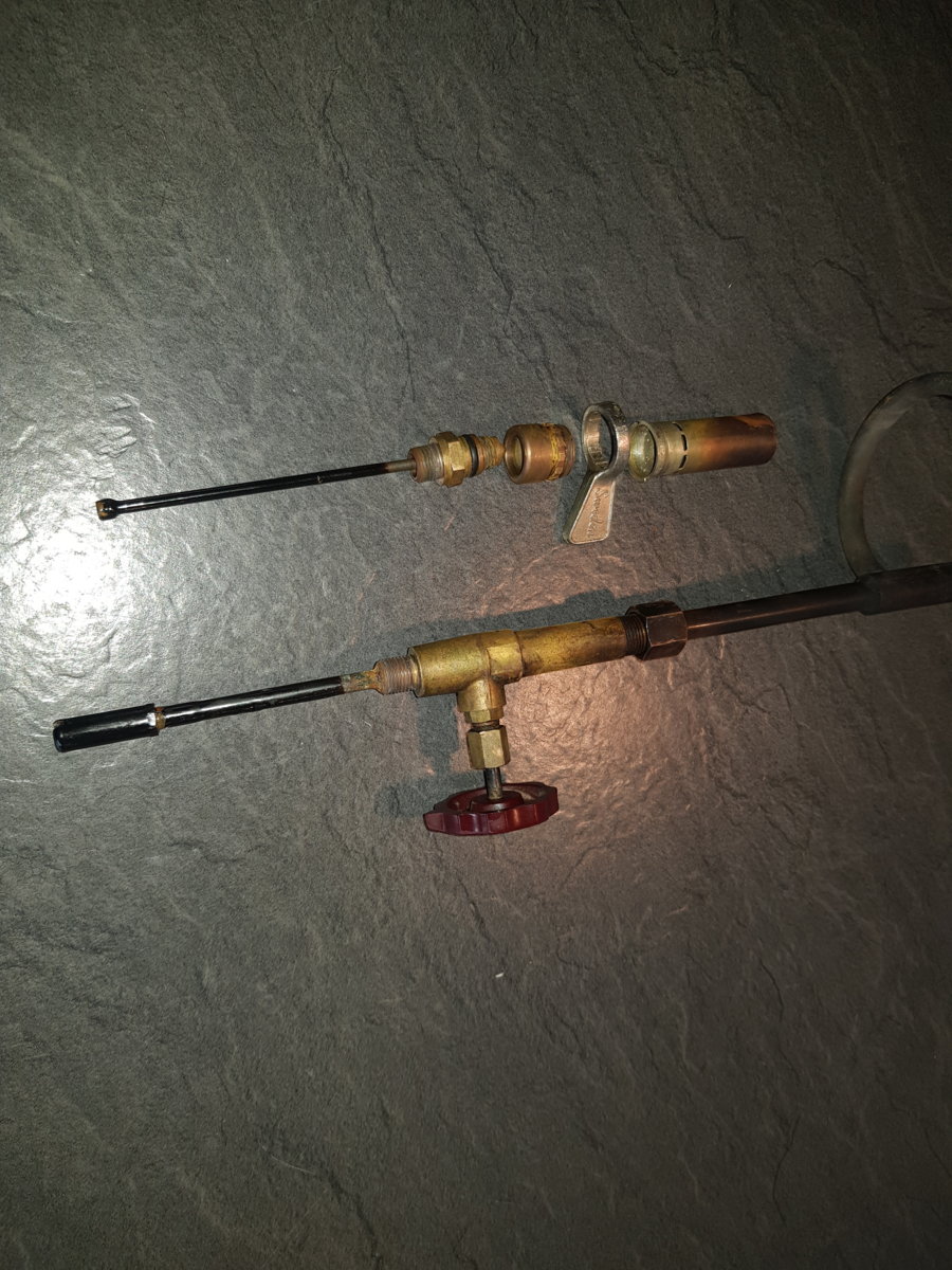

    I recently purchased an Optimus pressure lamp online in the hopes of it being in rather good condition just like the Petromax I bought last year. Unfortunately it isnt. I've put some pressure in the tank, but this pressure cannot be released. Not via the pre-heater and also not via the carburator (is that the right word for it?). I've taken it apart to have a look. The intake rods are covered in in a layer of what seems to be black paint. Its dry and glossy. This stuff probably clogged up everyting. Probably the inside wall of the tank is also covered with this stuff. 20191205_133043.jpg 20191205_133033.jpg
    Please have a look at photo's below. Hopefully someone can give me some tips on cleaning this mess. I have an ultrasonic cleaning device to my disposal. Would this be a good idea?

    these are the remains of fuel (gasoline) left in the tank for a couple of decades. It looks like a hard plastic coating and does not come off easily.
    I would use a solution of caustic soda to dissolve it. I know this works fine but requires safety precautions (face shield, long rubber gloves).
    I did not try citric acid so far on these fuel residues but it might work, too. (not so dangerous as caustic soda but aluminum parts will simply "vanish" with both of the chemicals.)

    A soak in acetone should dissolve it.

    The first issue with this lamp is fixed. Asked the Mrs for some nail polish remover because the local hardware store didn't have any acetone. Only some stuff called Eco Acetone Replacement. Didn't want to take the chance so went back home and try with the nail polish remover instead. Unfortunately, this stuff was also "100% Acetone free". But luckily, it got the job done. With the limited amount of this stuff that was left in the bottle I was able to soak and clean both rods and especially the intake part of the generator. After removing the black layer from the outside I was able to remove the valve sleeve from the stem. It was completely filled with a brown goo. After soaking these parts in the nail polish remover it cleaned pretty well and now the valve is working again. The sieve is clean the spring and valve are working and air comes out of the nozzle on top of the carburetor when opening the valve. So, i'm confident this lamp will burn again.
    Next step is to clean the pre-heater. The nozzle is still completely blocked. I don't have a needle small enough to poke the hole so hopefully some time in the ultrasonic bath will clean this up.

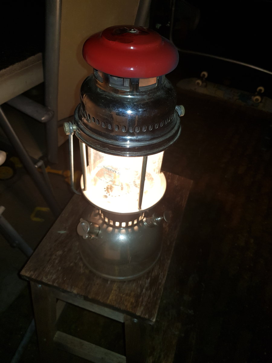

    Well, got the thing running. Just had to light it using the spirit cup as the Jet pre-heater is still not working. After a week-long soak in acetone and an hour-long dip in the ultrasonic bath the thing is still blocked. Both the air and fuel hole. Anyway, glad the lamp is working.
