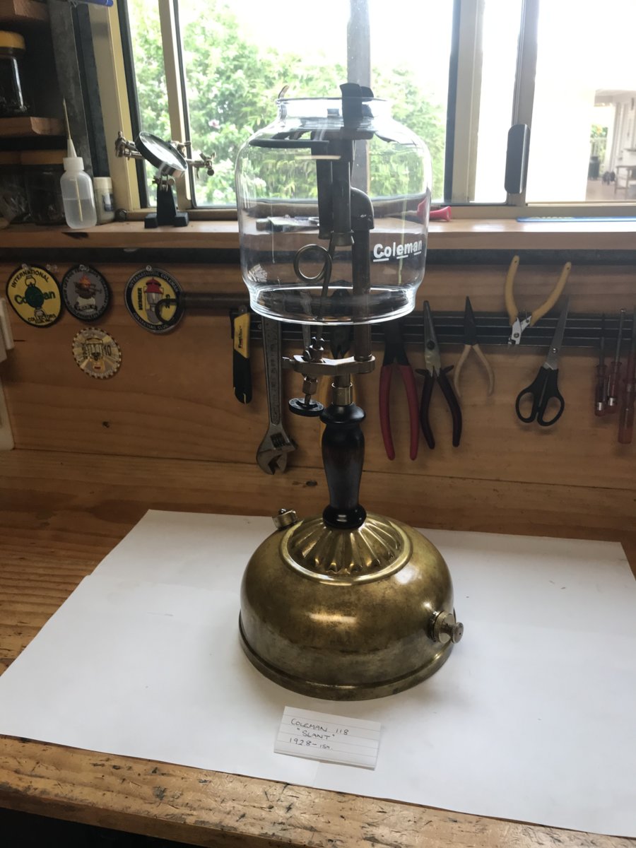

    I acquired a Coleman 118 table lamp from a collector via eBay. This table lamp has the “Slant” valve generator assembly and was manufactured in Wichita US approximately 1928 to 1930. It had the original, although distressed, paint work being predominantly brown or black wrinkle type with a base of gold paint, called by Coleman “Brown Gold veined Colac”.
    (The eBay photo used)
    Coleman manufactured the “slant” version between 1928 and 1930. It’s short production run could be attributed to the difficulties encountered with the slant style valve assembly.

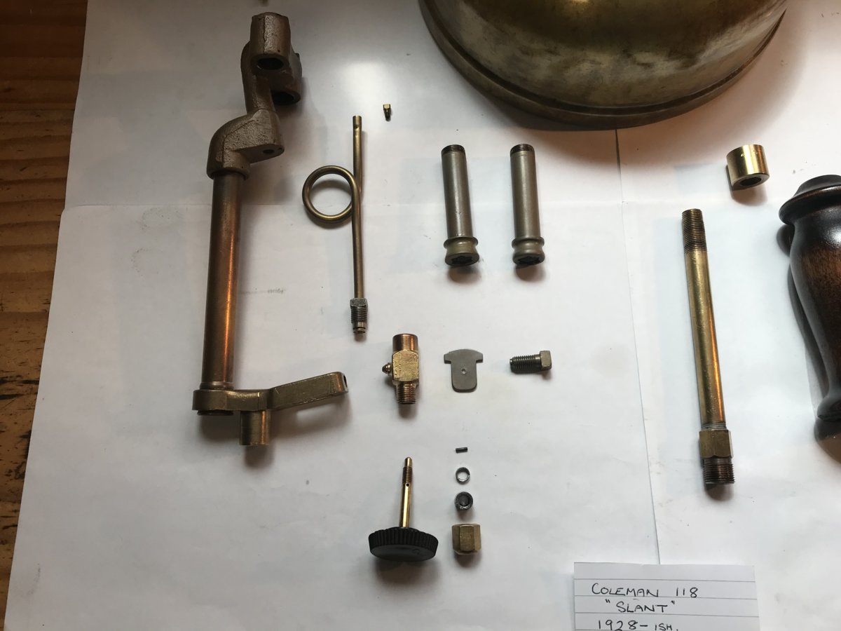

    The control valve’s gland packing at some time had been replaced with a graphite impregnated fibre. Although this previously repair may have worked well, it was now not fit for service and had developed a dangerous leak.
    A new correct graphite gland seal was procured and installed. This valve shaft has the earlier steel pin retaining the gland packing steel ring and not the later steel wire clip.
    The valve shaft and the gland seal components can be seen in the above picture.
    The straightened fuel delivery tube can also be seen in the right field of the same picture.

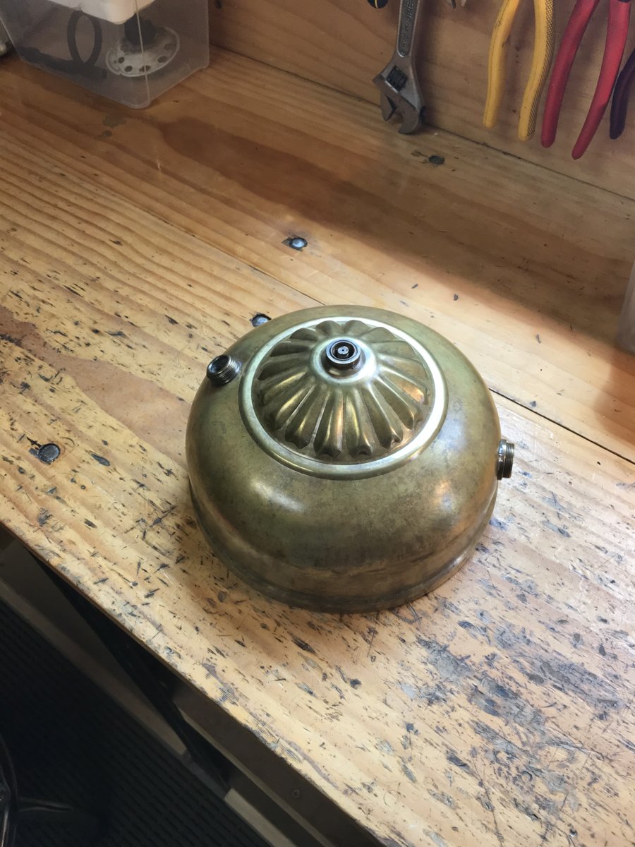

    I stripped the original paint off both the fount and the wooden handle. Immediately, the fount’s brass patina was disclosed.
    I fell in love with the brass patina look. Without removing any of the patina, I sprayed the fount with a clear acrylic automobile rattle can paint. The wooden handle, had its many layers of original paint removed and stained with walnut then finished with 3 coats of a Tung oil.
    The prepared parts gathered ready for assembly.
    The parts were assembled.

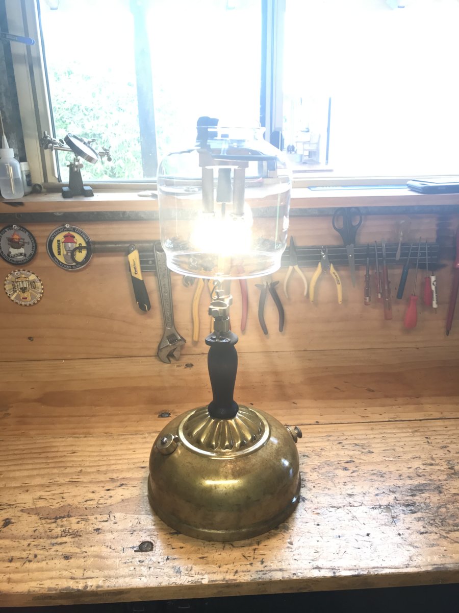

    Now the money shot.
    The lamp lit very easily and once warm runs very well. I did notice on this and subsequent lite ups that this lamp needs 5 to 10 minutes to settle down.
    This lamp is one of my favourites, after warm up, it provides a steady reliable light. It now resides in my master bedroom.
