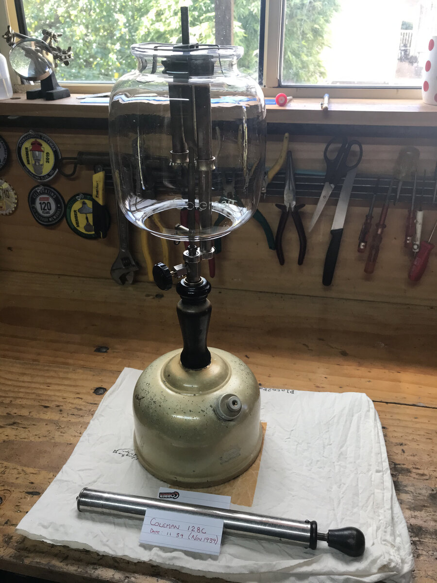

    Some months ago, on the Bay of Evil, I won this Canadian Coleman 128C, also known as the “Princess” table lamp.
    The date stamped on the fount is 11 39 representing its manufacture date as November 1939. The 128 Canadian Princess lamps were manufactured from 1935 to 1942.

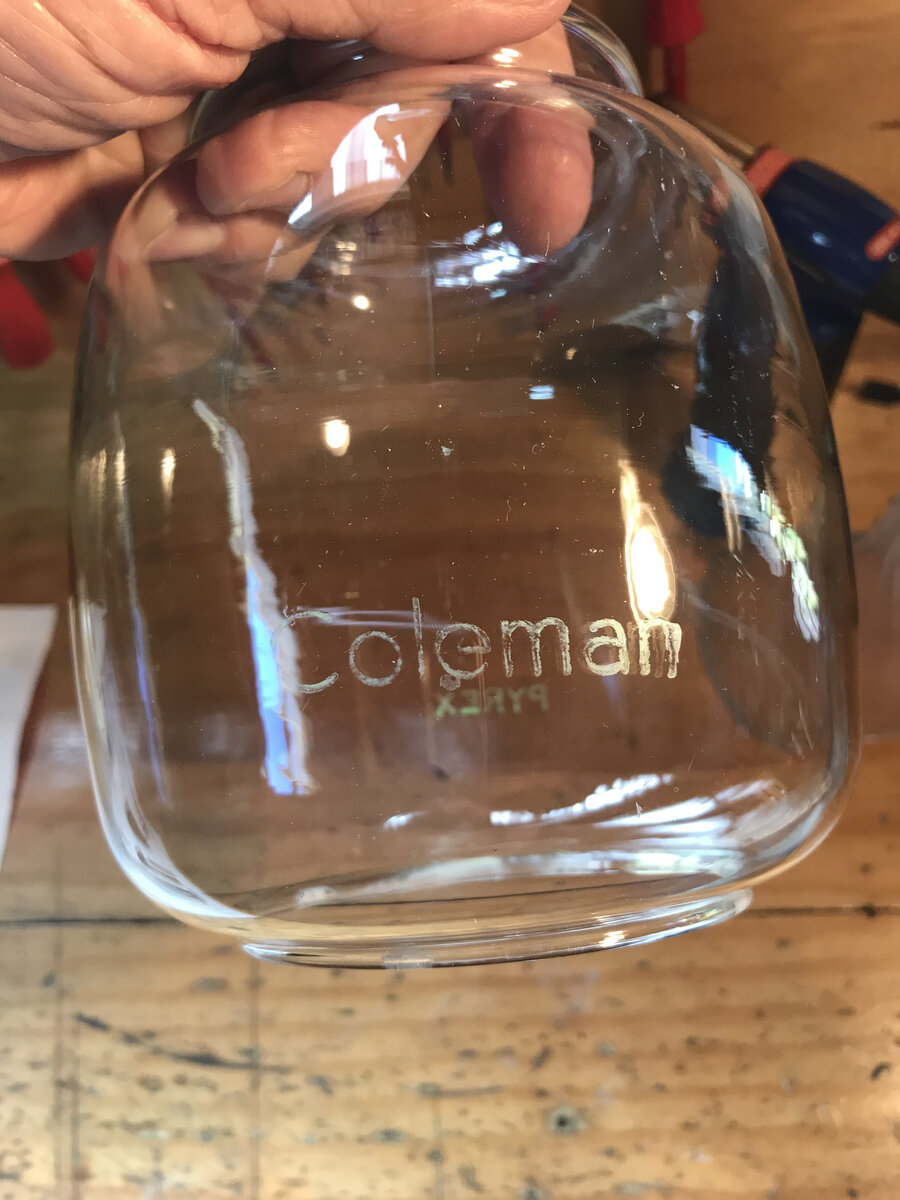

    The lamp was intact and complete with, I believe its original 355 glass globe. The text “Coleman” as the name “PYREX” appears to be in a green coloured font.
    The lamp was found to be in a clean and tidy condition however, on a closer inspection the following issues were evident:
    • The fuel filler cap, housing the external pump connection, seal had deteriorated and hardened causing pressurised air leakage.
    • The fuel filler cap’s external pump connection’s steel ball had seized allowing pressurised air to leak out unacceptably.

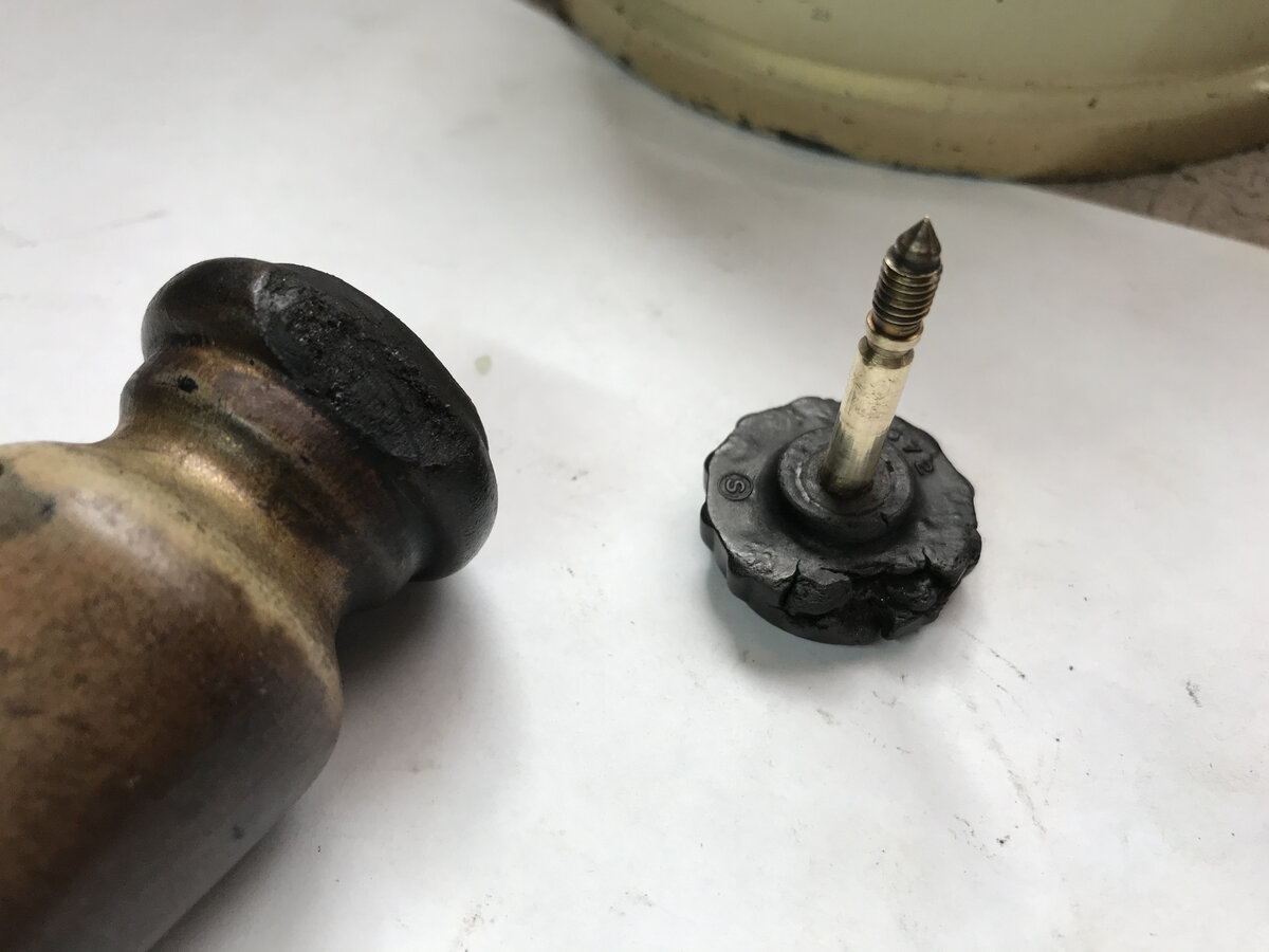

    • The fuel control valve wheel was severely burnt.
    • The fuel control valve wheel shaft was seized.
    • The lamp’s wooden handle, at the top, was burnt.

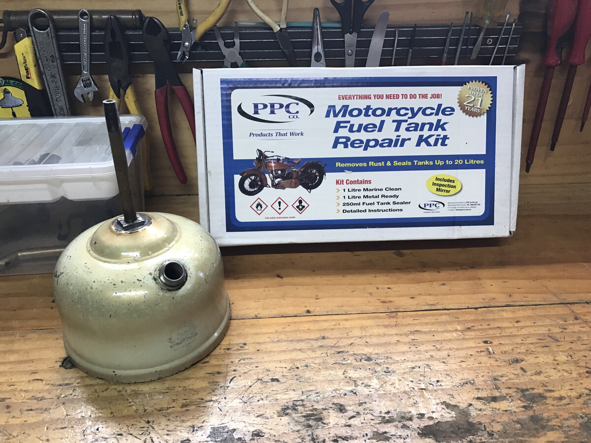

    • The lamp’s fount (tank) although sound had some areas of local rust inside on the base. The rust hadn’t penetrated the base.
    • The Coleman R55 generator was found to be swollen, split and damaged beyond repair.
    • The fount’s paintwork was dirty but overall, in reasonable condition for its 82 years.
    Notwithstanding, the lamp was found to be in a reasonably good condition.

    The internal rust was successfully treated with a motorcycle fuel tank repair kit.
    The Wooden Handle and the Control Valve Wheel
    The lamp’s wooden handle and the control valve wheel showed significant burn damage.
    The burn areas were filled with 2 x pack epoxy resin.

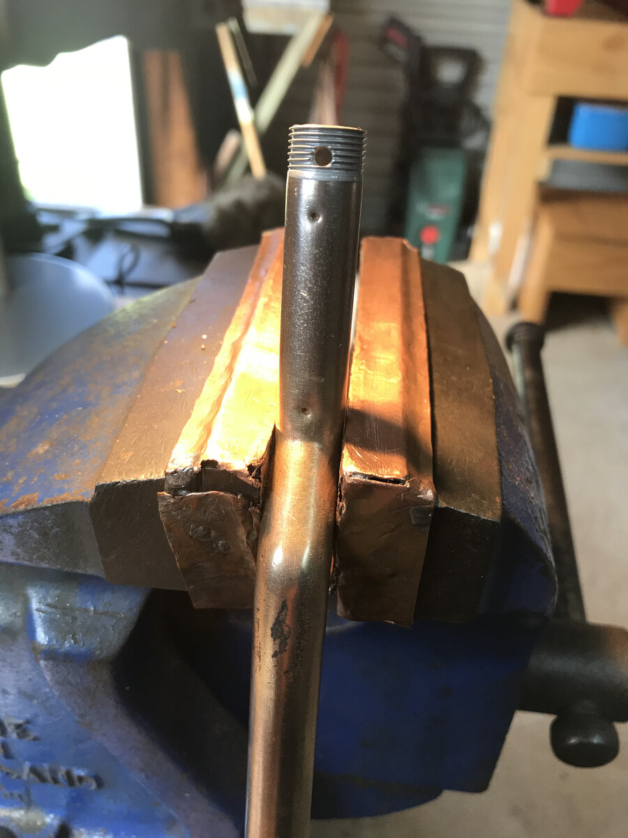

    The Air Inlet Tube
    The air inlet tube showed an unexpected feature. The actual air tube had a restricting sleeve inserted and crimped in.
    Checking with a fellow lampie, ColinG, he confirmed that his similar 128C also had the tell-tale crimp dimples in the air tube signifying the installation of an air restricting sleeve. From this it was concluded that the restricting sleeve was factory fitted.

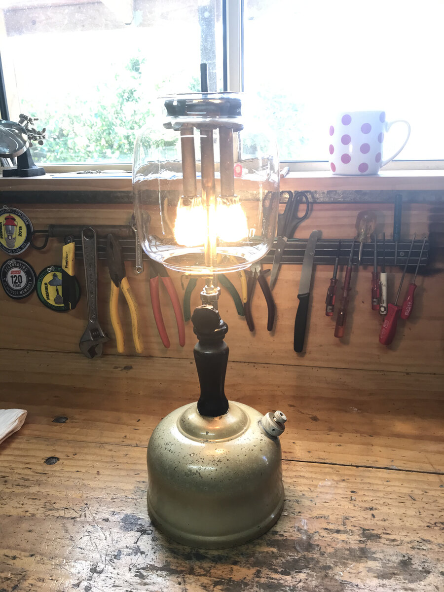

    The assembled Coleman 128C lamp was fitted with mantles and then fuelled with Shellite. Using a for purpose hand pump, the fount was pressurised with about 20 pump strokes. The control valve was then opened for approximately 2 seconds and closed. Using a small gas torch, the generator was preheated for about 5 seconds until the mantles caught and lit. After a about 5 further seconds, the fuel control valve was slowly opened fully, and the lamp’s mantles fully illuminated.
    Pumping a further 60 strokes into a half full tank of fuel, the lit lamp settled down and ran flawlessly for over 2 hours.
    After the 2 hours test run the lantern was turned off by closing the fuel control valve.

    In this fettled Coleman 128C lamp, all the original parts excepting the seals and generator, were reused, including the original 355 globe.
    The fettled Coleman 128C lamp lit and ran flawlessly, for its 2-hour test.
    I had a lot of satisfaction resurrecting and seeing this table lamp royalty commanding the dark away.

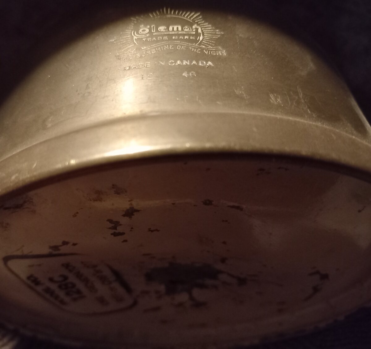

    20220803_203650.jpg @AussiePete
    Can't work out how to quote but above you posted that they were manufactured from 1935 to 1942.
    I have a 128C fount made in December 1946.
