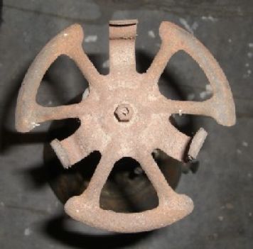

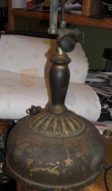

    I just got this lamp from an antque shop. He had dropped the shade, but made a great price on the lamp. I am guessing it is a 143. It has the pressing in the middle.

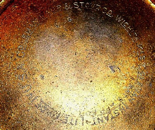

    On the bottom it says Coleman quick light. Numbers on each side are either 6 6 or 9 9, depending on which way is up. Also stamped with C Q.
    So I am guessing it is a June 1936 lamp. Oh it has the built in pump. And the lampshade holder is a bit odd. Other than the paint peeling off, and the pump leather needing some oil, I think it should work just fine.
    So, how's my guess? Worth $20.00 USD?
    -Ralph in the wilds of Missouri.

  2. Dan D
    Dan D Subscriber
    Feb 13, 2011
    374
    Hi Ralph,
    I can say with almost 99% certainty that it's a 118A made in Sep 1929 (9 9). It's a first generation Instant-Lite. It has the gold colac finish and the correct shade holder for a glass lamp which is what it came with.
    See my post on this lamp here ...
    http://0flo.com/index.php?threads/4197
    Should work well with a bit of clean up. Give the font a good flushing and check for rust. It's critical that the filter screen at the fuel pick up not be clogged on this lamp.
    Dan

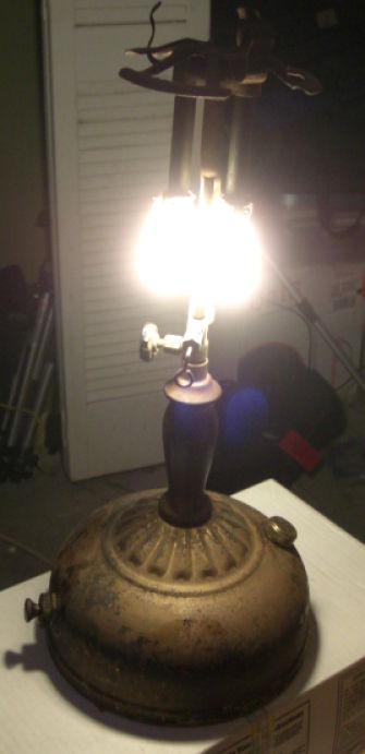

  7. wd6bgn
    Nov 3, 2012
    21
    Lamp is lit. Ok, I do need to clean it up more, but the basics are OK. Not bad for something 84 years old. I hope I work as well. Funny thing, it uses the same generator as my 220F. So I light it just like the 220F, and it works just fine.
  8. JEFF JOHNSON
    9,701
    Another fine old lamp working again! :thumbup:
  9. Dan D
    Dan D Subscriber
    Feb 13, 2011
    374
    Nice job Ralph!
    It looks like it's burning perfectly.
    Now for a shade so you don't get blinded by the light!! 8)
    Dan
  10. wd6bgn
    Nov 3, 2012
    21
    Thanks Dan.
    This was a real easy one. I'll be looking for a shade for it. I also think it could use a good soak. I think it should be a bit brighter. It has the Peerless mantles on it, and they may be a bit too long? Dunno. Anyway as I write this it is burning away helping to keep my shop warm. I figure a few hours of burn time won't hurt a thing.
    Cheers! And have a Happy New Year!
