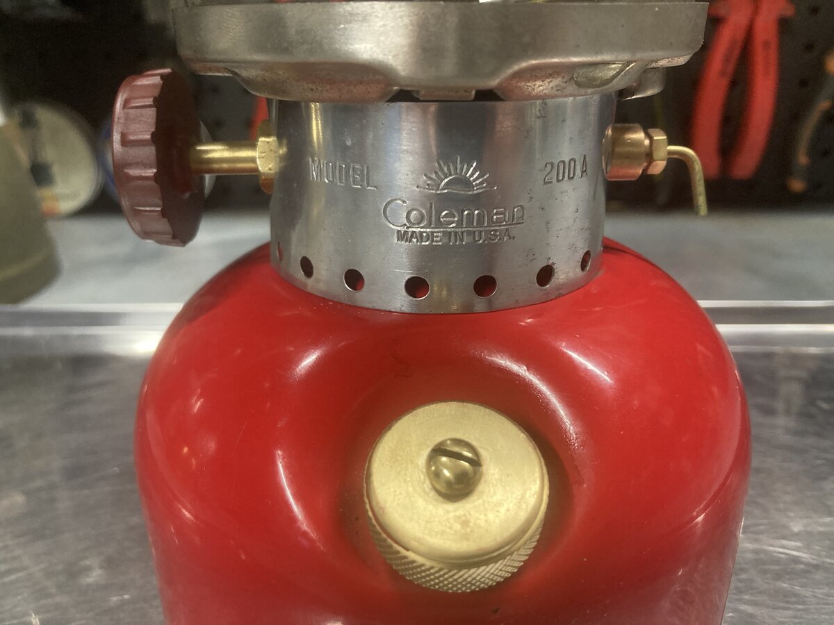

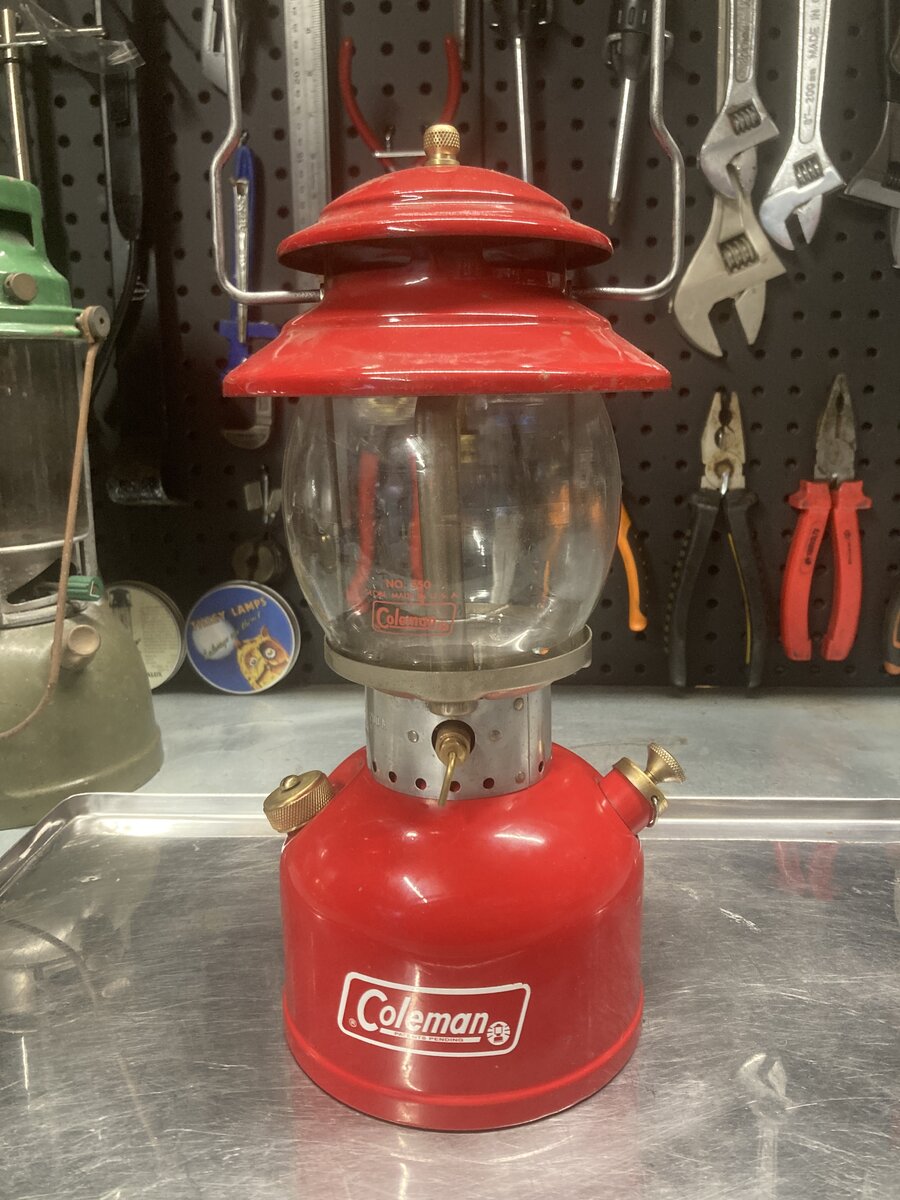

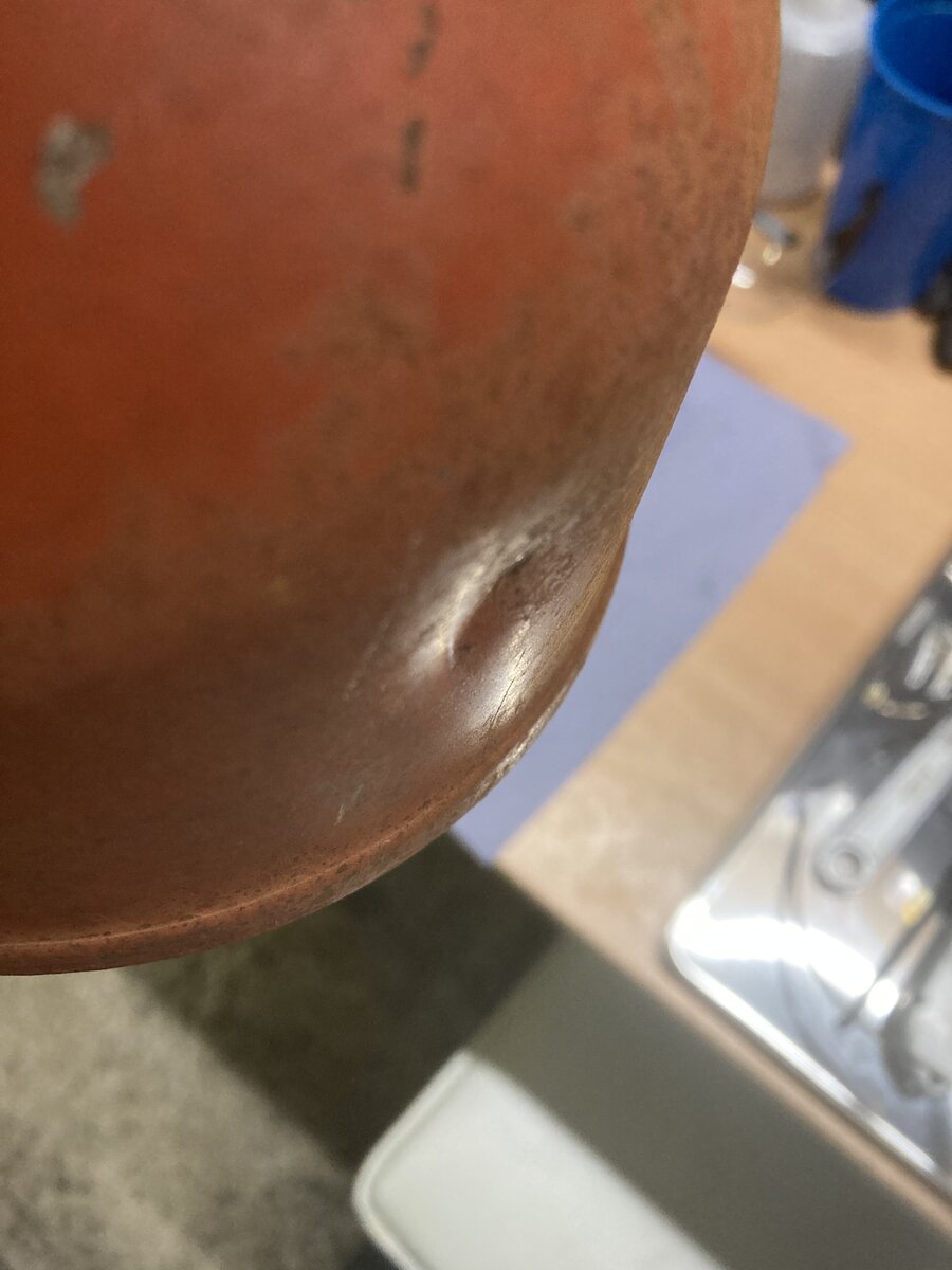

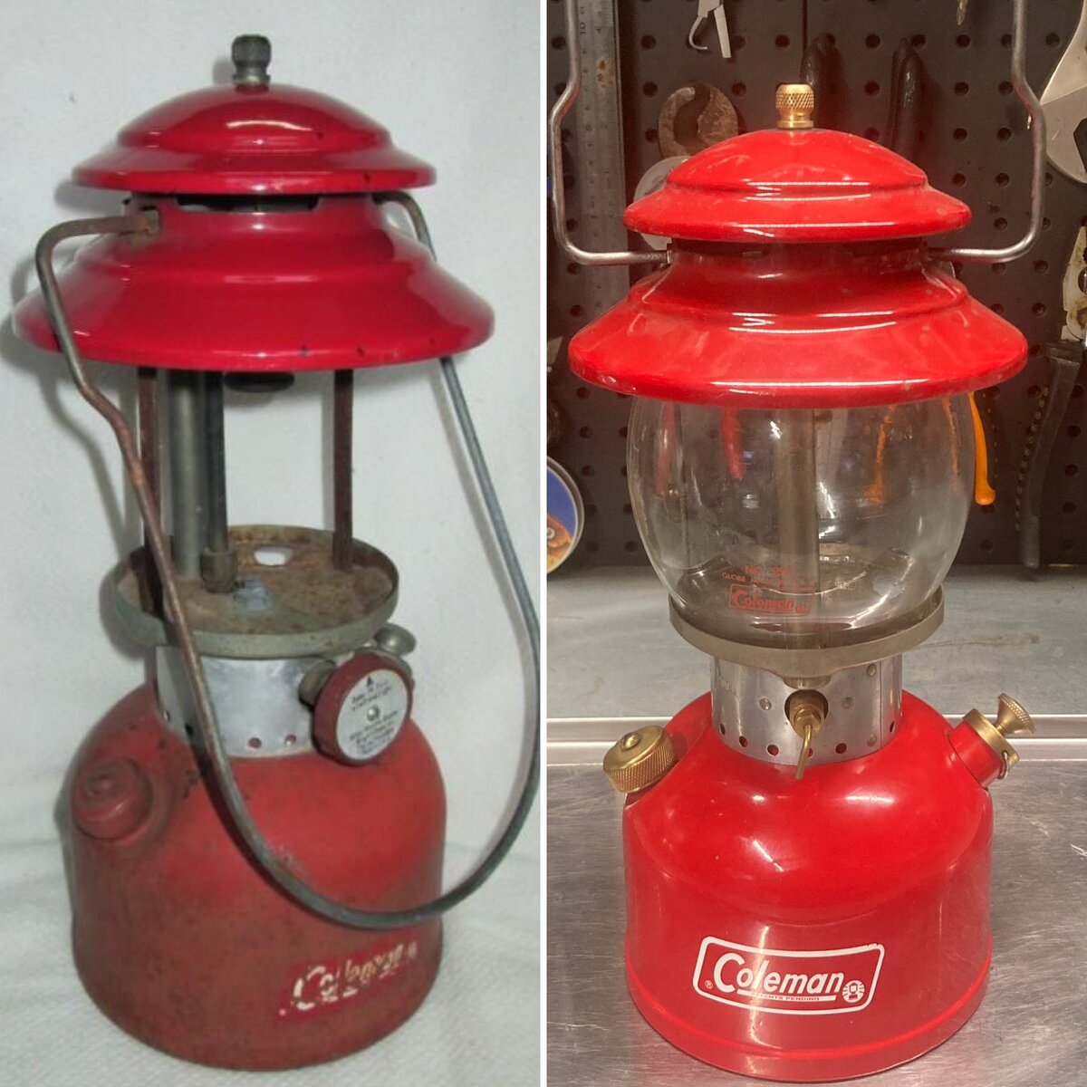

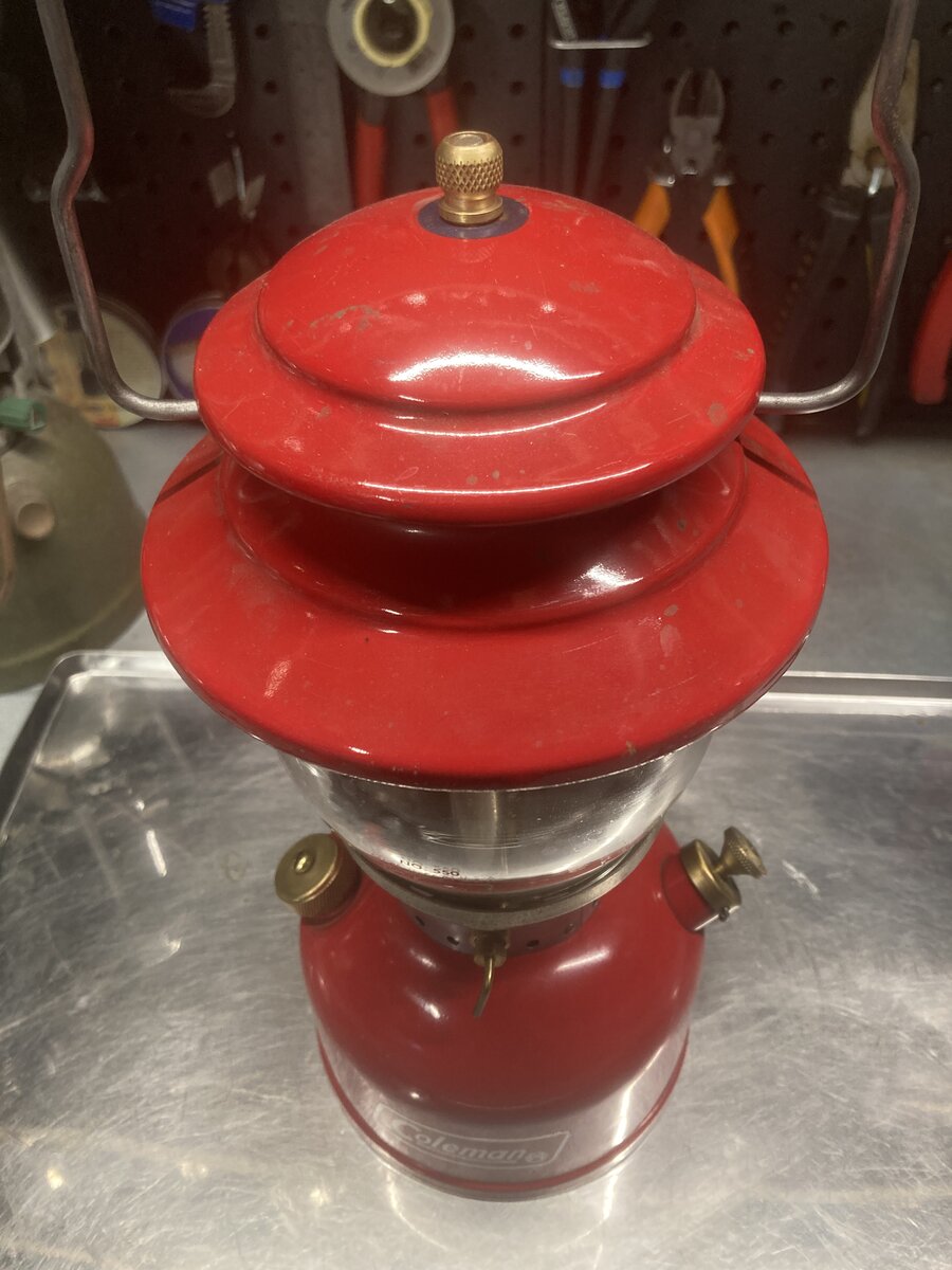

    I found this 200a a couple of years ago but it was fairly damaged in transit and then turned out to have a pinhole. So it sat on the shelf. A couple of months ago I found a donor fount. It’s a good few years newer (78) than the lamp I had (64) but I’m not a strict purist so swapped it out. That’s when I learned about the two sizes of Coleman check valve. So the new fount needed an old style check valve installing so I could use the original pump. That’s when I found out about the joys of removing Coleman check valves!!!! It was going nowhere! A two day soak in wd40 though and it budged. Nearly killed my check valve tool!
    I’ve never fully understood why they painted the fuel cap on the 200a and seeing as it’s a mash up anyway and the donor came painted and logo-ed so I didn’t have to paint the fount, I left it brass.

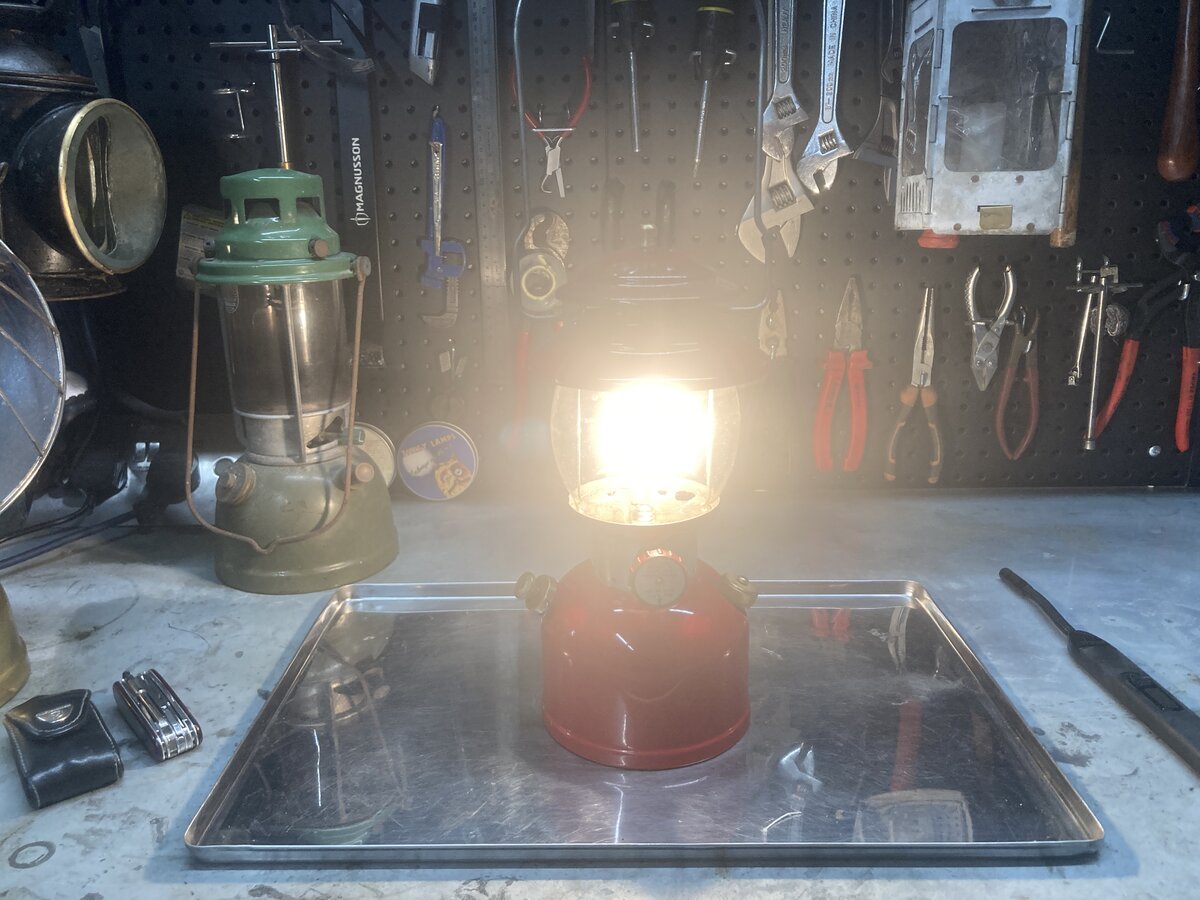

    Easy rebuild and it’s up and running. A mismatch, but recreates that iconic 200a look that my shelves have been missing!

  2. Remus1956
    Jan 17, 2024
    130
    Los Angeles, Ca
    I think the brass accents look nice! Great save!

    @Scott D A well-revived lantern Scott. I’m guessing you painted the steel pump knob and cap gold to provide ‘balance’ for the filler cap? And a brass hood nut?

  6. Scott D
    Scott D United States Subscriber
    Aug 10, 2020
    727
    Yorkshire, UK
    @presscall - No the brass is bare, no gold paint. The pump shaft/knob I presume is plated, that was just cleaned up so it is original.

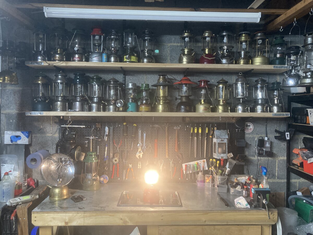

    Thanks, it was always going to be about a diverse collection for me rather than minor variations of very similar looking lanterns. Getting harder to add interesting pieces now without spending a fortune.
  8. presscall
    1,513
    Lancashire, UK
    Well, I’ve learned something, thanks. I’ve previously assumed that the pump cap, its retaining wire clip and pump knob were plated steel.
  9. Scott D
    Aug 10, 2020
    727
    Yorkshire, UK
    I believe the pump components on later models are plated. This is a newer donor fount but with a 1964 pump assembly. I’ve probably confused things!
  10. presscall
    1,513
    Lancashire, UK
    Thanks for the explanation Scott. To be fair, you had mentioned the swapping of parts, but I’d not joined up the dots!
