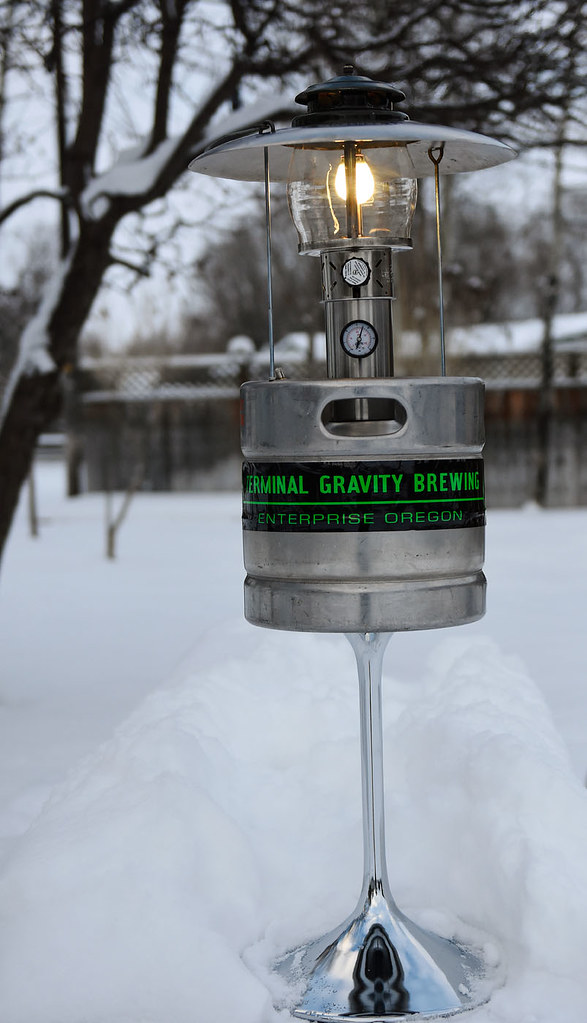

    Beer keg lantern?
    [​IMG]
  13. ColinG
    2,898
    Holy crap! That is so ugly yet so amazing at the same time!

  15. Hippie United States
    Mar 19, 2019
    30
    NE Oregon, USA
    Schrader valve, so it's bicycle pump or compressor, hence the pressure gauge. 2 gallon capacity w/0.8 gal. headspace for less frequent pumping and a Coleman Canada 37 head for retina-searing brightness.

  17. Hippie United States
    Mar 19, 2019
    30
    NE Oregon, USA
    Here you go:
    [​IMG]
    I'm currently running it on a mix of 50/50 Camp Fuel (naptha) and Diesel. Runs great and pretty cheap.
    I don't know what happened above, but the head is a Coleman Canada 237.
  18. ColinG
    2,898
    So how long can it run on one filling?
  19. Hippie United States
    Mar 19, 2019
    30
    NE Oregon, USA
    I typically run it every night for four to five hours... for weeks.
    It also works just great on straight camp fuel, but to get max. brightness, I switch the gen tip for one from a 236 gen. 0.009" vs. 0.0085". We get lousy kerosene out here which is why I'm using ultra-low-sulfur Diesel mixed with CF.

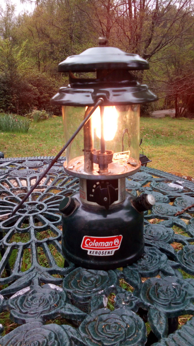

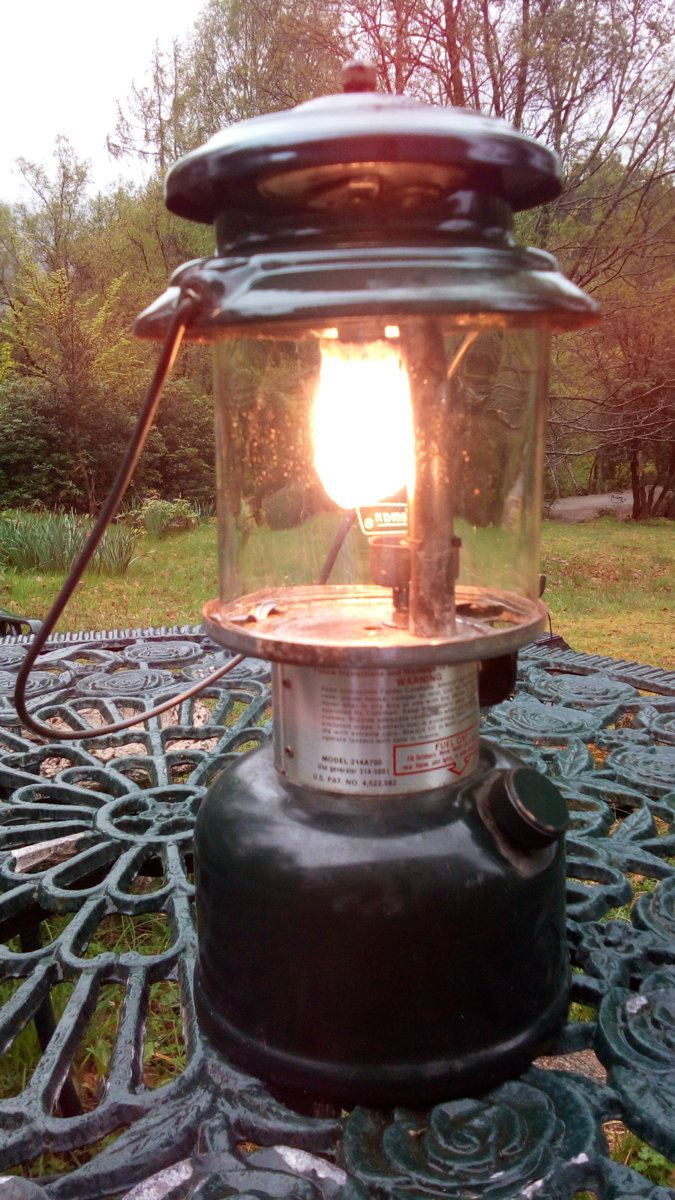

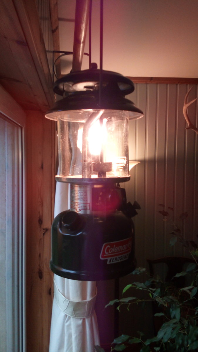

    *UPDATE*
    I recieved a 214 fount from the impressive stock collection of Rob Flint today, so having assembled all the parts, I now have a functional Coleman 214! Of course, this means I won't be selling / donating the parts. The tank was a Birthday present from my dear wife!
    I must say, its one of the quietest lanterns I own and yet it's still really bright!
  26. Rob flint United Kingdom
    Jul 2, 2018
    27
    Devon U.K.
    Glad it arrived safe and sound Colin,the 214 is one of my favourites
  27. ColinG
    2,898
    Yes, thank you so much Rob... literally all I did was put everything together, add one if the loose Coleman mantles you sent and preheat it. It's been whispering quietly by the French windows since I lit it. Excellent!
