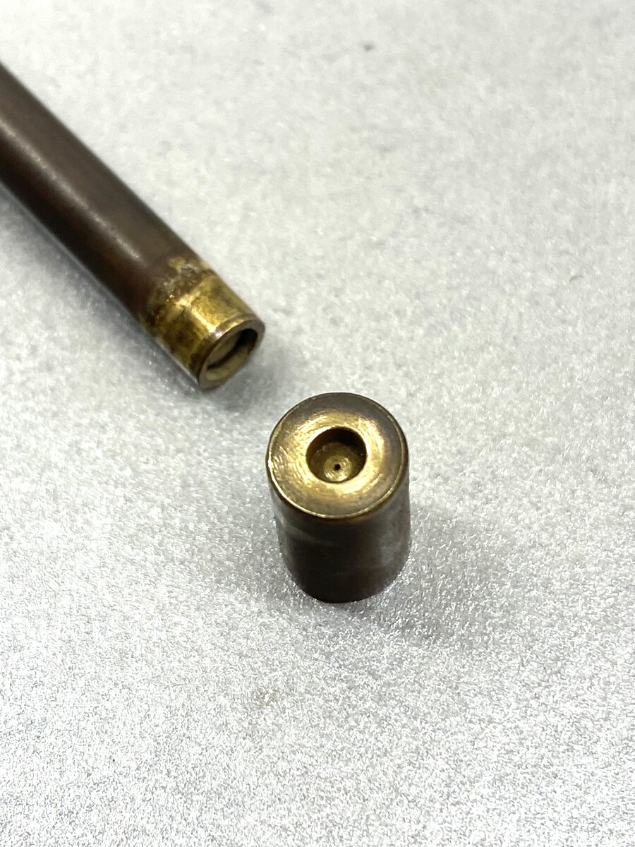

    What’s not been good: I didn’t own my example from new, but it was little used and I’ve no reason to suppose that its lighting and running characteristics were worse than those of one fresh out of the box. It was from the outset temperamental to light until I realised (on stripping the lamp) that fuel pickup is through a tiny pinhole, little more than the size of the generator jet orifice. There is no fuel metering rod operating in a much larger fuel inlet orifice (as with a conventional Coleman) in the 226 design and it takes much longer - tank pressurised and control valve opened - for atomised fuel to reach the mantle enabling ignition than a Coleman like the 222 does.
    Here’s the fuel pickup tip and the pinhole.
    Apart from the extended lighting phase, that pinhole is prone to at least partial blockage and without a metering rod to poke the debris out it’s likely to remain obstructed. That explains the experience I’ve had with the 226, that it became difficult to light, and its banishment to storage began.

    View of the concentric tubes, ‘pinhole’ inlet component removed.
    I decided to dispense with the atomiser configuration altogether and began by soldering a sleeve over the air inlet hole in the outer concentric tube. The O-ring pickup-to-valve seal wasn’t perished or torn but snapped on removing it for the soldering and was replaced. The end cap with the fuel inlet pinhole was dispensed with.

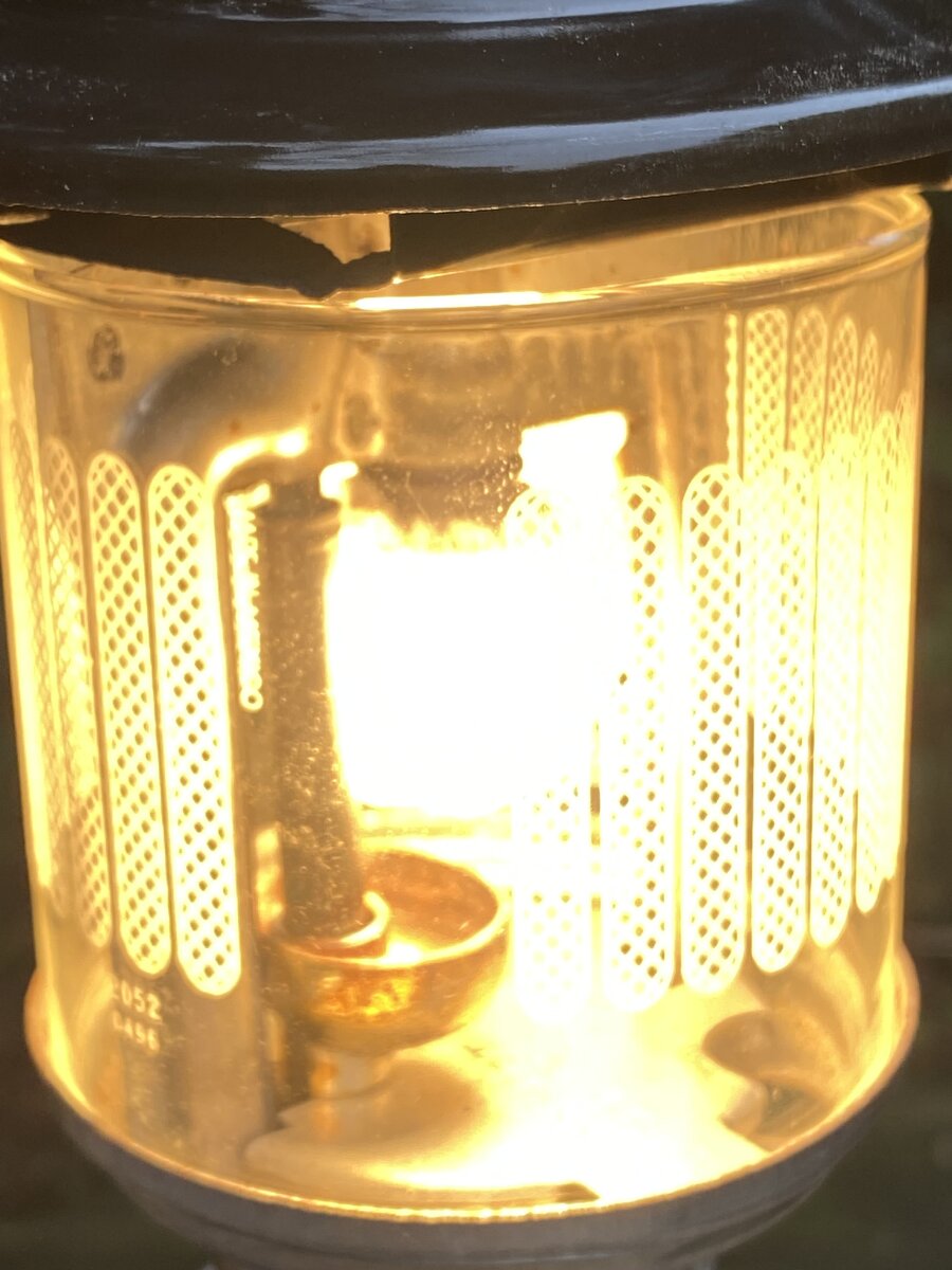

    Next, I made a spirit pre-heat cup.
    A side benefit of a spirit pre-heat is that kerosene can be burned successfully, as here.
    The pleasing outcome was a 226 that remained lit without any pumping after the initial tank pressurising until the fuel ran out an hour later.
