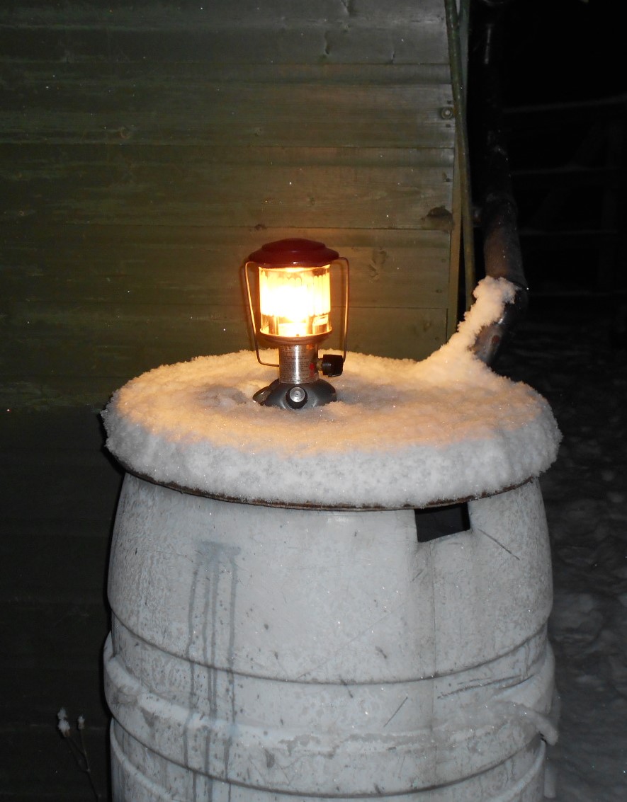

    A bright little lantern when it was working but even though there were no leaks, I had to add pressure every 10 minutes or so otherwise it would go out.

  3. James K
    Nov 10, 2017
    468
    Looking good in the snow Henry.
    I am guessing this must preheat from the vapour in the tank.
    Does it have an air shut off spring you could make more springy?
    James
    12,560
    A well lit snowy scene.:thumbup:

  6. Fireexit1
    1,779
    I guess the combination of cold and a small tank is the cause. The price you pay for portability ?
    Nice pctures

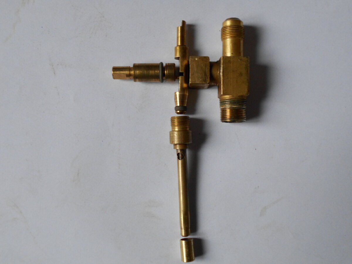

    I decided to strip down the lantern and give it a good clean. I put some ball bearings into the tank and added some clean kero then gave it a good shaking and drained the dirty fuel. I had to do this 7 or 8 times before the fuel came out as clean as it went in.
    This was the result
    I assume it's the ethanol in modern unleaded gasoline which has destroyed the tank lining used by Coleman during manufacture. Anyway, the lantern certainly ran better once I'd got all that stuff out of the tank.
