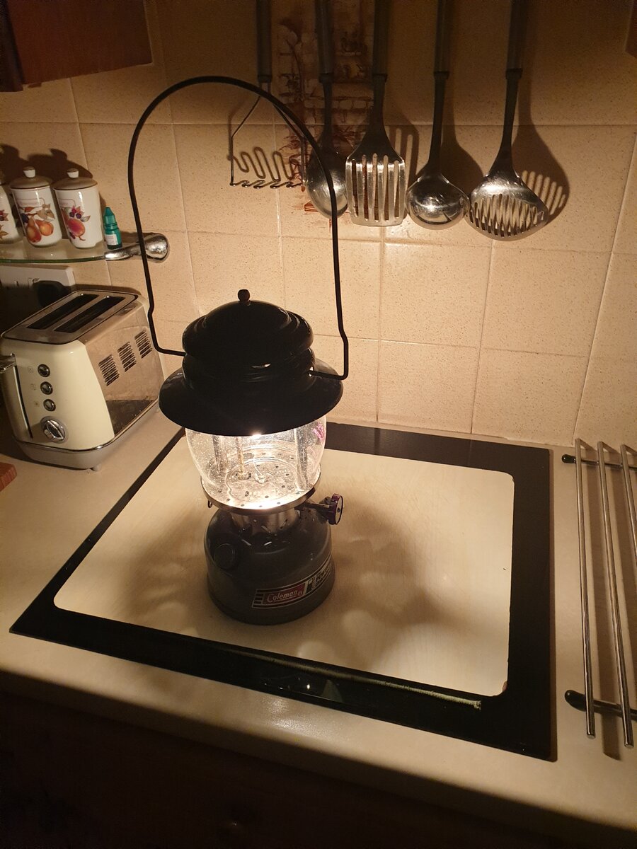

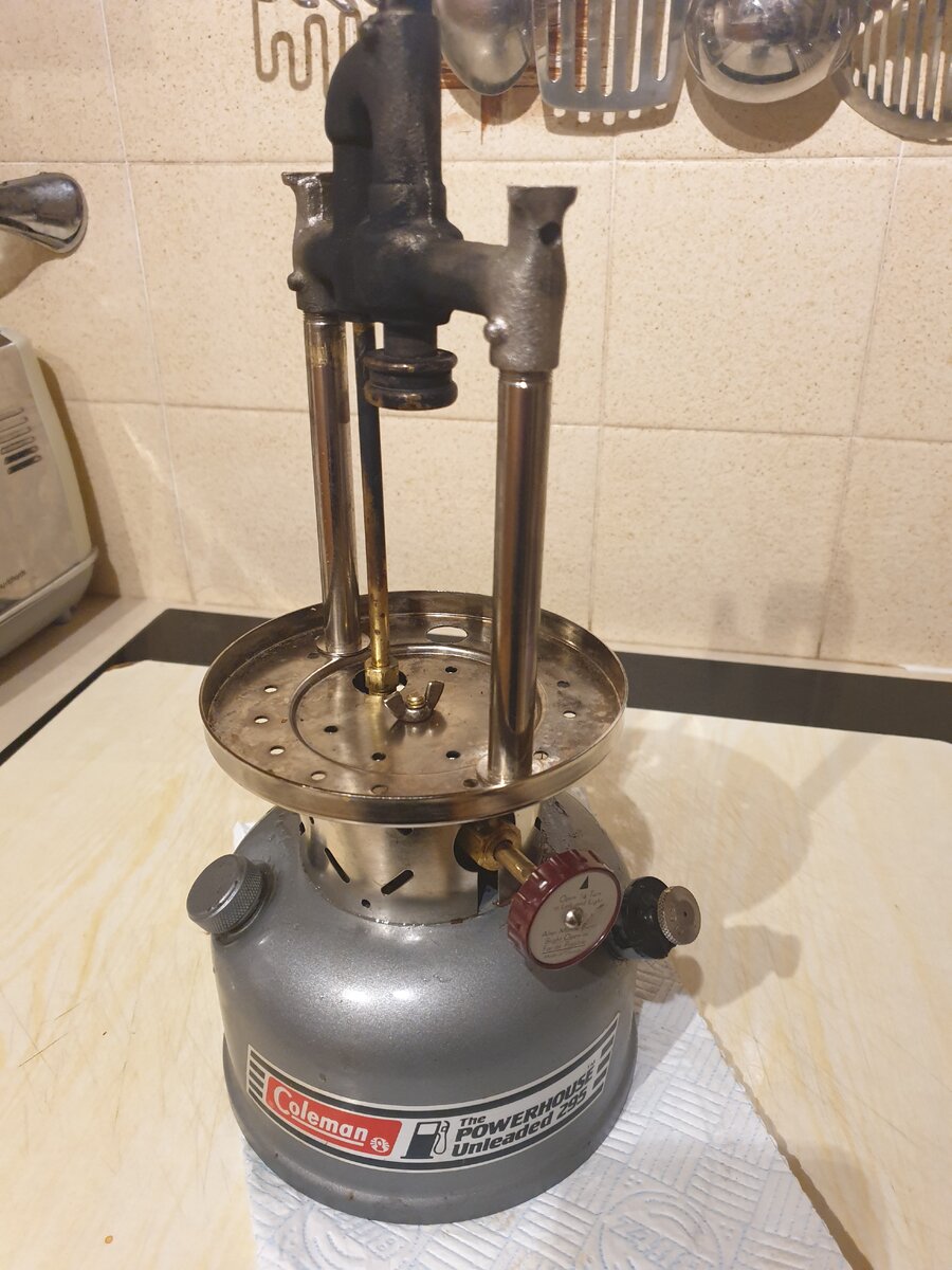

    The story so far. I bought a coleman 236 with a damaged tank. I've swapped the tank for a powerhouse 295 tank. The tank seems to pressurise ok and doesn't appear to leak when tested in a sink of water. New fuel in the tank.
    I just can't get it to light! I think it may be a possible valve problem..I think air is coming out but not fuel. Any help appreciated.
  2. swiss-paul
    Feb 28, 2013
    125
    I've got it working!! Loosened the nut on the control spindle. It seemed to need opening the valve a lot more than other coleman lamps I've got. Ill see if it behaves itself, been a pain so far!
