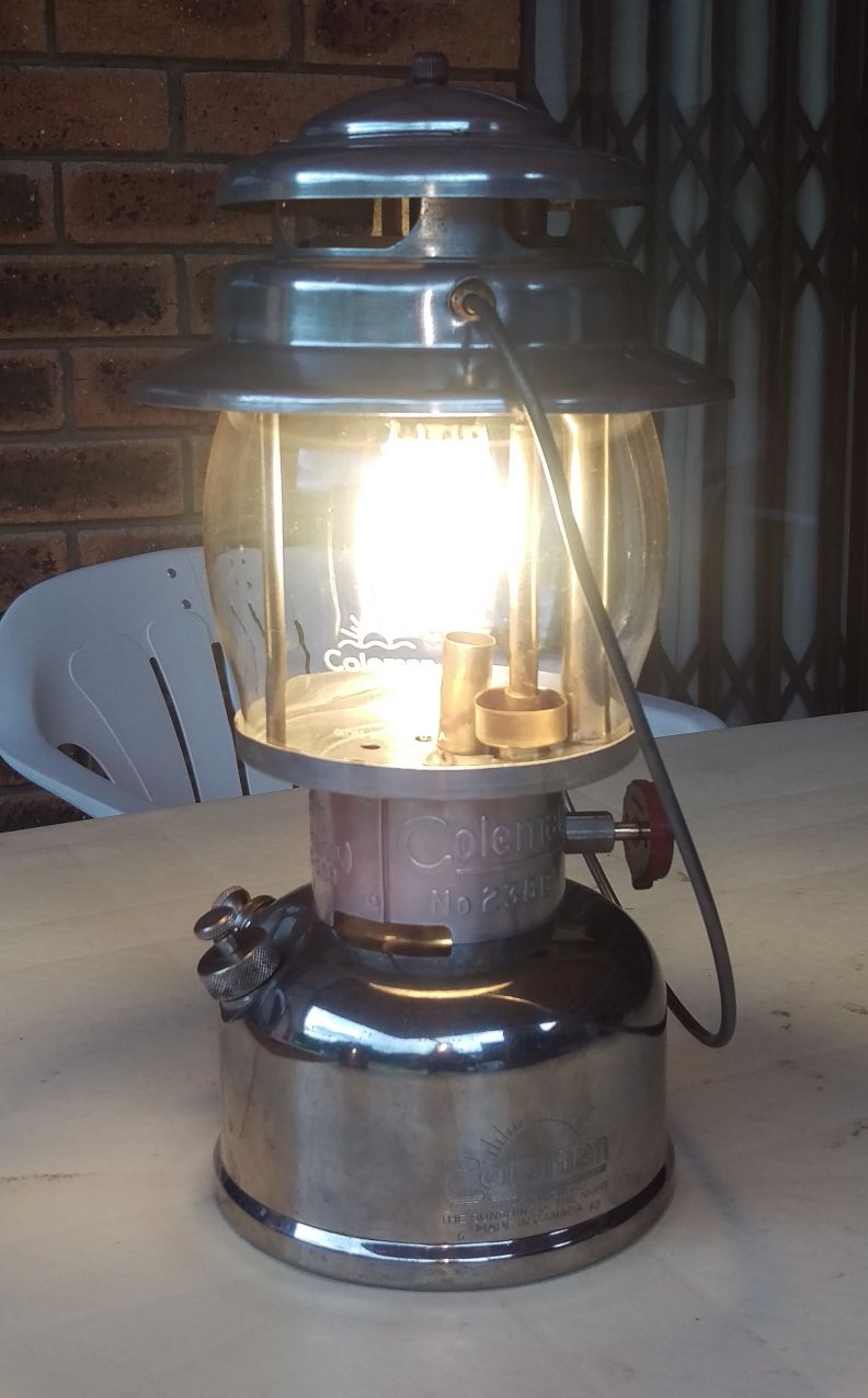

    In December last year I was given this Coleman 238B by a very kind retired gentleman whose father had bought it new when he was a child.
    When I examined it and compared it to photos of other 238B's I noticed some significan differences:
    -It uses the 237 generator rather than 238B generator as is indicated on the collar. The valve is thus also different to suit the generator.
    -It has a Petromax style ceramic burner (like the Col-Max)
    -The aluminium base plate is cut out only for the generator and pre-heat torch rather than a big circular cut-out and a round steel mounting plate.
    -The bail stops on the burner cage top ring are positioned 90 degrees away from the bridge/bracket rather than close to it.
    -It has a 249-style alcohol pre-heat cup (although this may possibly have been added later)
    According to Neil, this is the only known 238B with these differences and may have been an early prototype or a one-off.
    I finished fettling and cleaning the lantern yesterday and ran it for about 5 hours last night and I'm happy to say that it performed flawlessly :-)

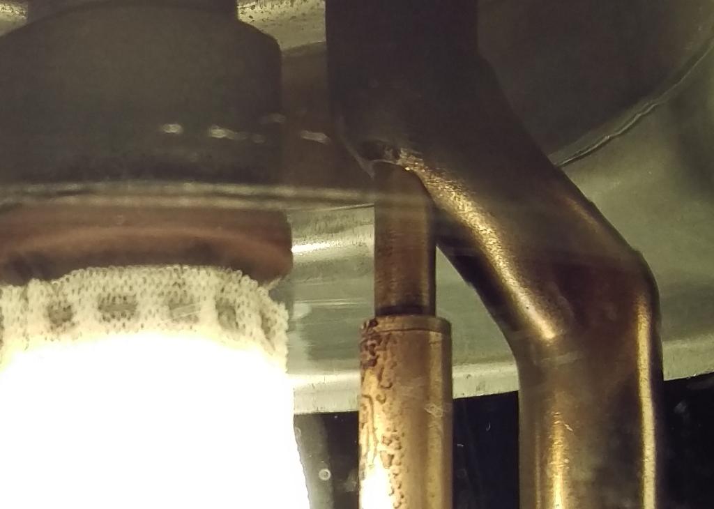

    I just acquired a second (incomplete) 238B and discovered a few more differences between the one posted above and the "standard" model:
    The standard model has a U-tube like the 200A and a burner tube that threads into it with a nut to lock it onto the frame from below to secure the vent stud bracket. The vent stud bracket also has a round hole and is not slotted as this one is.
    Note the spacer tube, the threaded U or J tube, the mixing chamber and the nut which sits above the burner frame to secure the vent bracket from the top.

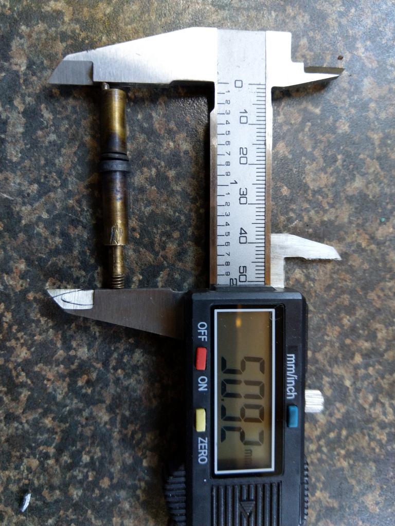

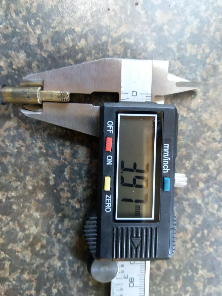

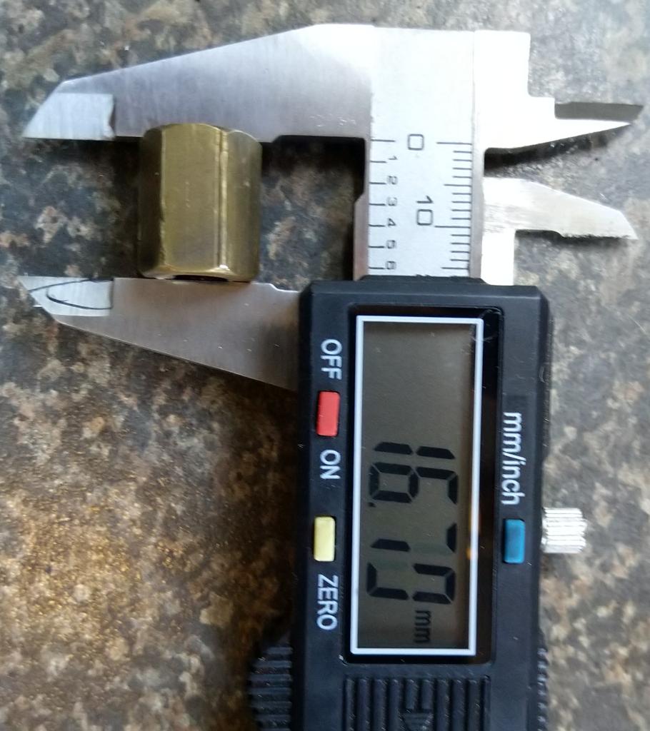

    I checked out my Coleman 238B and now realise why its in the "I'll get to it later" pile. It's got no fuel control spindle/whee/packing nut.
    Do you think one can be filched from another Coleman?
    @phaedrus42
  13. peterthevet
    peterthevet Subscriber
    Nov 18, 2014
    108
    Australia
    Tony - perhaps parts from a Colmax may fit?
  14. phaedrus42
    phaedrus42 Subscriber
    2,050
    @Tony Press , I just checked and the packing nut is a common Coleman part as on 237 and 220F. The Col-Max wheel and disc are identical in shape and fit. I think one should be able to machine a 220F spindle to the correct dimensions and shape. A common Petromax clone valve wheel and spindle nut will fit perfectly.
