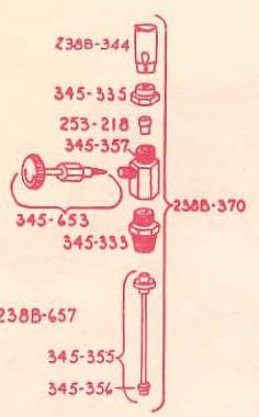

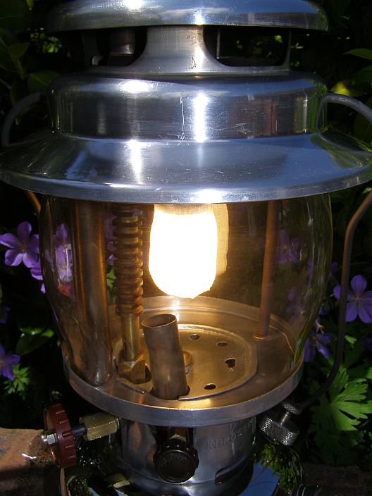

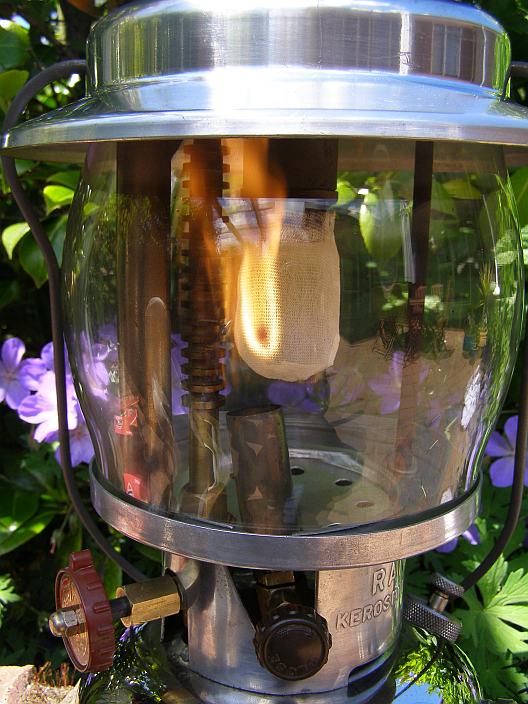

    Then straightened out the aluminium frame and set work on to the rapid lighter. First up I had to solder the base nut 333 (as seen in attached diagram) to stop it leaking where it went into the tank. After some period of playing around with the rapid lighter without getting any fuel to flow through, only air, I finally resolved the problem :p . The mixer disk (part 355) was loose, so by putting in a custom rubber washer underneath it, it sealed it for the fuel to come through while also allowing air to come through from the tank. Once this was sorted out, I gave the rapid lighter several test runs before placing a mantle onto the lantern.

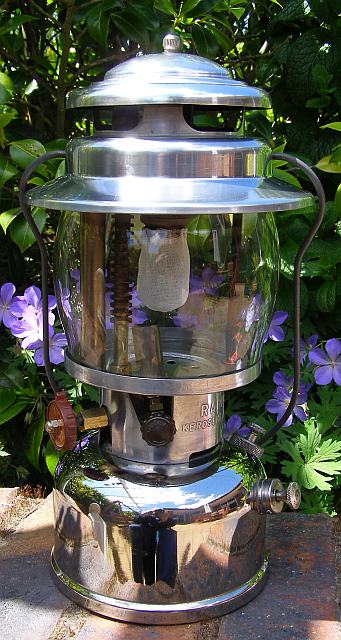

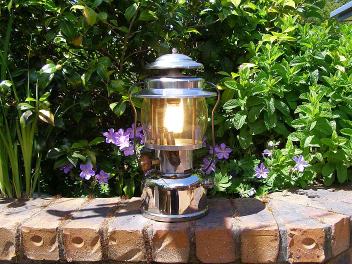

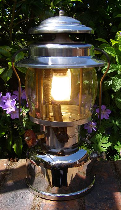

    The pictures show the rapid lighter in action. I left it to preheat for at least 30 seconds before lighting the lantern. As you can see, these photos have been taken in full sunlight so this is truly a powerful light. Finally the problem teenager has been straightened out and is working nicely as it should do :clap: .
