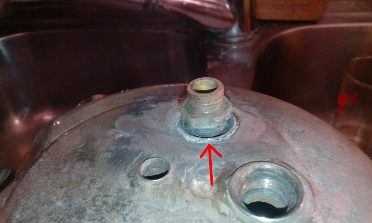

    I bought a very dirty Coleman 238B today. After dissasembly I discoverd that the rapid heater has been soldered very badly. I removed as much solder as possible and now the threaded part (red arrow) rotates in the tank but I can't seem to remove it.
    Does anyone know how it is attached on the inside?

    Hello Hans and welcome to the forum. I don't have a 238B but on most lanterns, the rapid heater is fitted into the tank and held with a nut which is then sealed with solder before the base plate is fastened in. It should be possible to solder around the fitting to hold it in place but make sure everything is as clean as possible, including the inside of the tank so that the solder will have a good hold.

    In Coleman terminology your problem is called a spun bung. It is also quite a common occurrence on the 500 stove.
    The fix is as Henry said: clean and flux well and re-solder. While you are at it, it may be a good idea to re-do the other two bungs too.

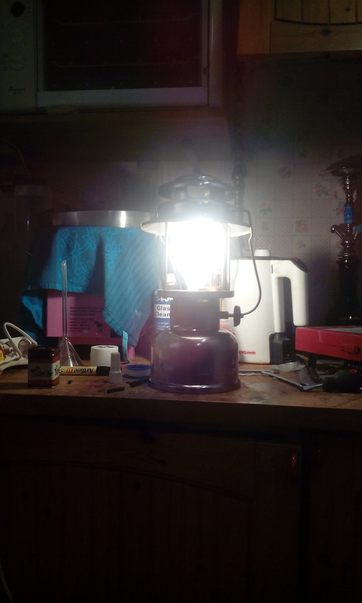

    Finished the lamp today. not the best soldering but its airtight.

    G'day Hans, the soldering looks fine :thumbup: . The lantern has cleaned up nicely and is burning brightly. Congratulations :clap:

    Well done. The repairs are mostly hidden by the collar, so I wouldn't worry too much about them. The main thing is that the lantern lives again.
