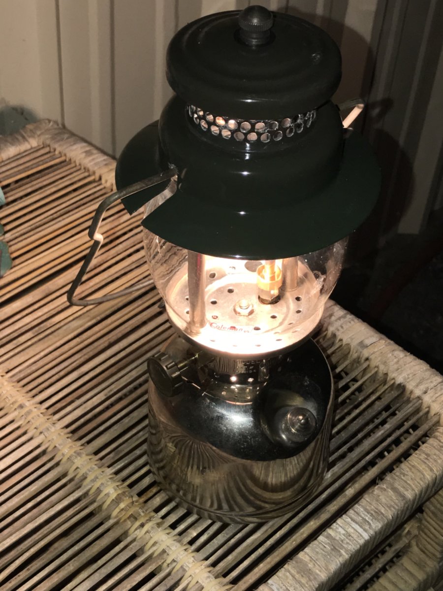

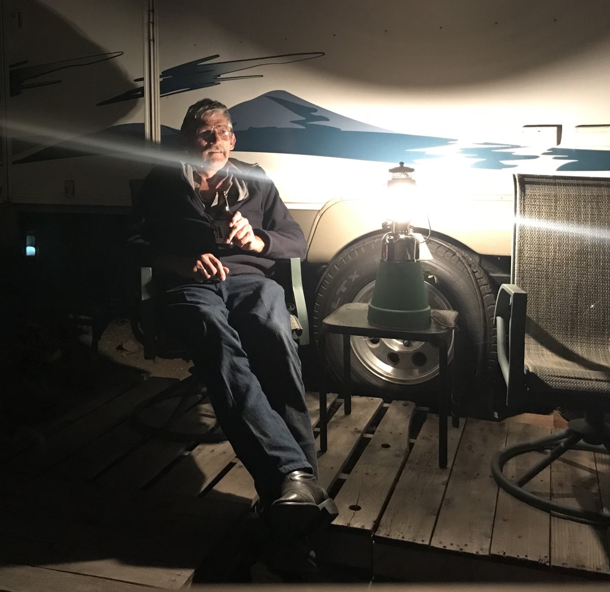

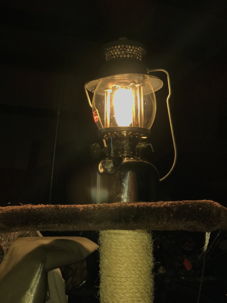

    F7BDA322-6C10-4144-BD45-297E48BE6E2C.jpeg C0A812D7-43AB-4AF3-A6A9-595541275E70.jpeg C516E248-6D2D-4D58-8B0D-A297039C3E78.jpeg So I think I’ve found my new favorite lantern. Finished fettling this Coleman 242B 12/1940. Love how bright it is.
    After reading some comments about these great lanterns, I noticed a few differences from my other later model 200 & 200A lanterns. The burner is all steel, the top assembly is cast iron, the generator but is steel. Any ideas as to which globe it uses?

    It would usually be a green lettered globe spelling out Colemen. The lettering would be large with no sun burst, and the Pyrex name. Now having said that, I'm not sure where you're lantern was made, Wichita or Toranto. I figure Wichita.:-k

    @george thanks for that info. I almost bid on the incorrect globe. Mine was from Witchita

    It's cleaned up nicely @goldwinger11 . There a great little lantern. :thumbup:

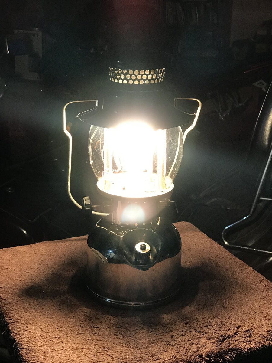

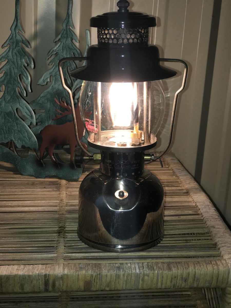

    D85D2B64-45E2-44C3-BF69-0CBD523F1302.jpeg 856AB437-CAD6-4AF6-8FAD-28594192AD6F.jpeg 69452E7D-C923-4159-8921-15FCC20781B3.jpeg An update. I upgraded it to run on kerosene. It’s almost as if it was meant this way. It’s bright, really bright. I used a 201 generator and still the same 2C-HG mantle.

    Great lantern you've gotten going @goldwinger11
    Prior to the conversion to kero, what did you use as fuel?
    From the pictures, its really bright whatever the fuel.
    The 242 has been reputed to be one of Coleman's best-made lanterns.
    If you've got a steel burner, its probably an effort during the War years.

    @MYN Yes it is a steel burner. It takes a little longer to get up to temperature. Before the conversion, I had Coleman fuel.

    @MYN A few reasons. Kerosene is about 2/3 cheaper than Coleman fuel. It is safer because it has a much higher flash point. Fuel consumption is lower due to the smaller jets or nozzles on the generator. I also have kerosene heaters in my shop that I use in the winter, so only having one type of fuel is more convenient. And the light output on some of the lanterns is higher. Besides, it’s fun.
