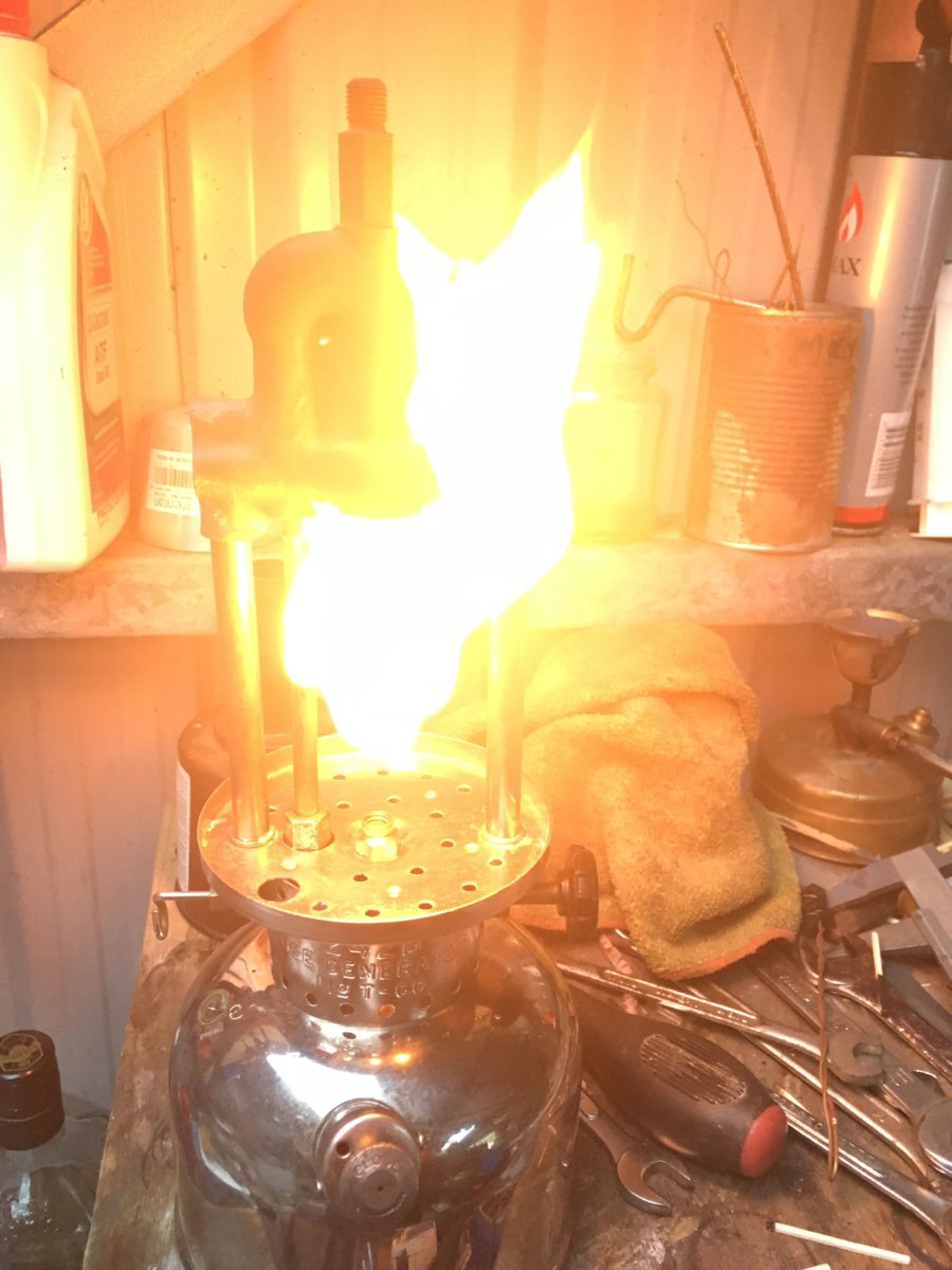

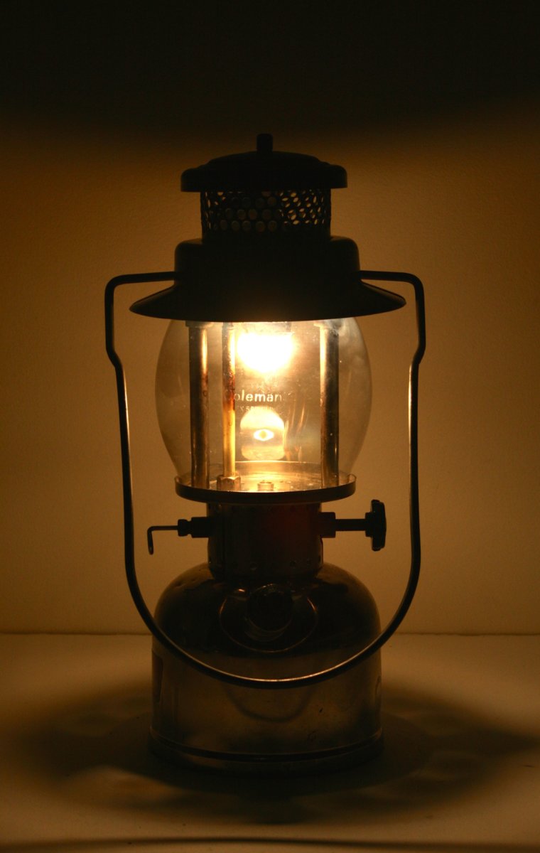

    Here is my Canadian-made Coleman 242B, 6/1962 (mentioned here).

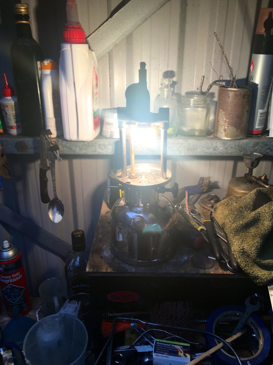

    Now, starting it was a bit of fun:
    First attempt with old generator.
    Then with new (Coleman 201) generator.
    Then with a test mantle.
    It's working very well.

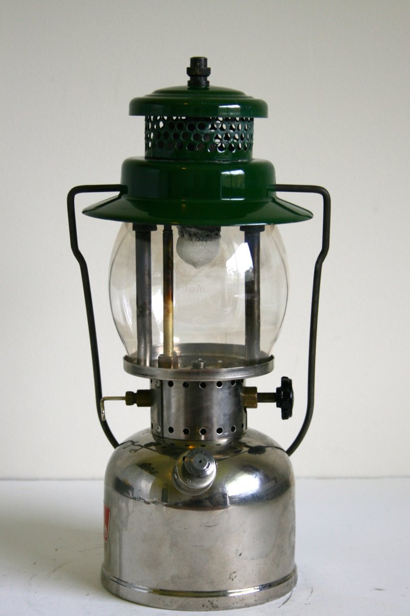

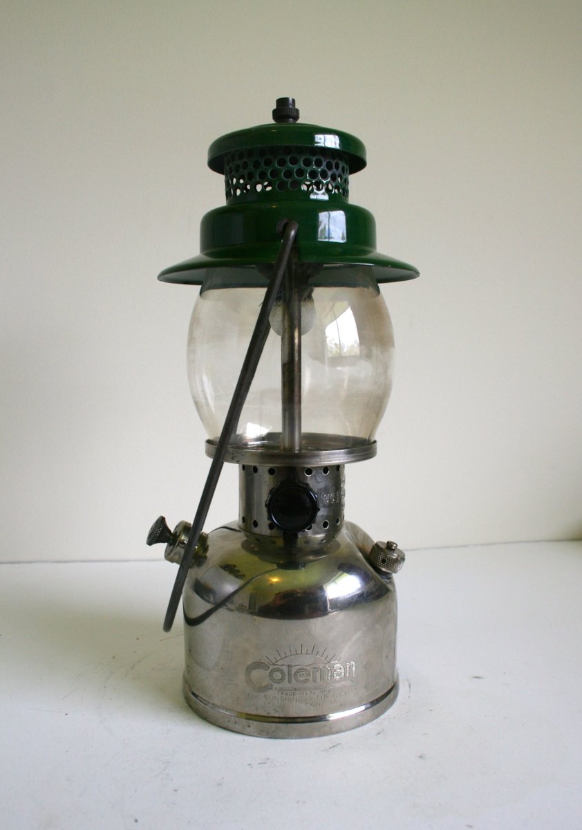

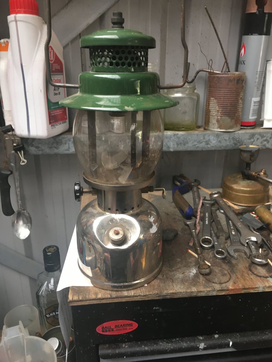

    As it came:

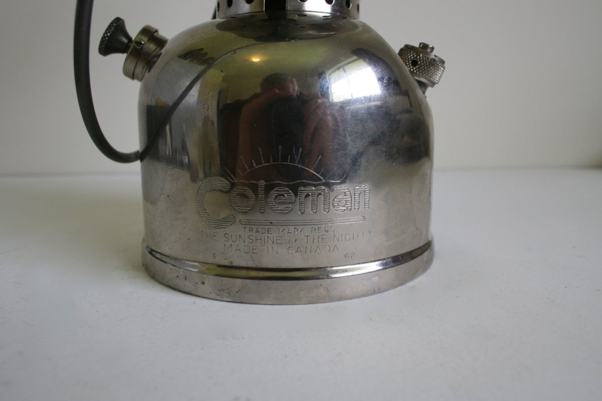

    NOTE: the 6/62 date of manufacture is the latest in the CPL Reference Gallery.
    Another tidy little 242B to have as a user.

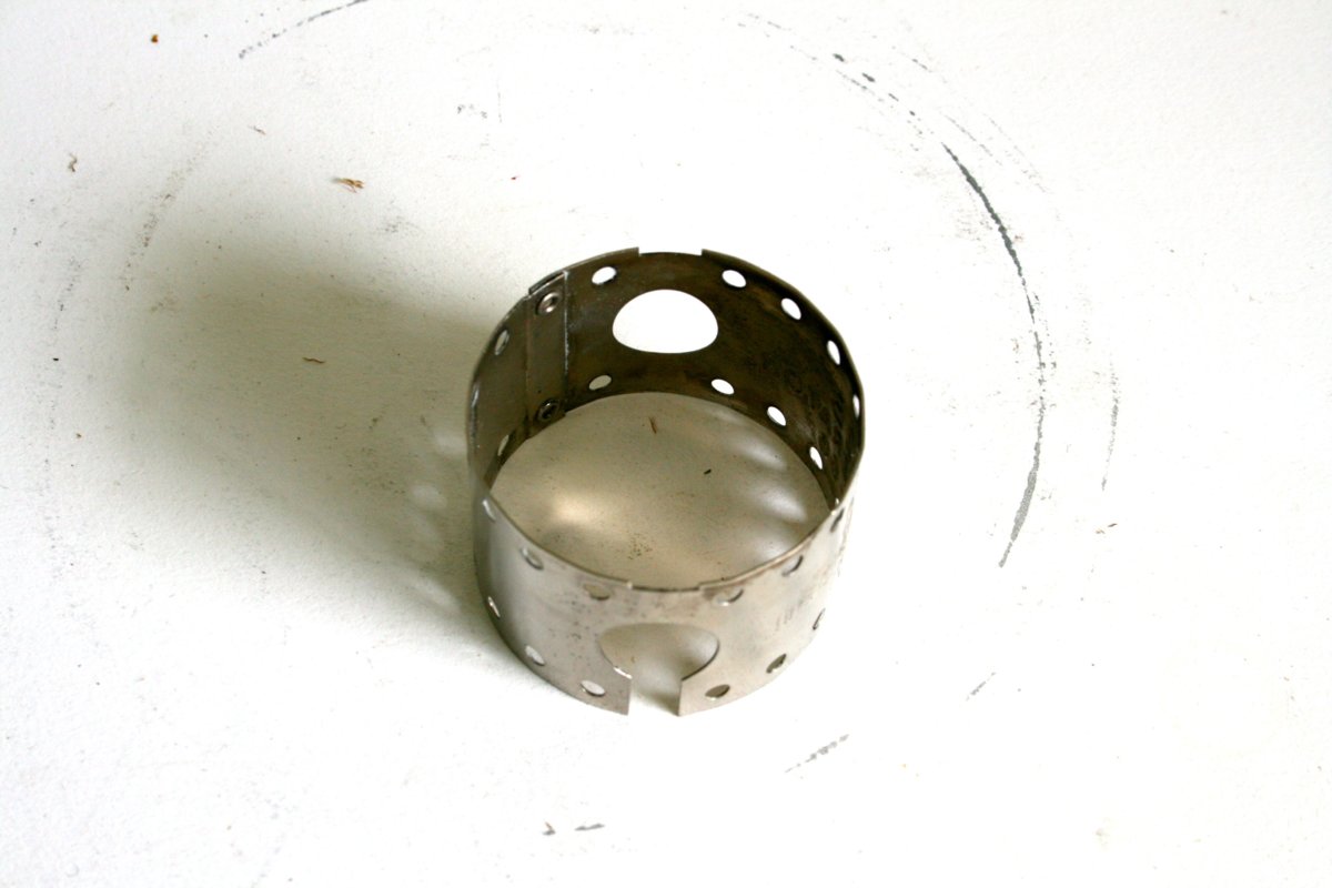

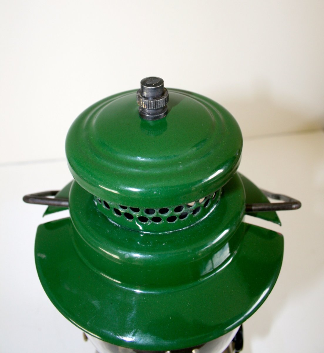

    Now, here is a question to Coleman aficionados.
    What is the correct way to place the collar on a Coleman lantern:
    1. With the circular hole facing the control spindle and the key-shaped hole to the pricker control handle; or
    2. visa versa?
    I've looked around and seen it both ways...

    As far as I know, the factory shipped them with the slotted hole on the fuel valve side.

    @phaedrus42
    I thought that was correct. In the photos above it’s on both ways. I settled on the way you indicated.
    I found this illustration on Doron Papo’s (excellent) website.

    Definitely slotted hole fuel valve side !
    A nice late example Tony !
