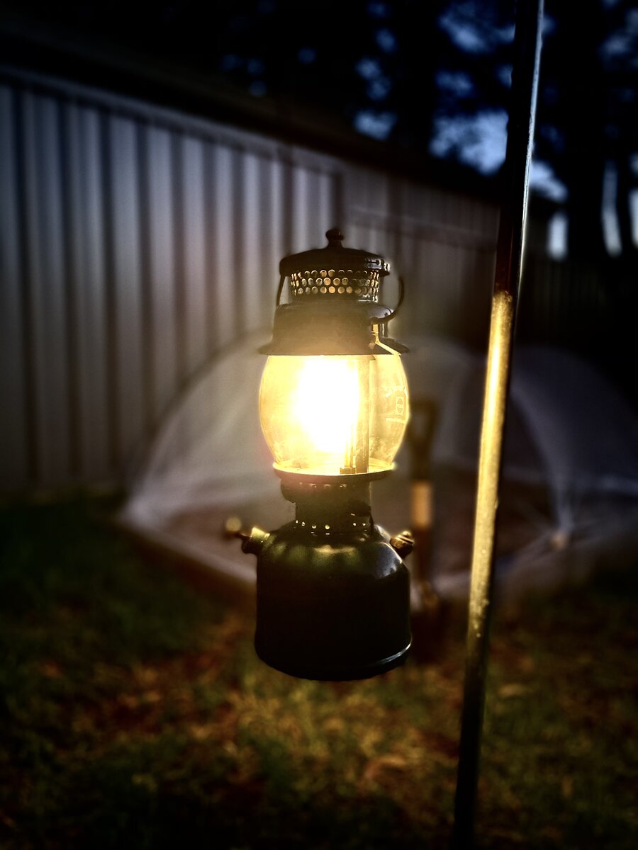

    Haven’t posted on here for a while, time to light up a favourite...

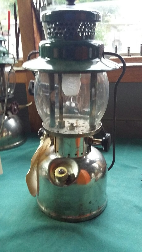

    Yes, 'seafoam' is the term used in the U.S.A. To me it's a dull, flat green, and I must say I don't know how it could be buffed up. But that is the only example I have, and I would prefer the dark green gloss colour, same as the hood. Unfortunately the founts were badly dinted when I found them. One is Australian, the other two Canadian. Pics below. Cheers. Paul.
  13. MikeO
    MikeO Subscriber
    Jan 14, 2014
    197
    That 249 is a rare bear with the collar painted seafoam as well. Nickel was still in short supply so paint it was. The dark green vents are seen on them as well as seafoam vents.
    Seafoam was never a high gloss paint, but any paint restoration compound like car collectors use will remove the thin layer of dirty and oxidized paint. Followed by a good car wax, they are quite striking when cleaned up. But it's your lantern so none of my beeswax! Lots of people would like to have that seafoam 249!
    Mike.
    Mike.
