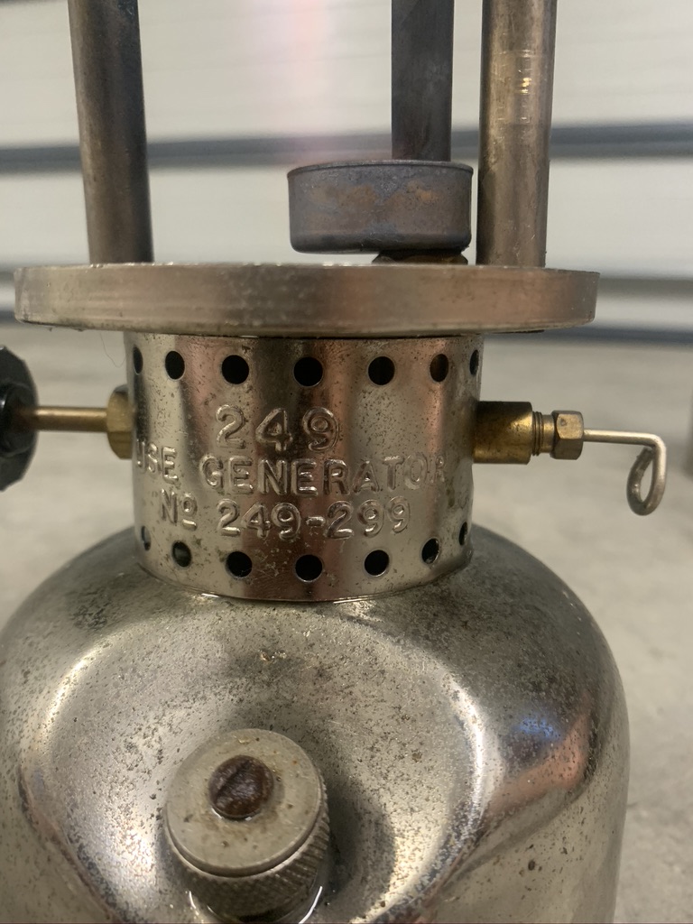

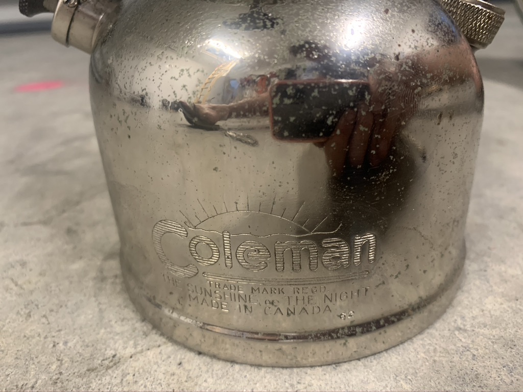

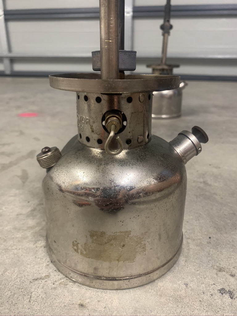

    Hullo! I picked up a pair of lantern at a dump/recycling store, and thought I'd test light them tonight. One had liquid in it, so I filled the meth cup, pumped it up, light it, and holy cow: it's a flame thrower.
    The bent wire lever lets the lantern run at full afterburner when up, but stops the stove when down.
    The lantern got rather hot rather quickly... so shut it down, put it outside, and watched it warily for a while.
    Any ideas? Thanks!

    The Coleman 249 was predominantly designed for kerosene with the hole of the Canadian 249 jet, part number 249-299, being 0.006”. Your 249 is a Canadian version built in January 1962, if I read the date stamp as “1 62” correctly.
    Yes you can use a Coleman fuel or petrol, with a preheating, in the 249 however usually the jet size for lanterns using this type of fuel is 0.007 and above, slightly larger.
    The 249 will run more efficiently on kerosene and there is a chance that it would run a bit lean (not enough fuel to air ratio) when using petrol or a Coleman fuel.
    Your picture of the flame exiting from the burner seems to be quite good. The definitive test will be when you install a mantle. With a mantle installed the resultant burn will show whether the jet is still OK or worn out. Usually a worn or oversized jet will give either a corona around the outside of the mantle or in very worn cases, a yellowish dull light with some black spots appearing on the mantle. Basically, a worn jet will cause the burn to be too rich, too much fuel to air ratio.

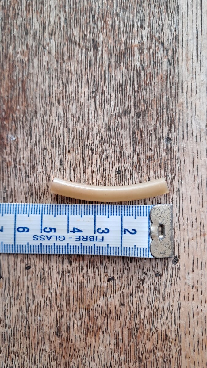

    Couple of questions, looks like my 249 had something extra in the font. Hope it was not for something specific. Piece of fuel line. Obviously hard from years. Was this part of the lantern? Maybe someone was trying to siphon out the gas one day .
    Secondly, looks like no needle in generator. The generator was not fitted, just attached by wire to side , so it may have fallen out.
    Should this be an issue?
  21. ROBBO55
    4,424
    @Kiwibrucey
    The plastic is not a component of the lantern.
    Without the pricker it will work fine until the jet starts to block. Then you have to pull it apart to manually clear the jet. It will become very annoying very quickly.
