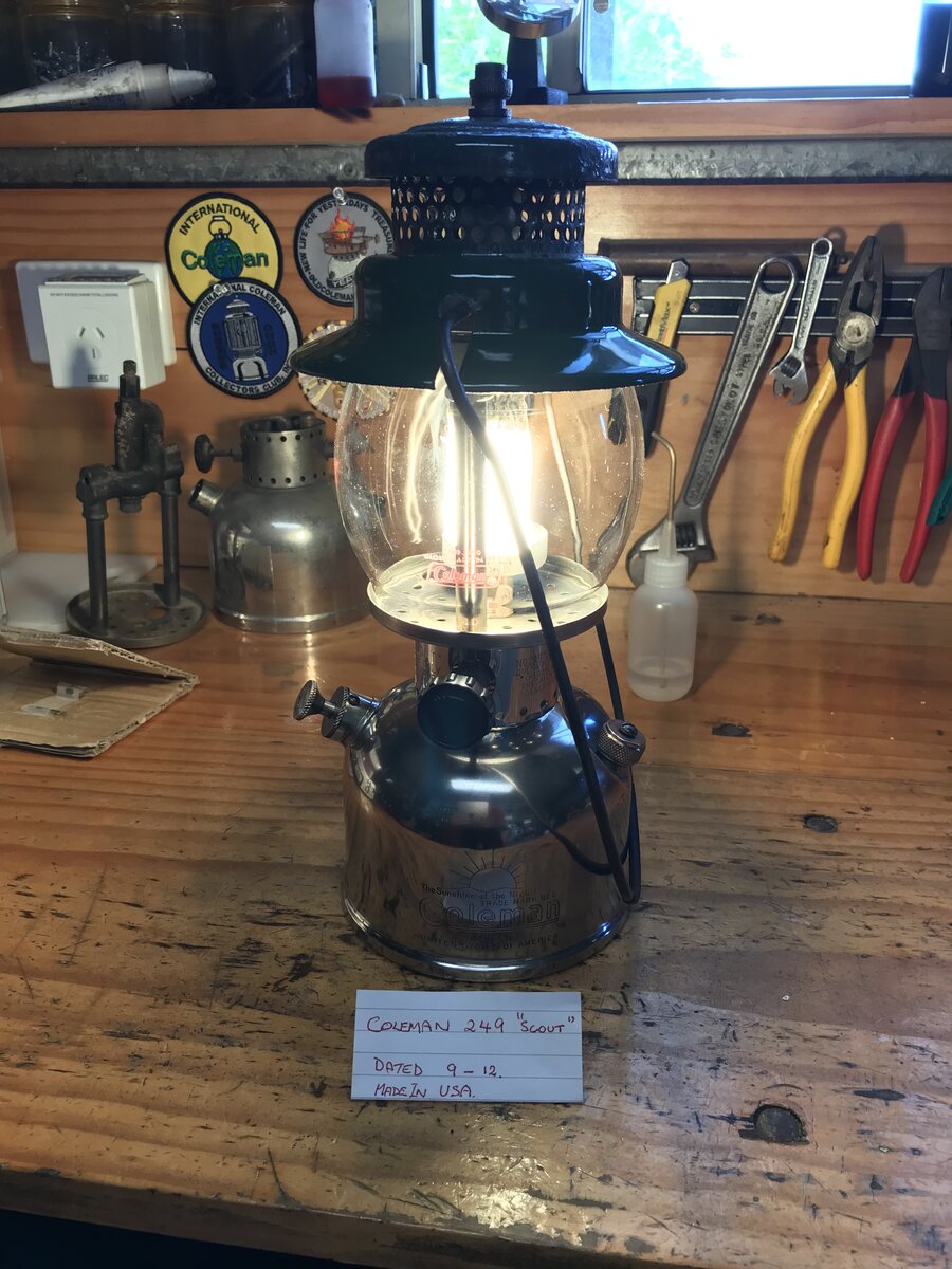

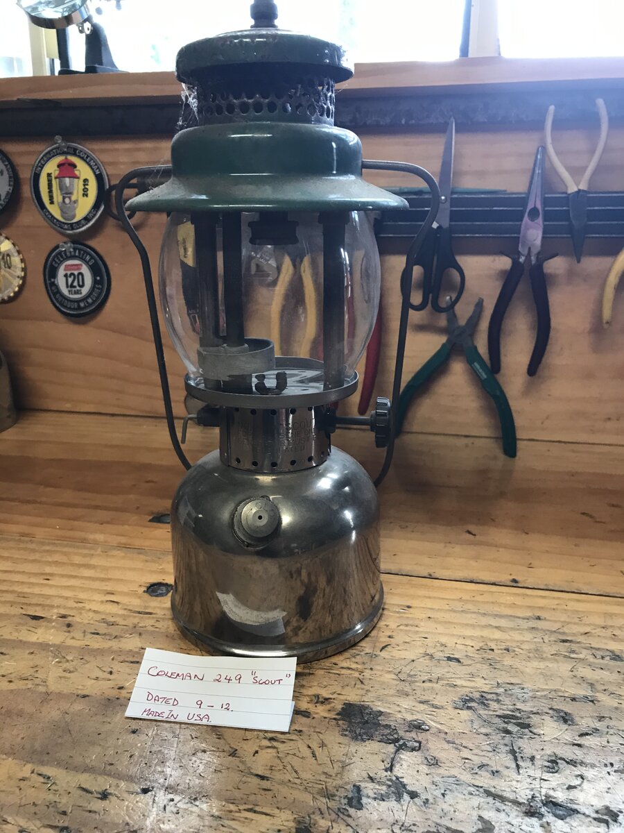

    I’ve just fettled this Coleman 249 kerosene lantern. I have several 249s however this is my first model that’s made in USA, the others being made in Canada and Australia.
    Before
    Fettled
    She is easy to light
    and burns very bright
    I’m a poet
    and didn’t know it! :lol:

    Beautiful lantern Pete. Usually find Canadian or Australian 249s in Australia...in fact have never seen a USA 249 in the wild in Australia.
    Was it found locally or imported? I have found a single UK stamped 237 and 249 in Australia however.
    Cheers Peter

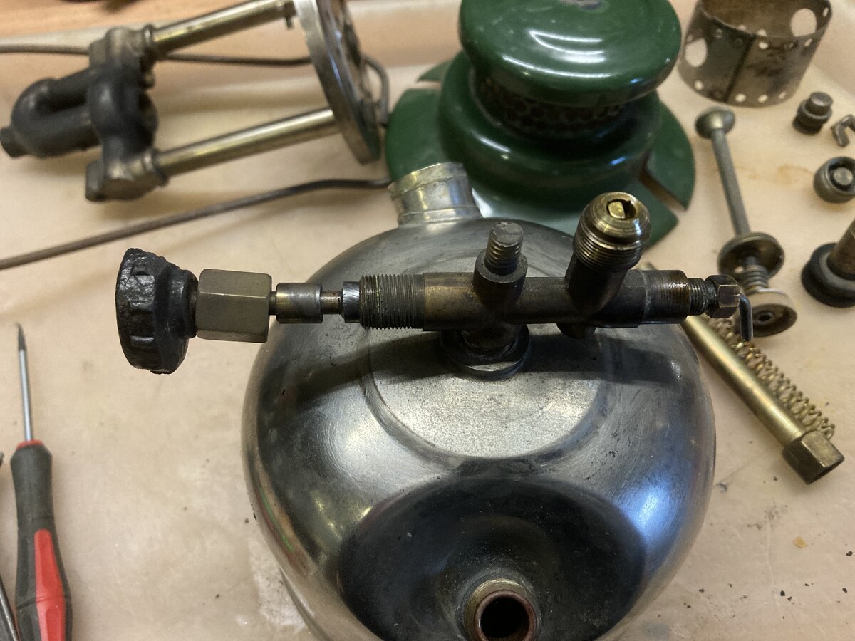

    That looks great Pete, brilliant condition! The timing of your post is most fortuitous as I was about to post a 249 fettle question that I expect you may be able to answer. I am stripping down my 249 and I have got to the valve and cleaning wire, freed the nuts but can’t get any further without risk of damage, which I’d rather avoid. I assume the plastic valve stem wheel will just pop off with some persuasion? It’s seen better days anyway. How does it work at the cleaning wire side? There must be some kind of packing in both sides I assume? It’s turning but doesn’t appear to unscrew? Thanks.

    The jet cleaner needle mechanism is mechanically independent from the valve shaft that includes the plastic valve knob. The valve assembly screws completely out of the manifold. The following picture is of a 242K that has a similar valve setup albeit it has a plastic wheel for the needle mechanism instead of a bent rod.

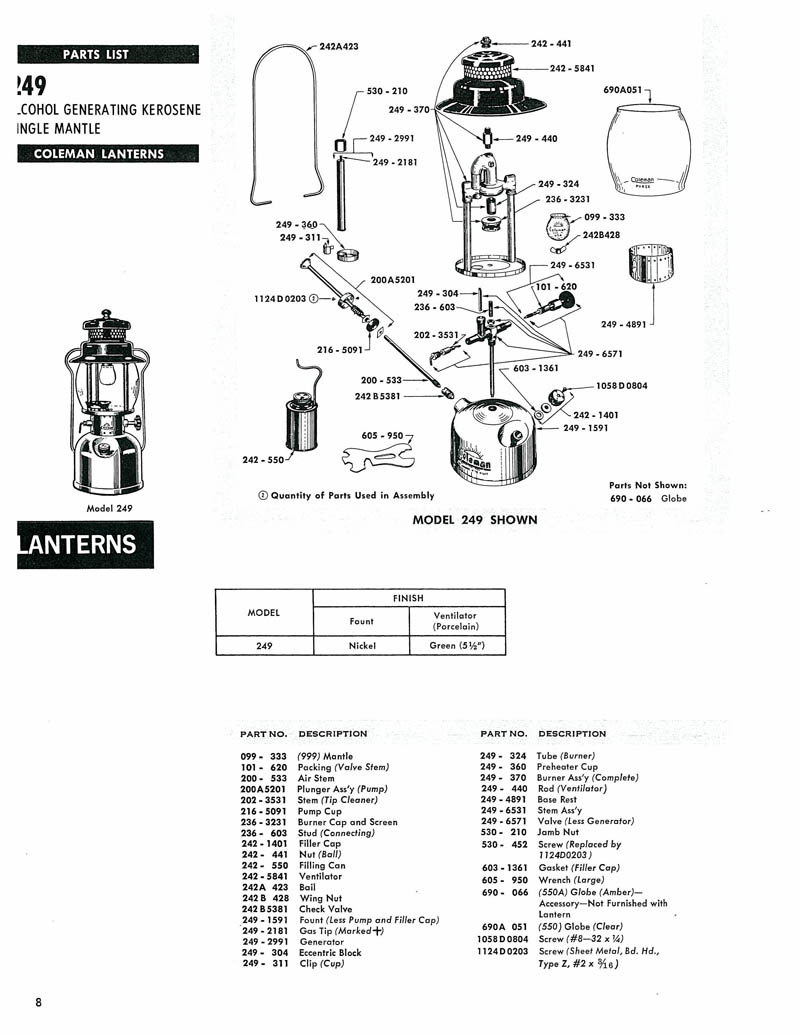

    Here is the 249 parts list for further clarification.

    The plastic wheel, as far as I know, is moulded to the valve shaft and has not been designed for removal.
    I would think the best bet here is to replace the valve shaft with a similar one, perhaps from a 242B.
    Hope this helps.

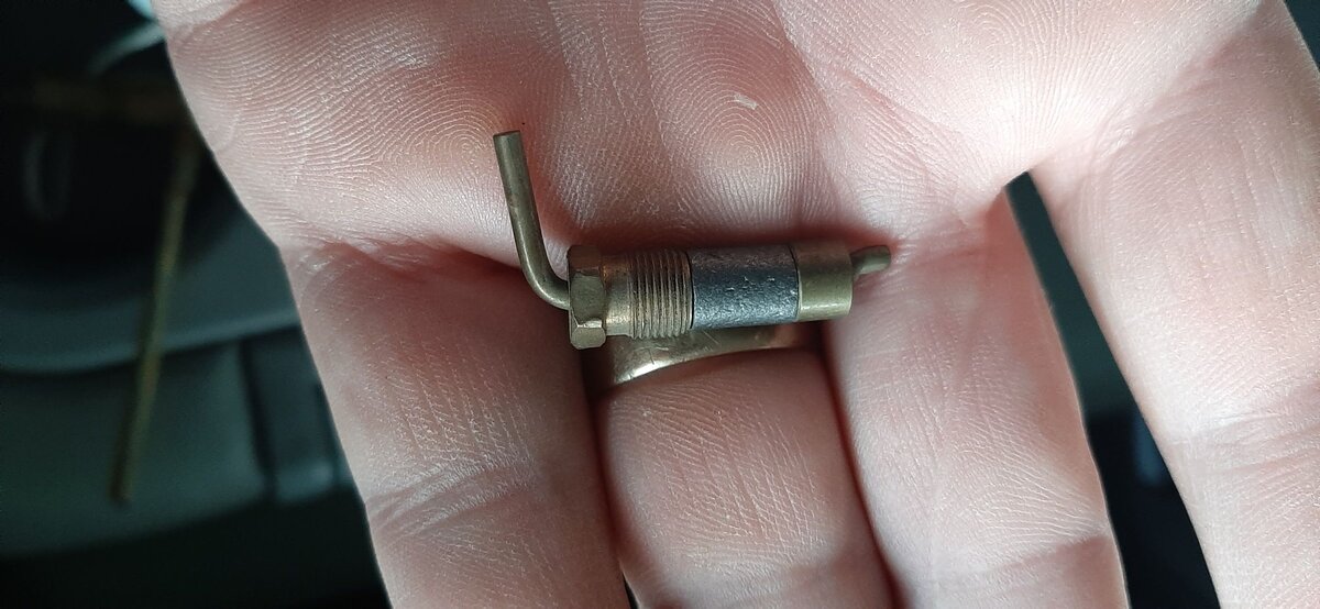

    In reference to your intention to dismantle the cleaner wire actuator. I would advise against it if it works, that is if rotating the offset stem moves the eccentric block (and tip cleaner) up and down by 1.5-2mm est.
    If you have to, yes, the actuator (242-353 or 202-3531 tip cleaner stem complete) is sealed with graphite. The graphite is compacted by the threaded ferrule, and is formed into the valve. I believe that once the ferrule is unscrewed from the thread, it is the graphite that holds the stem in place, and pulling forcefully eventually results in the wire stem straightening and leaving the font brass part and graphite packing in place. It is so difficult to remove that I do not know if it can be re-used.
    I have been told heating it up helps, but I destroyed (graphite pulverized and stem straightened) the 249 tip cleaner. Fortunately I had what I believe is a complete 201 tip cleaner (I attach a photo), and it fits and works.
    In a pinch I imagine one can reshape the wire if it was bent during removal, re assemble and pack it with graphite sheeting or strands again. Coleman tip cleaner stem.jpg
