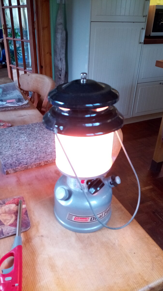

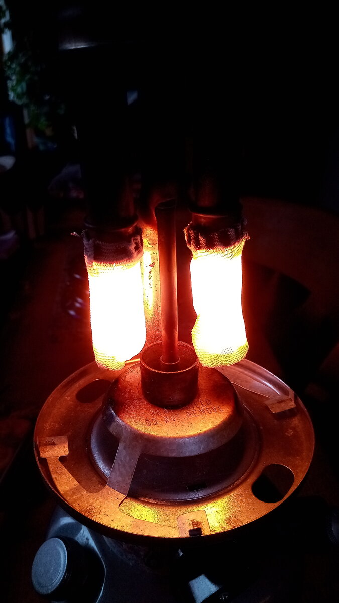

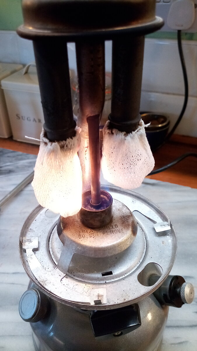

    I've been meaning to do this for a while now so with no other lantern related projects on the go I went ahead and did it.
    1. Remove the old generator.
    2. Grind off the flared end and remove the jamb nut.
    3. Replace the generator for a 639 model.
    4. Add a pre-heater cup
    5. Reassemble everything.
    6. Fill tank with kero
    7. Fill pre-heater cup with meths and light.
    8. Wait until meths is almost used up.
    9. Open valve and away she goes!
    Apart from the potential safely issue with the Schrader valve when it eventually needs a new o ring, I have 1800 litres of kero in the central heating tank at any one time and it costs 50p per litre. It's a no brainier really, especially as the new heating fuels are now low sulphur.

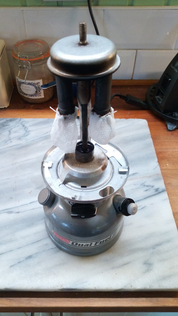

  14. ColinG
    3,313

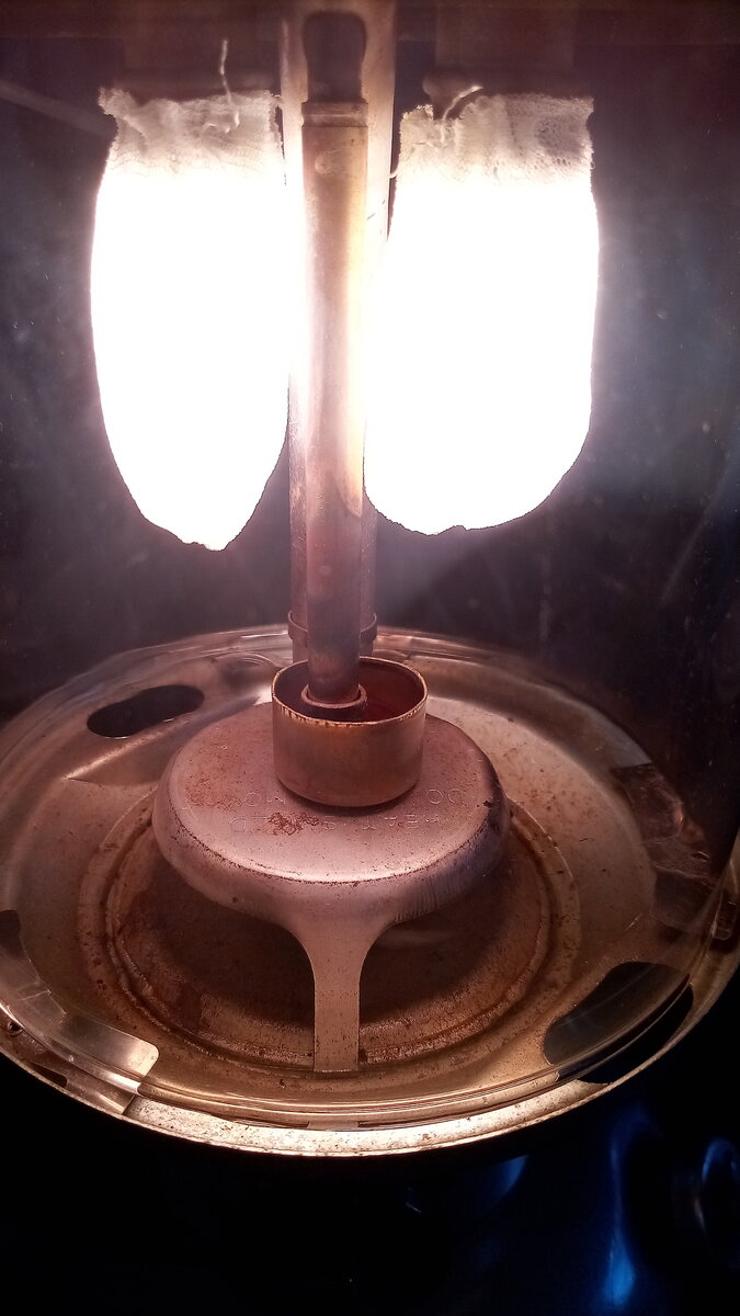

    Here's my 285 with a pair of odd looking mantles also running on kero. I seem to remember all I did was change the jet but it's a long time ago now and I didn't document it. I added a frosted globe which gives a nice diffuse light. When it cools down I'm going to put some new mantles on as these aren't brilliant.

    So I've replaced the dodgy mantles with two pink top Chinese sock types that work well. I was lucky with this pair, often they split or form holes and the ties can be very fiddly to fasten but these are working well.

  18. ColinG
    3,313
    I agree, I've had so many failures with them but they are just the right size for a lantern like the 285 or 214. I took a chance this time and go to lucky but they are so variable. Norman in the US has had a much better experience with the pink tops whereas the green tops always fail for him. We decided there's probably a few different factories Making these with vastly different quality control regimes.
