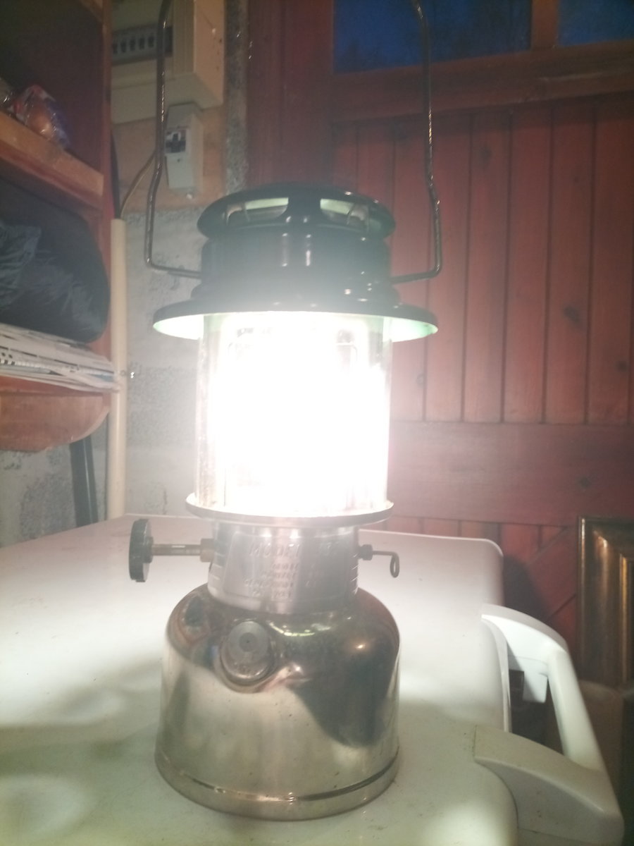

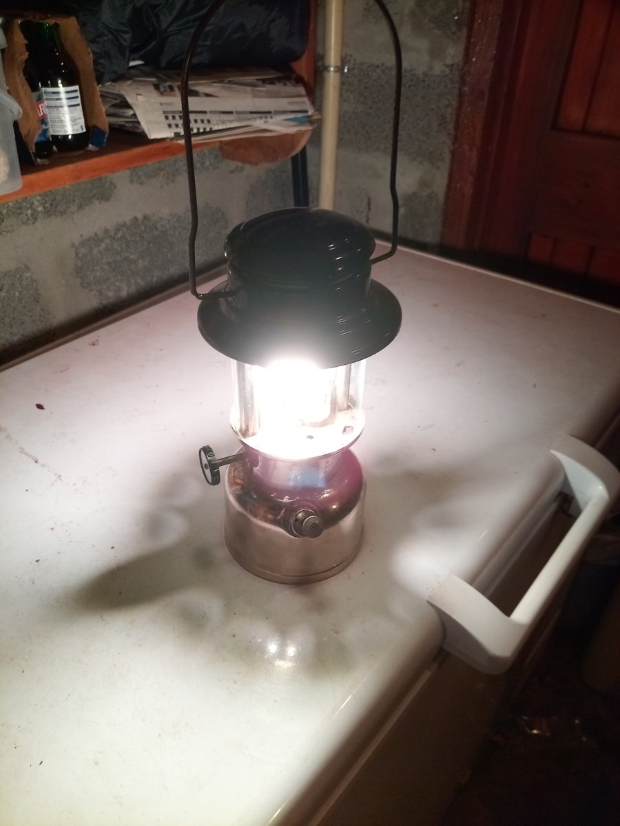

    I've had this for a few weeks but only today did I get round to finally finishing it.
    The fount was suffering from quite a few rust spots and once treated they left some pitting behind, but the collar, frame and hood all cleaned up nicely. The label has come off but I can reattach it easily enough.

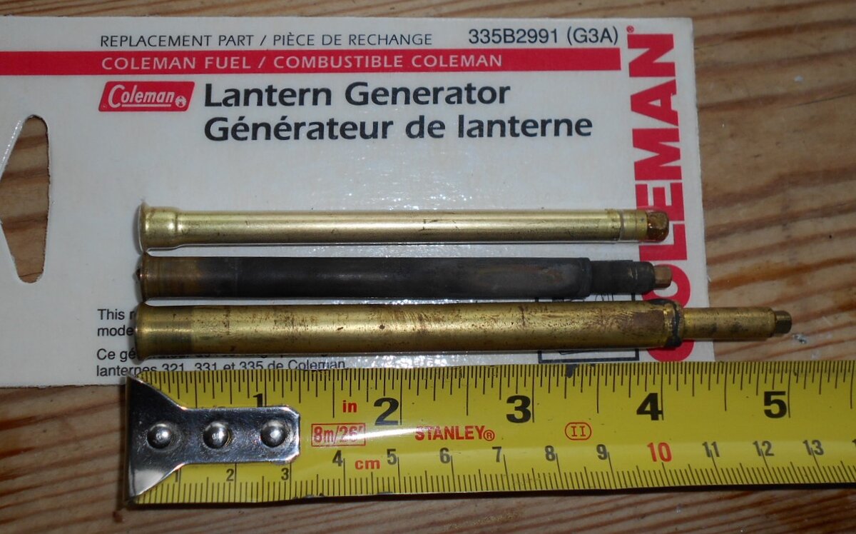

    I hadn't planned to convert it to kero but the first time I tried a test lighting I discovered that there was a blockage in the generator and the pricker needle had broken so I swapped it out for a 339 genny and a pre-heater cup and she roared into life. Thanks to finn-emm (that's his eBay handle because I've forgotten his CPL name!) for the lamp and replacement control valve and @Norman for the pre-heater and loads of other help.

    That looks quite bright

    It's cleaned up nicely Colin. :thumbup:

    Lookin good Colin. She certainly runs bright. Well done.

    And as stated these little lantern are very bright.

    It's very bright and starts after half a cup of meths - almost as good as my Veritas Superb!

    Out of interest, when lit, is it more of a gentle roar than a hiss? I'm working on a 339 and although bright, it is noisy in comparison to Tilley
  10. ColinG
    2,294
    Not really a roar... maybe a bit louder than a Tilley but most Colemans are a bit noisier... then again most are a lot brighter too!

    So, what did you do about the 335 fuel-air tube in the fount , Colin?
    Also, did you know that the top end of burner tube on the 335 is restricted but on the 339 it is just a straight tube?
  12. ColinG
    2,294
    I did nothing apart from change the generator and it seems to work perfectly. It burns evenly, it's very bright and although it's noisier than a Tilley it's about the same as most other Colemans I've used.

    Nice conversion well done.. a gem , myself I converted a Coleman 295 dual fuel to run on kerosene by swapping the generator tube for a 639 tube .. an exact fit and adding a copper pre heat cup .. worked great .. but the glass suffered and was cracked with the heat. Now a Coleman 639 lantern has a bulbous glass piece a little further away we see from the mantle.. it was probably designed that way but hey ho just keep watch on the glass good luck:thumbup:
  14. ColinG
    2,294
    That's a great idea, Alby. I have a bulbous globe and a 639 generator as well I think, so this may well happen soon.
