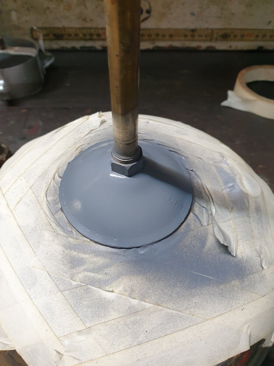

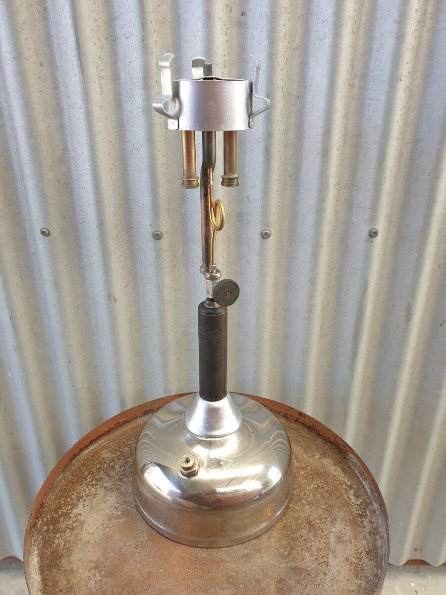

    This USA Coleman CQ is unmarked on the fount and has only the 1919 patent stamped on the air tube. It has a CQ stamped on the fibre handle which is the earlier taller 4.5" version. I have fitted a suitable shade (Aladdin 9 7/8" 702 style ribbed opal white milk glass) onto the Q63 three pronged shade holder.
    I had issues with the Q99 generator and replaced it with a reproduction Q99 generator from Old Coleman and it has the original square nut holding it on though the flange was slightly smaller. I used a thread sealer to ensure a good fit.
    I cut my own lead washer 19 mm OD and 12.54 mm ID to seal the filler cap which required a good clean. The bell nickel plating was flaking too much and I stripped it and painted it with a cheap chrome paint. The underlying metal fitting was wire brushed and then painted grey to stop the rust getting out of control again.
    Tested the lamp again without expensive mantles and it burned very nicely indeed.

    The centering washer at the top of the fibre handle got an initial spray.
    With the Q63 shade holder fitted.
