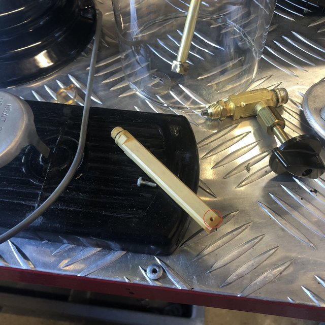

    This evening I'm looking at my Coleman 285-700 duel fuel lantern and can't for the life of me get it to light. Tank is full of fresh fuel (panel wipe), generator is new, pump is renewed so tank pressure is good. 30 strokes of the pump, open control and pop my lighter up to the mantle. I can hear hissing of air and its strong enough to blow the lighter flame away from the mantle but it won't light. Obviously no fuel..! But how can I have air and no fuel with a full tank? I know the nrv is stuck as I have to keep my thumb over the hole in the pump knob as I lock it off but its been like that for ages.

    When I have had that problem with lamps etc., it has been caused by a damaged or broken off fuel feed pipe.

    as Jeff said above, it’s sounding like your fuel feed pipe, in the tank is broken or the bottom of the feed pipe is plugged with gunk therefore only allowing the air at the top of the tank to feed without fuel.
    You will need to take the valve assembly off and screw out the feed tube to investigate.

    Thanks chaps. I'm thinking it's more gummed up than broken as nothing is rattling around in the tank.

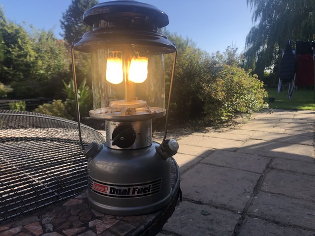

    All sorted and yes it was a problem with the fuel pick up tube. The small hole in the end that sits under the fuel level was blocked. The tiniest of pokes with a fine needle had it clear and I could blow air through. Slightly concerned this may alter the fuel/air ratio like I was opening up the size of a jet?
    The seal was ok and it went back together and lit easily. Ran for about 30 minutes nice and bright.

    You'll have better luck releasing the little ball in the checkvalve with a bit of carburetor cleaner squirted down there, then poke and prod the little ball with the pointy end of a bamboo skewer. Helps to remove the dried up fuel gunk, oily crud, and grime.
    I wouldn't worry about the fuel pick up hole if you enlarged it, it's the generator tip that really controls the lamp brightness. Those you definitely don't want to enlarge.
    On the Coleman fuel pickups, there's also a little opening, or hole, or slit near the top that allows air in to lean out the mixture for lighting. If the bottom fuel pickup is clogged (your situation) all you'll hear is air when the valve wheel is set to the "light" setting. You solved it and to be honest, you've now got experience--and bragging rights-- in the most perplexing of Coleman problems. Good on ya!
