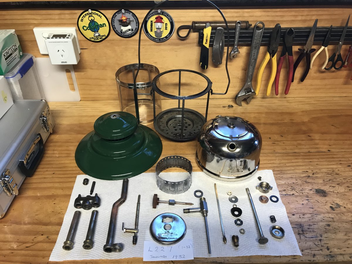

    Here are the various parts, after cleaning, that included a final run in the ultrasonic cleaner.
    The dirt and corrosion was carefully removed from the frame without removing any remaining original plating. It was then spray painted with a high temperature clear paint and subsequently baked at 200degC for an hour.

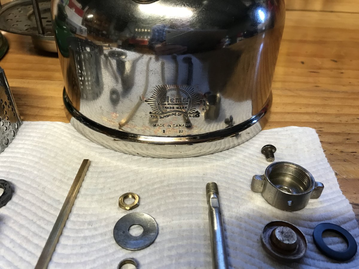

    The following photo clearly shows the L227’s pedigree and it’s date stamp of 1 32 representing January 1932.

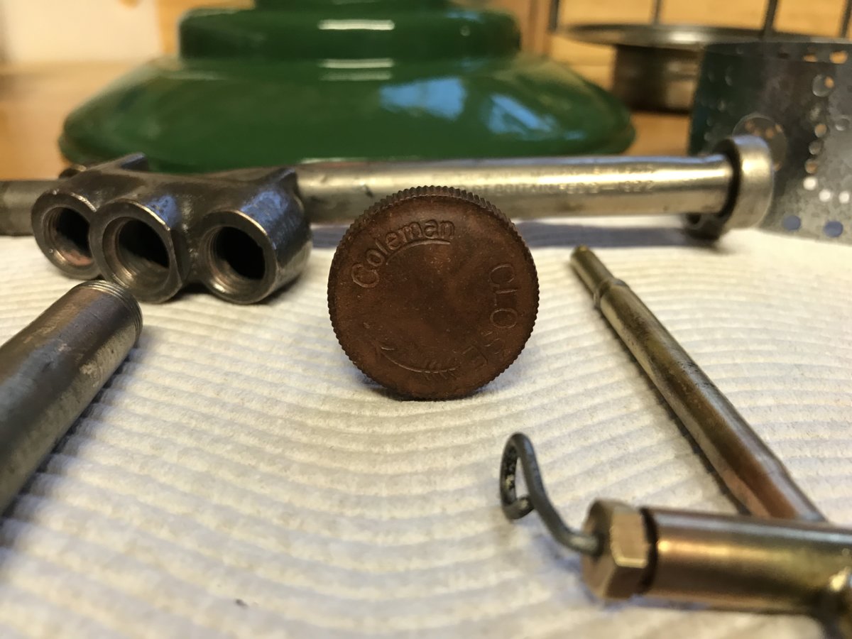

    This photo shows the brown valve knob in better detail.

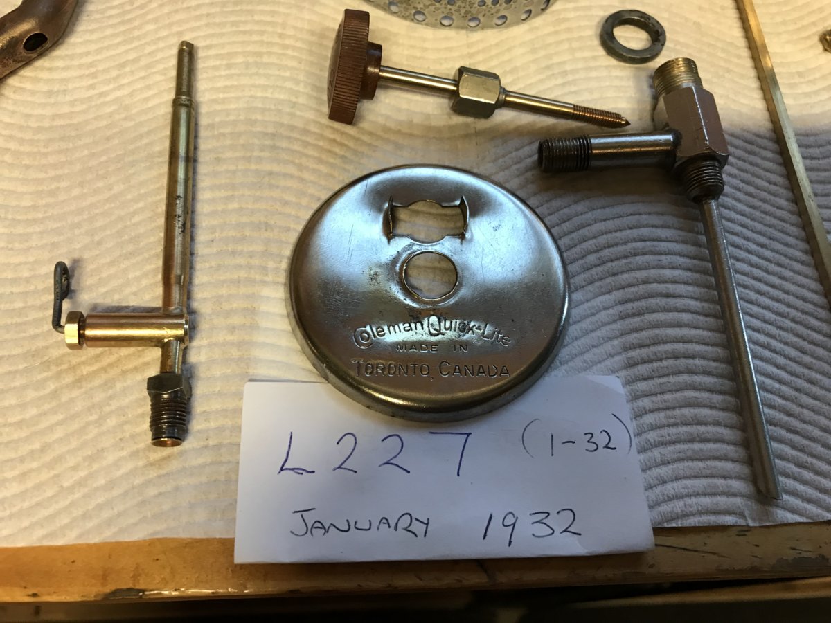

    The L227 came with a R55 generator. I like to use as many of the original parts in the restoration so the generator was cleaned, and de-coked as much as possible and successfully reused.
    The fuel valve’s graphite seal packing was replaced.

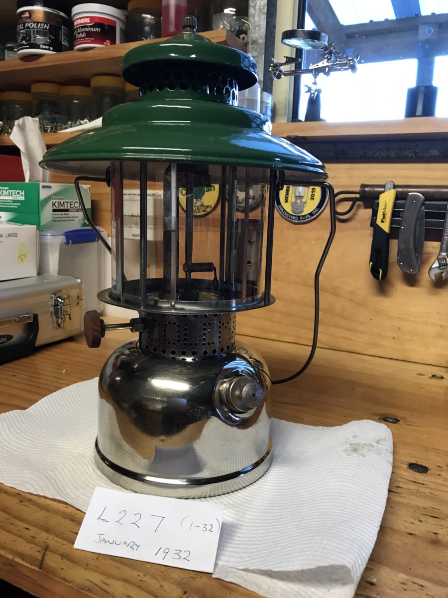

    The final assembly with the L227 sporting one of a Fred Kuntz’s fine mica chimney reproductions. The lamp now has the correct ball nut retaining the hood.
    Now the money shot ......
