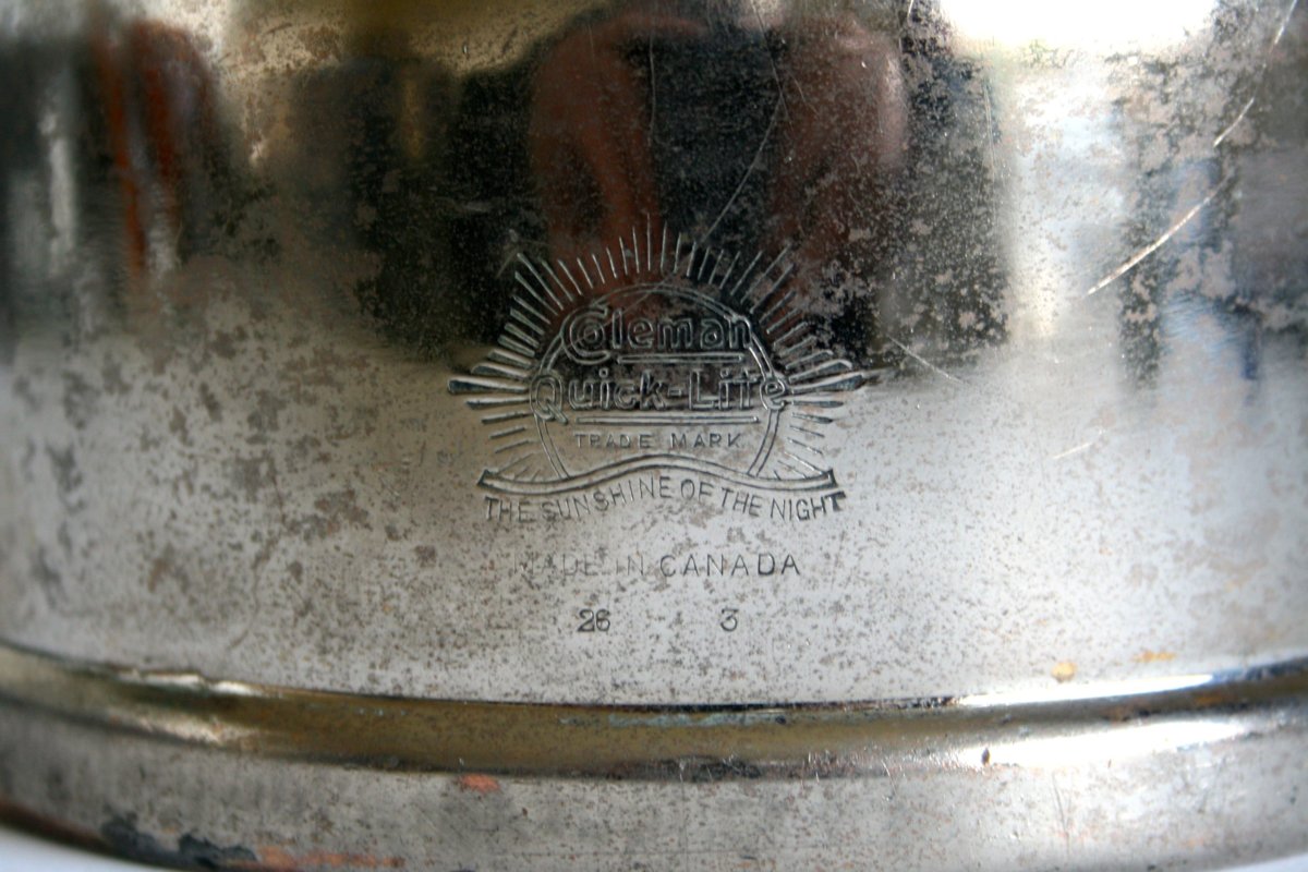

    Here is my resurrected Canadian-made LQ327. It was in pretty rough shape when I got it.
    Here with a Fred Kuntz mica globe after fettling.

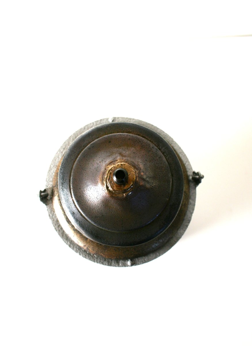

    Brass 2-piece hood (vent) -formerly nickel plated, but the nickel was long gone. Note the repair (brazing a plate on the top of the cap and drilling a hole for the stud).

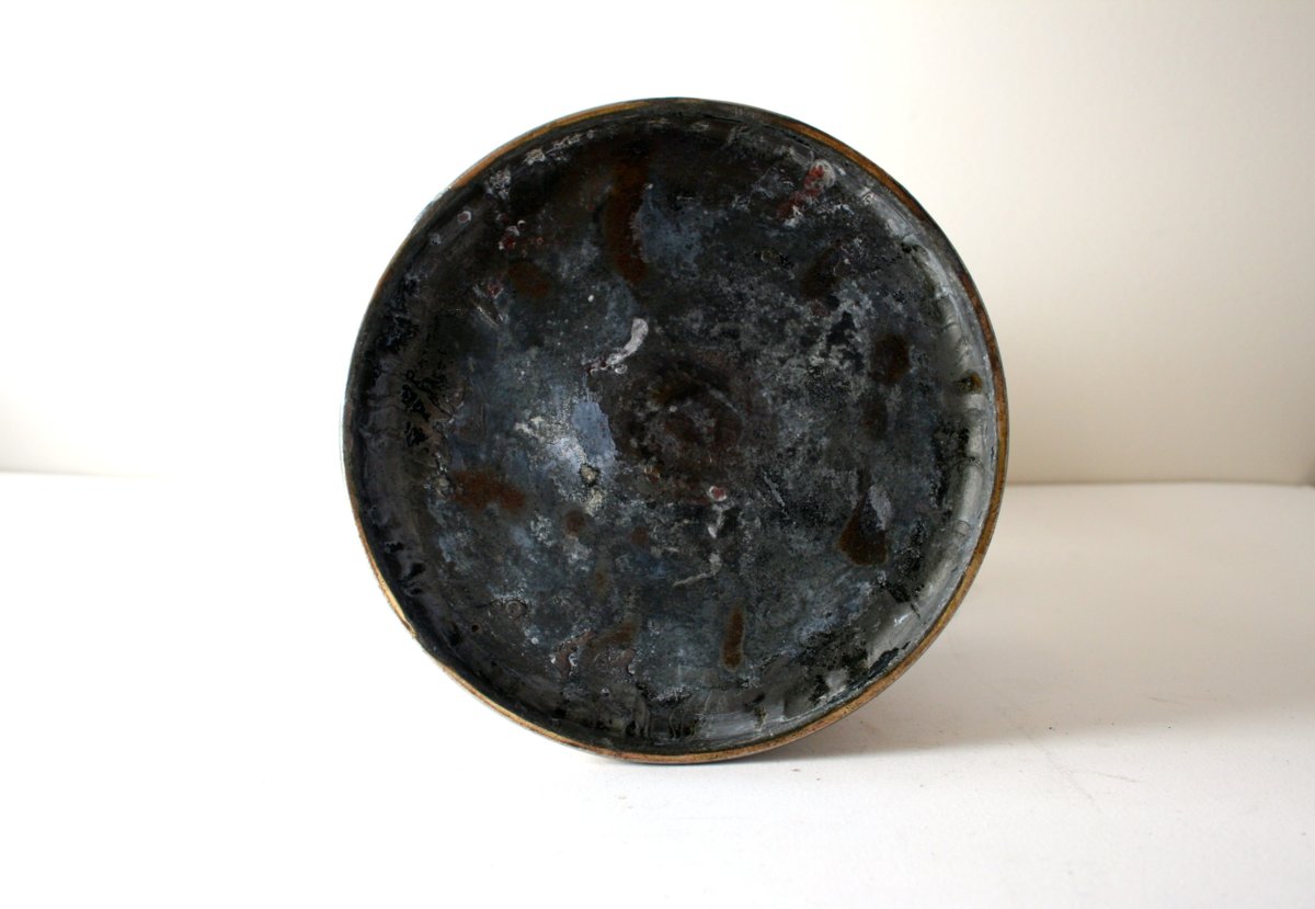

    The bottom of the tank (steel) had been reparied or refitted at some time in the past. It was rusty on the inside.
    "Coleman Quick-Lite Made in Canada 26 3"

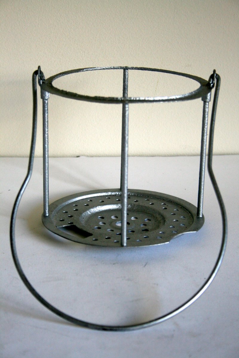

    Fettled and painted globe cage.

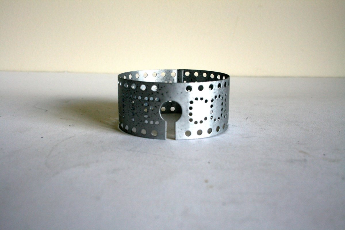

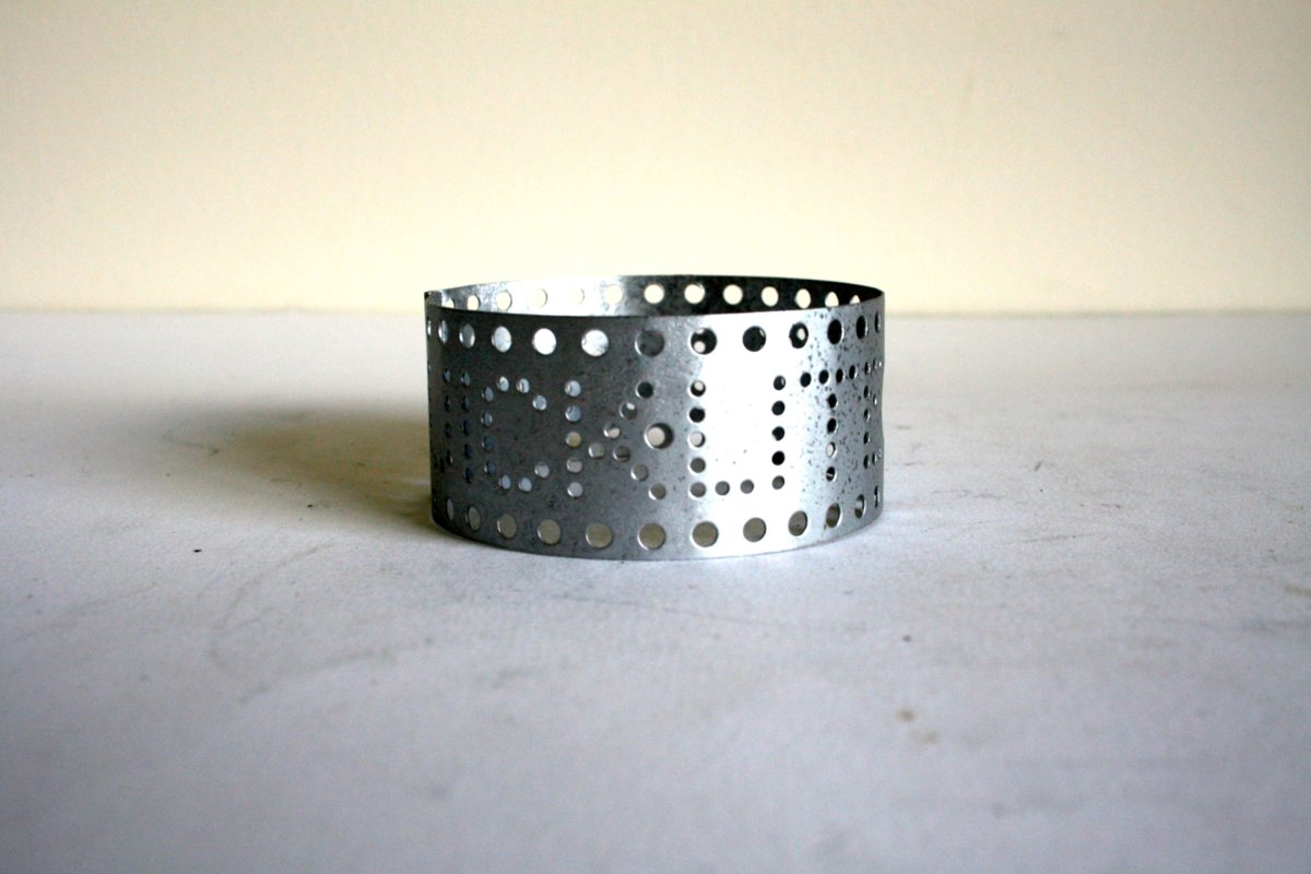

    Note the after market hole cut in the bottom of the cage to allow the lantern to be lit when it was fitted with a glass chimney (globe).

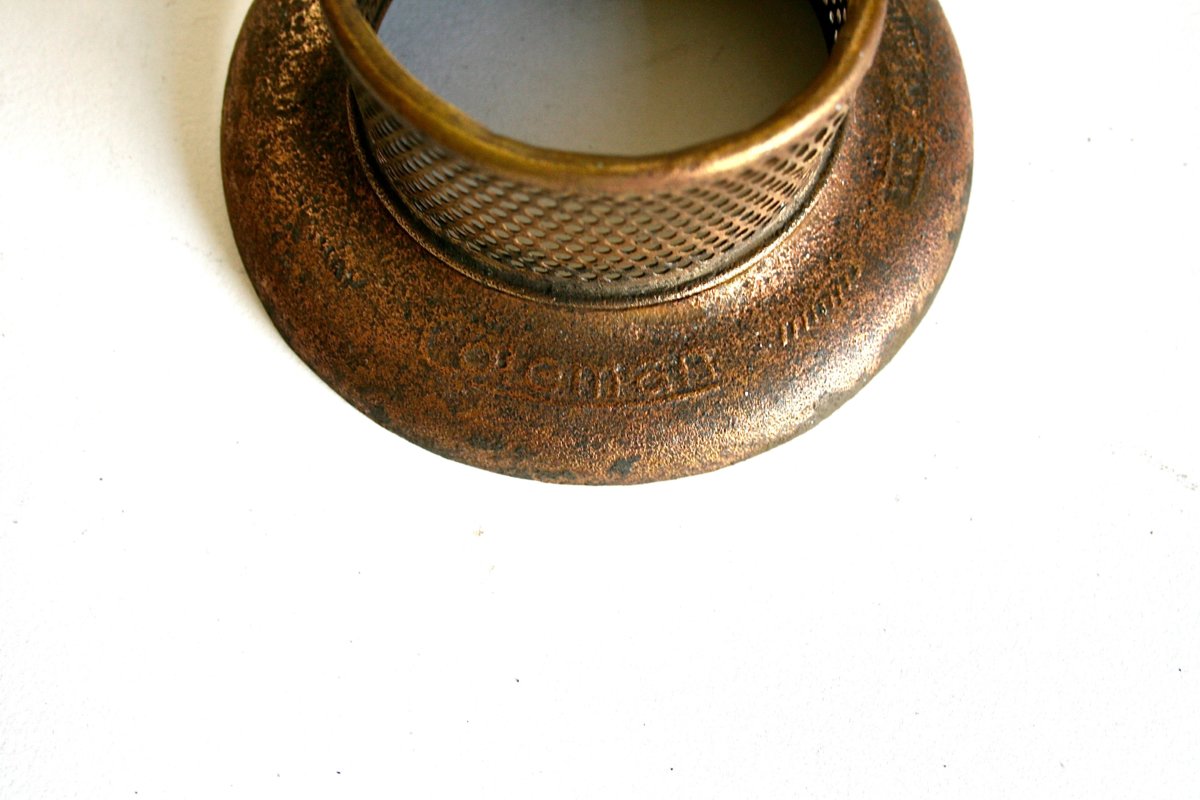

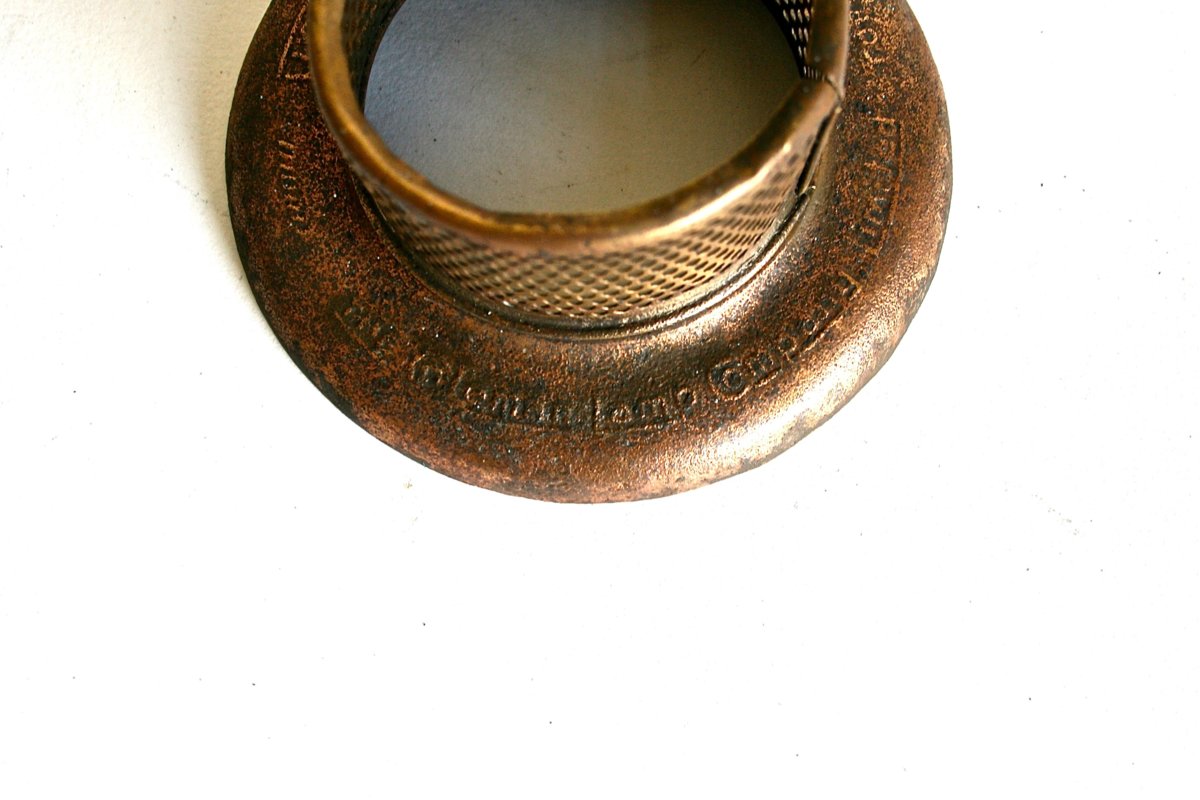

    The hood (vent).
    "Coleman"
    "The Coleman Lamp Company Limited"
    "Toronto Canada"

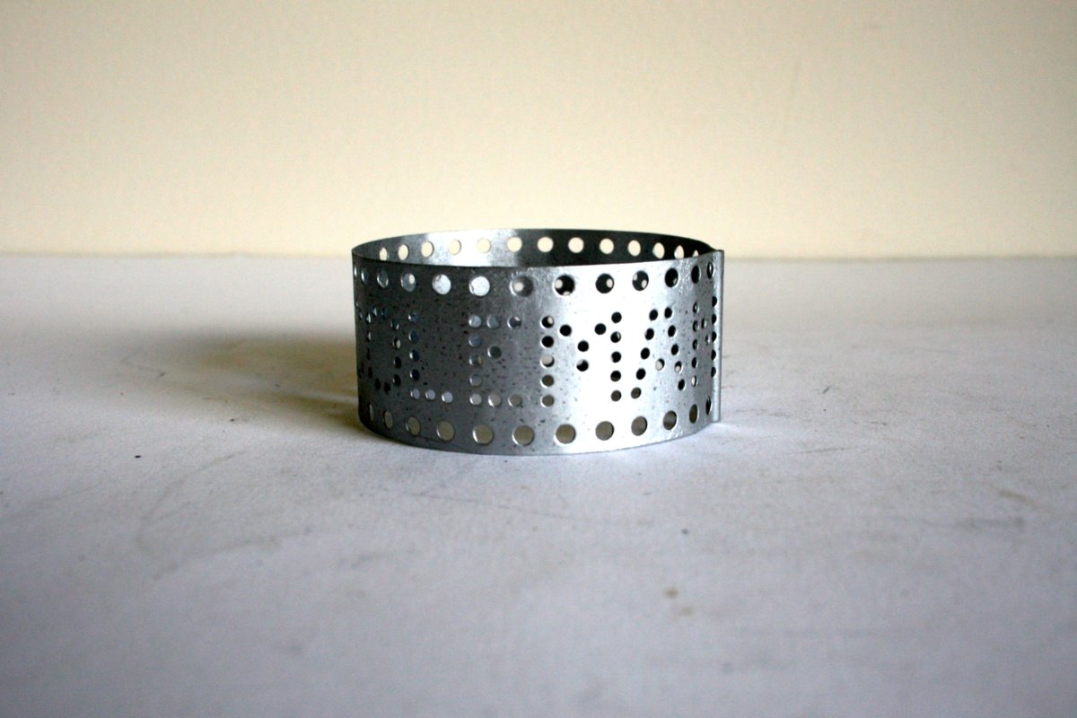

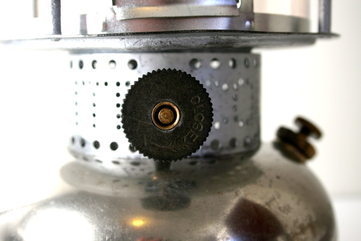

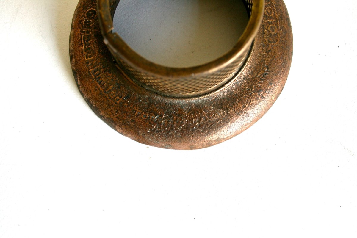

    The collar:
    "Coleman"
    "Quick Lite"

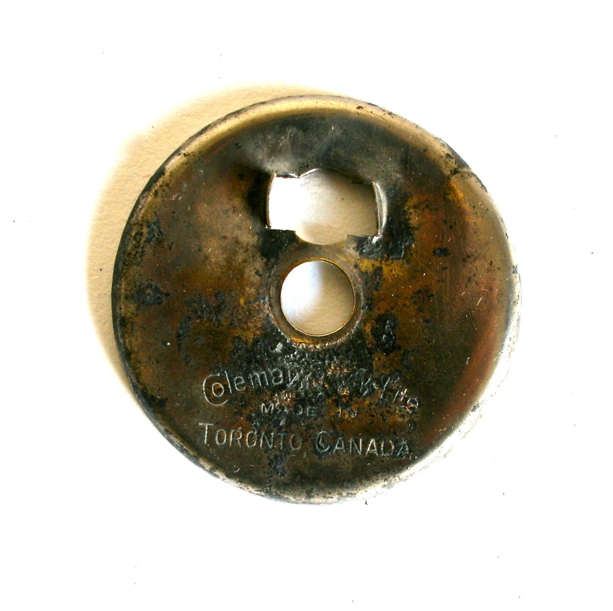

    The centre plate (corroded in parts): "Coleman Quick-Lite Made in Toronto Canada"

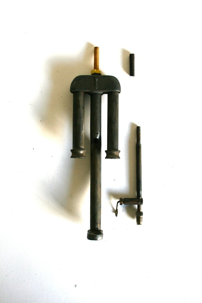

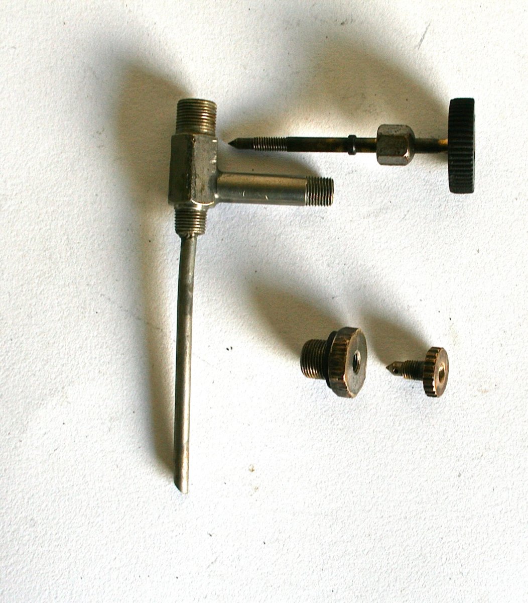

    I replaced the R55 generator that came with the lantern with a Q99. I also replaced the screwed rod for the vent.

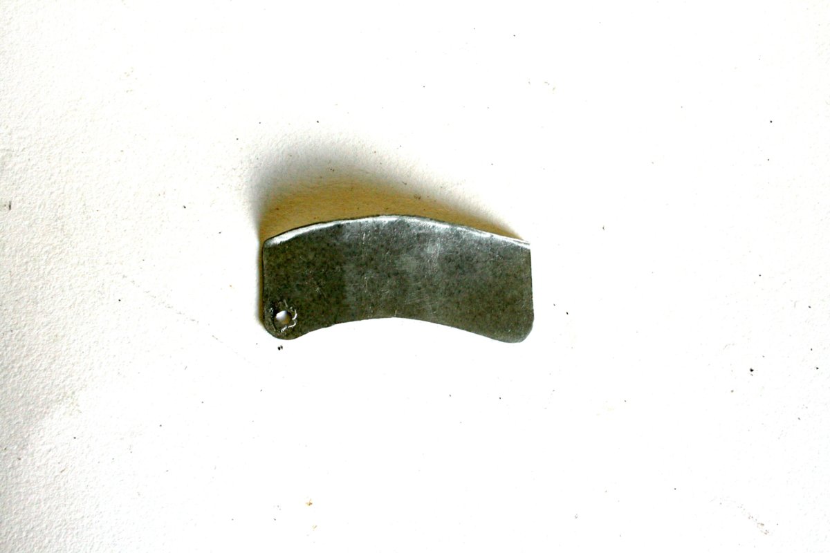

    This plate was fitted the globe cage so that it could close an after-market hole that was cut in the bottom of the cage to allow the lantern to be lit when fitted with a glass chimney (globe).

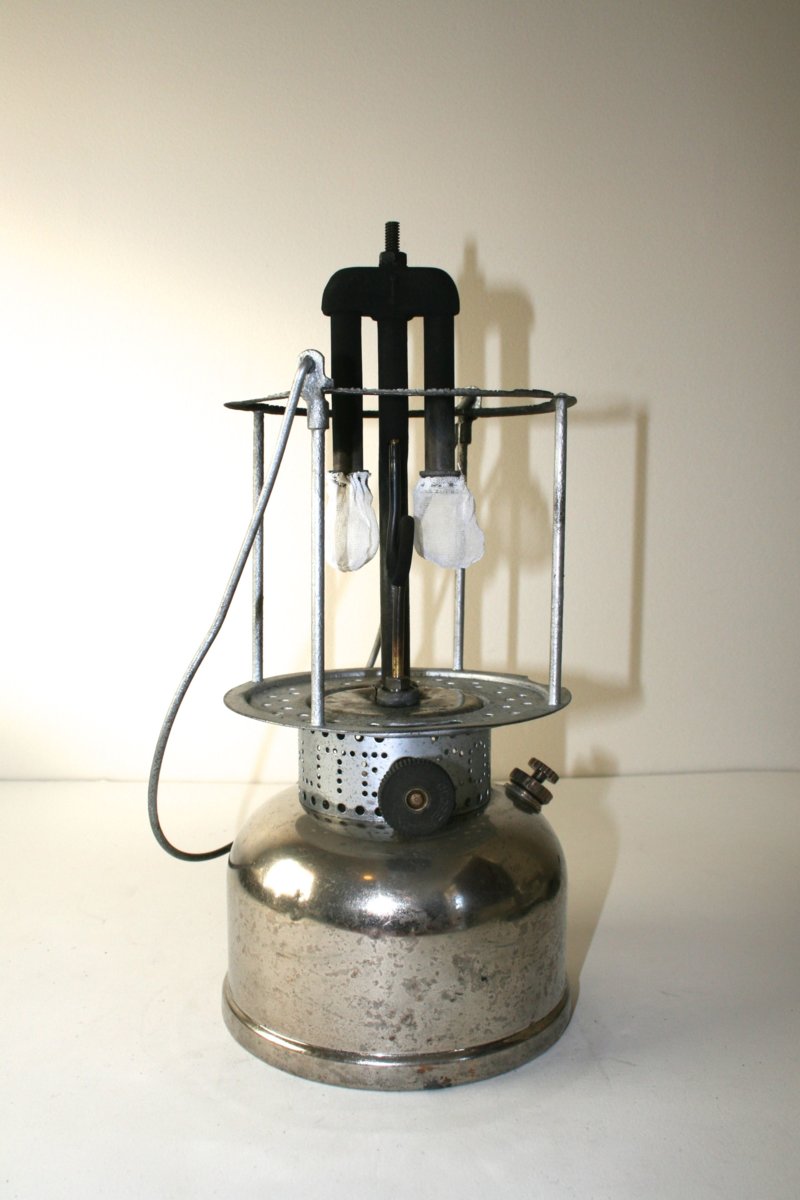

    As it came:
