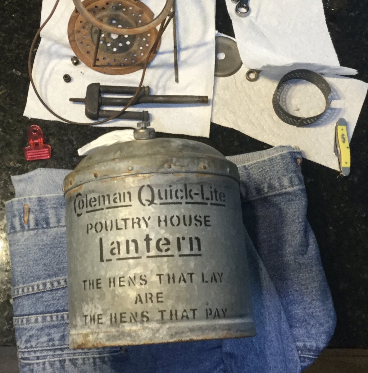

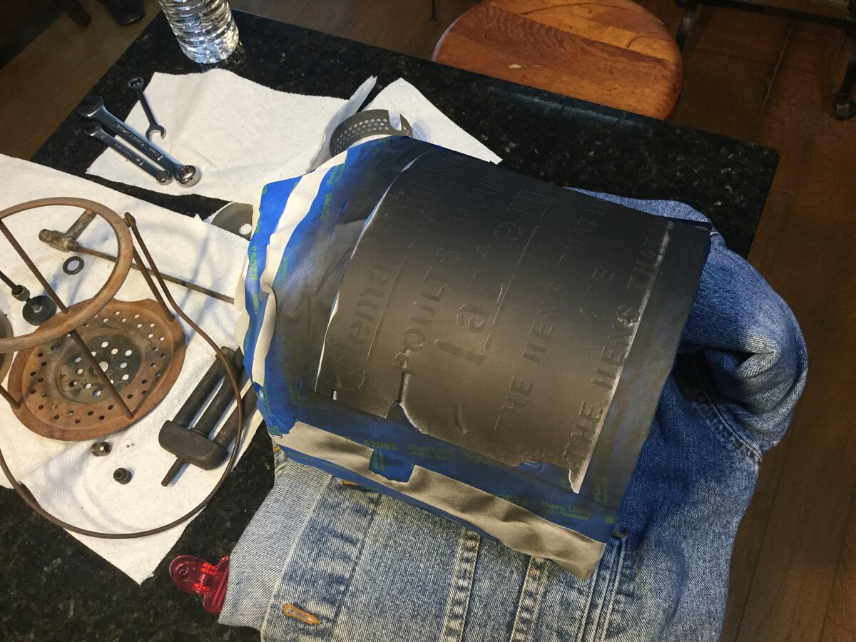

    I was lucky enough to acquire this poultry lantern a few months ago.........Wasn’t interested in a full “restoration” just wanted the the lantern to work properly and I really wanted the “chickens that lay” stencil to be legible.
    I mildly cleaned all components and added a clear Mica globe replacement.
    The stencil was given to me several years ago and I was finally able to use it.
    5D096A80-288D-4DEE-9D16-C9454287911C.jpeg F4478410-ACA5-4237-878B-988977F9937A.jpeg FC7F242F-DB30-4212-A536-FB8A239D6388.jpeg A4BCB530-9C58-4E33-BA95-81307A606686.jpeg

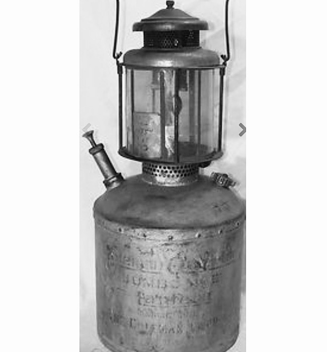

  3. ColinG United Kingdom
    4,816
    I'm intrigued, is the top section above the fuel tank basically from an existing model and if so, which one? Nicely restored by the way.

    @ColinG
    Quick-light lantern with a larger fount

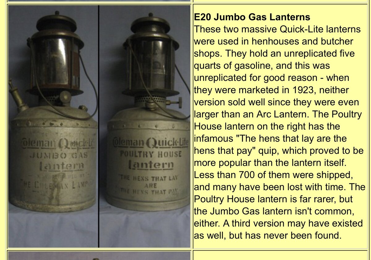

    L327 requiring a separate pump. E20 Poultry House lantern produced 1923-1931. E20 ‘Jumbo’ lantern (marketed as that and not as a ‘Poultry’ lantern) was equipped with an L427 lantern with an integral pump.
    [Courtesy ‘Guide to Vintage Coleman Products’ - International Coleman Collectors Club]

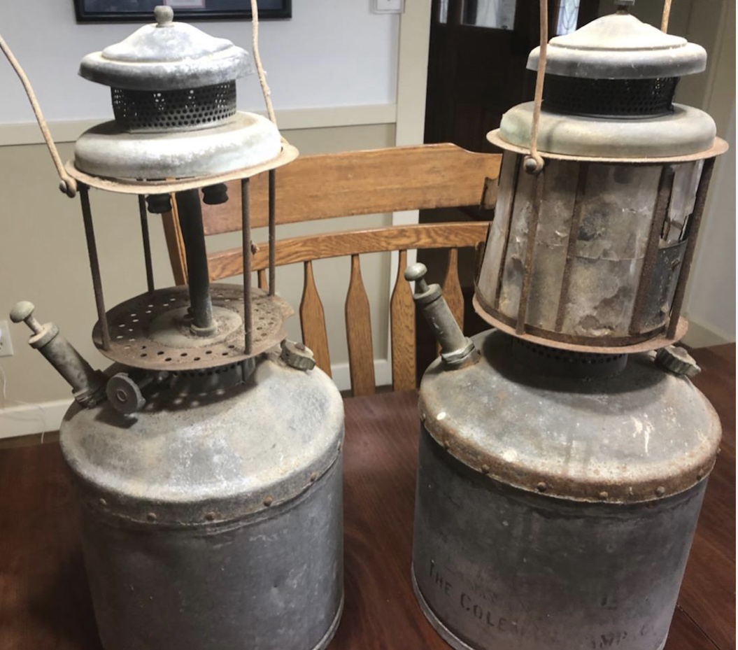

  7. coleman54
    Jul 21, 2020
    272
    Oklahoma, USA
    @Konabill , Very nice example.

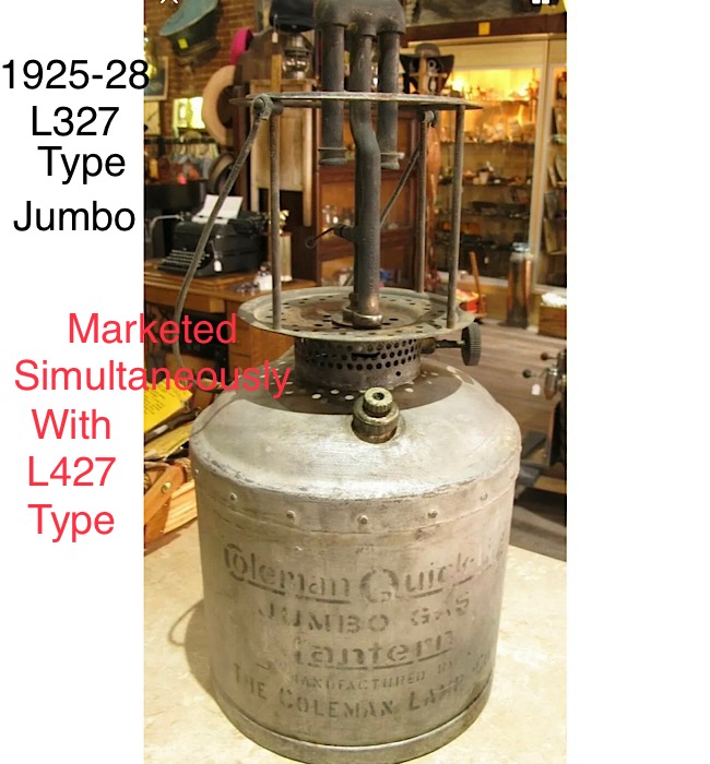

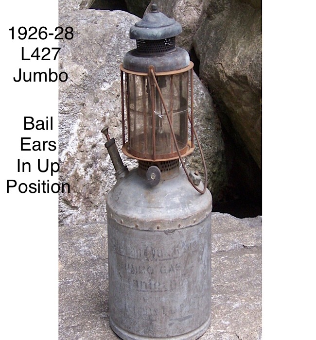

    208 were shipped from October-December 1923.
    @presscall, the Guide is not correct in respect to differentiating between 327/427 by the “Poultry” / “Jumbo” stenciling.
    Coleman catalog, advertising and examples found prove the “Jumbo” was marketed in tandem in both 327/427 versions for a while, the components of these progressed in time like their standard fount lanterns.
    1EE68249-6BCB-4C11-A5B3-54E4E40C6AFD.jpeg 8A5ACD55-B6E2-4FB4-BADA-0D2A7C47A2BB.jpeg

    As I mentioned above, the lantern head component transitions continued through time with the standard,
    Fount pump types also transitioned.
    The “built on” type large “rounded” pump knob from early mid 1925 to the familiar standard lantern “convex” later 1925-on type knob.
    After 1928 catalog information list the built in pump, sadly I have not witnessed an actual example myself yet.
    957BE3C1-7422-48CC-AB69-D760851075A3.jpeg 607F4CE7-16FF-45F1-8CB7-22731C61E4FC.jpeg 57424A37-2223-433E-8B65-F124BB602117.jpeg E312D717-5E4F-4382-9D78-F85B8C532901.jpeg 2C7BEB8A-1BFF-49C6-9757-CE59BA17578D.jpeg

    @coleman54 Again, Larry, my thanks for the information, and for going to the trouble to compile such detail. Fascinating.

  19. coleman54
    Jul 21, 2020
    272
    Oklahoma, USA
    You should keep in mind that when these lanterns were being produced through the 1920s, funnels were without filtering and likely not even a screen wire, so fuel could be added a lot faster than a modern one with felt filter. The Junior lanterns that began in the 1930s, bung and cap were about half the size of these, talk about a pain!
    @Konabill @presscall
